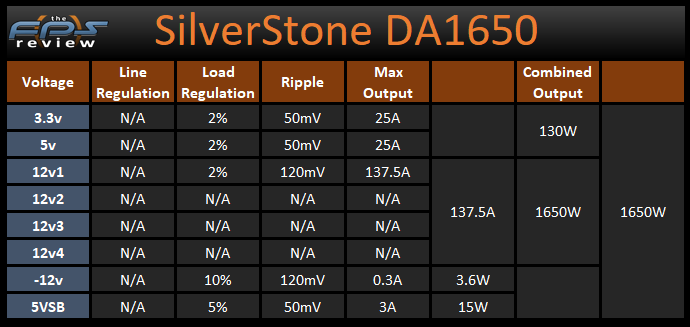

One odd bit we find is that the packaging lists 3% voltage regulation. This is odd because the SilverStone website lists 2%. This is probably a copy-paste kind of error of some sort. For us, it does not matter so much as the load testing later will tell us what the numbers really are, and if they are under 2% then who cares. If not……then we might have questions.

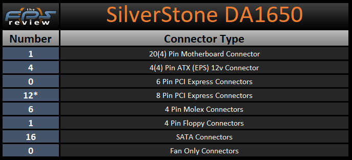

The DA1650 is advertised as being a single 12v rail power supply with a capacity up to 137.5A (or ~100% of the unit’s capacity) if necessary. The minor rails (5v and 3.3v) have a capacity of 25A each and the combined capacity of those two rails is 130W. Combined with these outputs, we find that this unit has 12 PCIe connectors, 16 SATA connectors, and 6 Molex connectors.

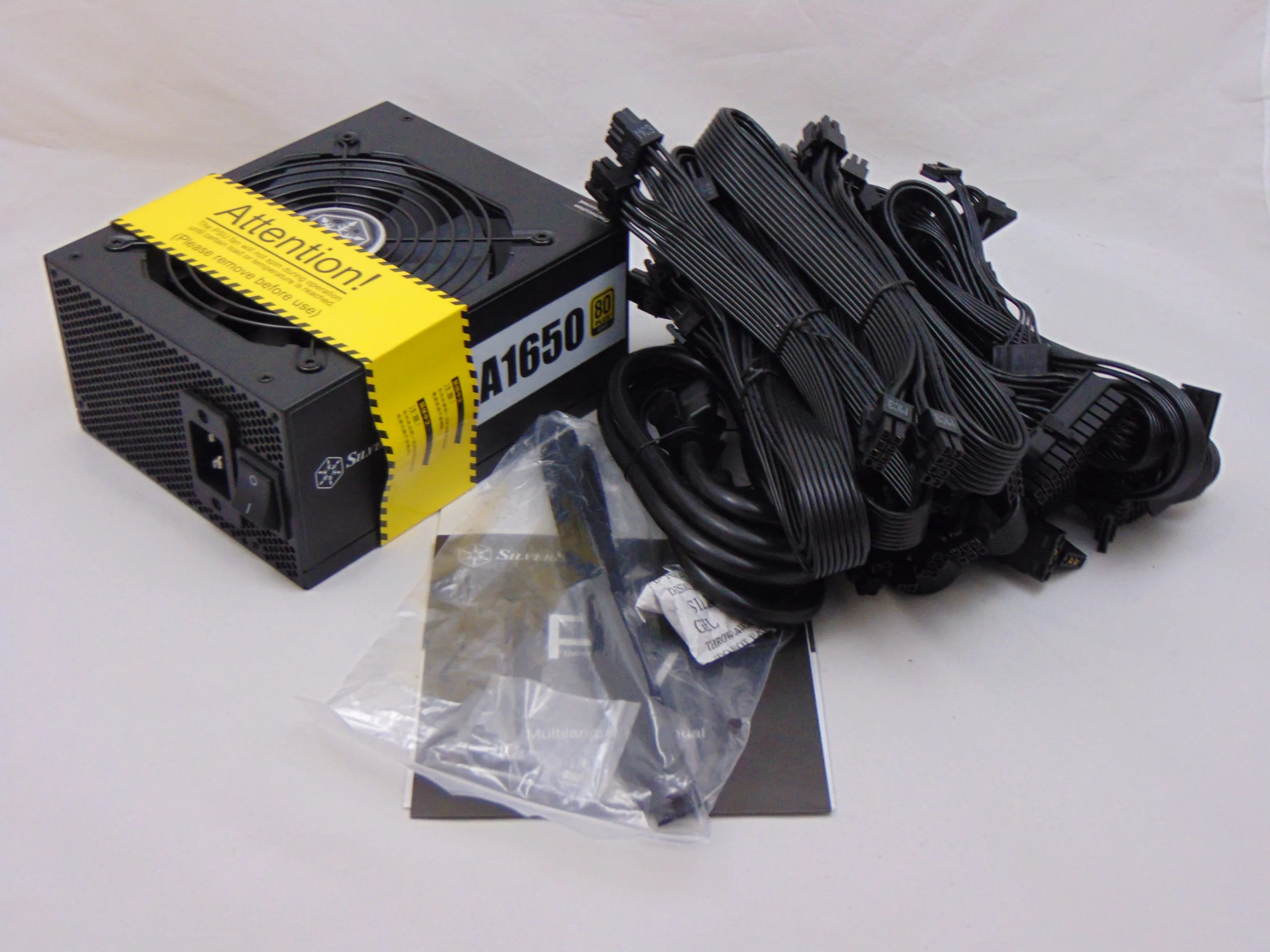

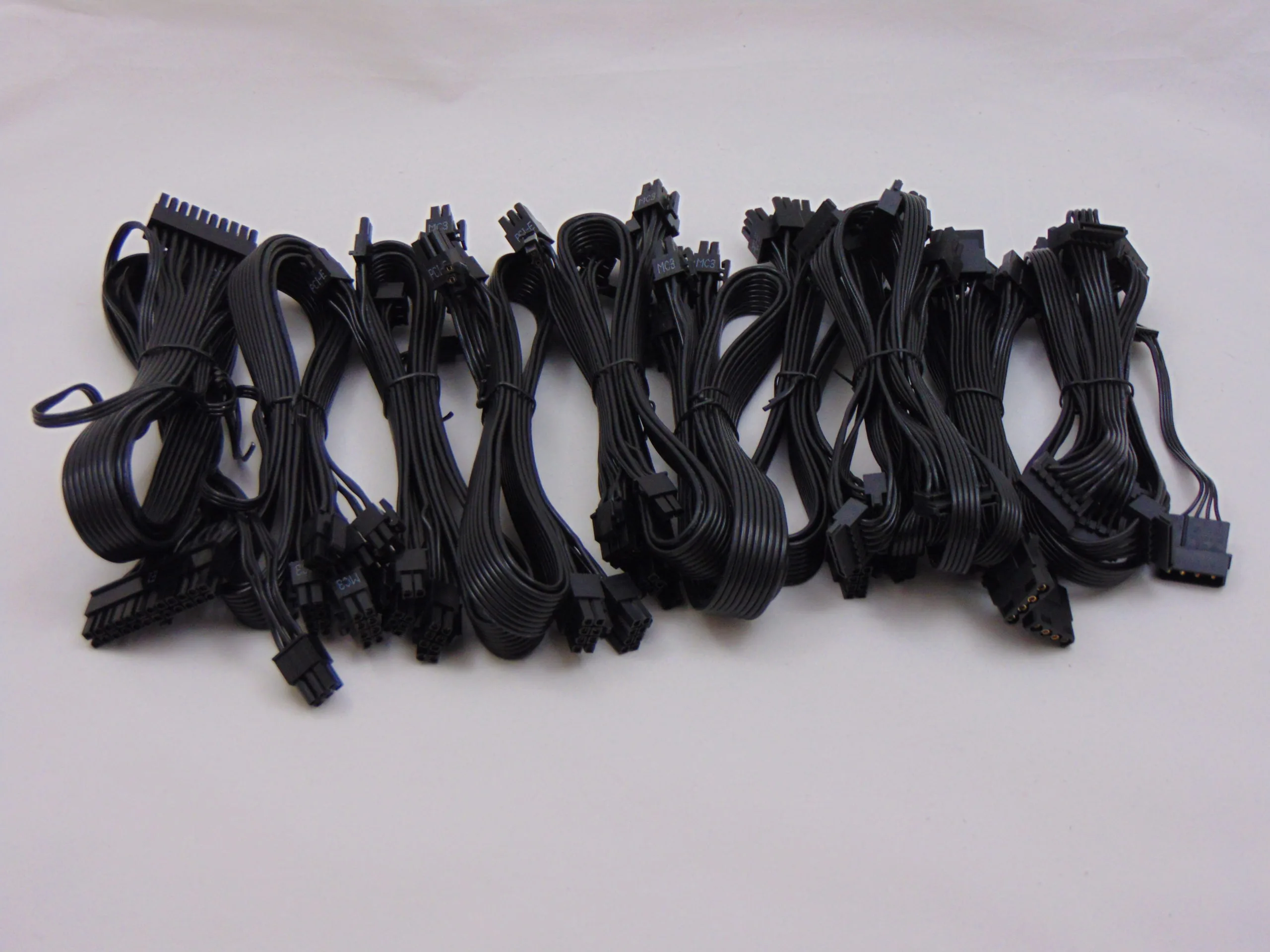

Once we open the SilverStone DA1650 packaging we find the power supply, mounting screws, modular cables, the power cord, and the user manuals. The user manuals are different from previous examples as they are very short. Instead, you are supposed to scan a QR code to get the full versions. Sigh. Let’s move on to the unit itself now.
