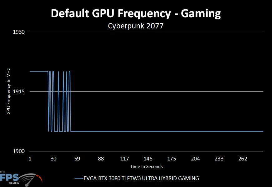

EVGA GeForce RTX 3080 Ti FTW3 ULTRA HYBRID GAMING stock gaming frequency over time
The EVGA GeForce RTX 3080 Ti FTW3 ULTRA HYBRID GAMING settled in around 1905MHz and maintained a temperature of 58.6 degrees Celsius. Compared to the 10GB Founders Edition that averaged 1820MHz, the EVGA GeForce RTX 3080 Ti FTW3 ULTRA HYBRID GAMING declares victory over the Founders Edition by about 85MHz.  Memory in both the 10GB Founders Edition and the EVGA GeForce RTX 3080 Ti FTW3 ULTRA HYBRID GAMING is set to 19GHz using GDDR6X memory.

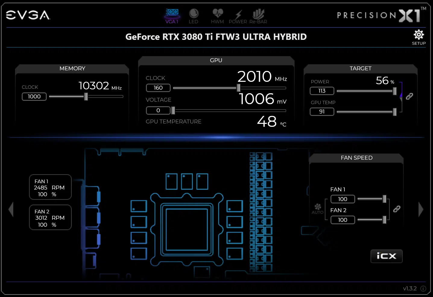

To dial in the maximum overclock for the EVGA GeForce RTX 3080 Ti FTW3 ULTRA HYBRID GAMING, we used EVGA’s Precision X1 software that makes lots of knobs to turn and levers to pull available for tuning enjoyment.
EVGA GeForce RTX 3080 Ti FTW3 ULTRA HYBRID GAMING precision x overclocking configuration

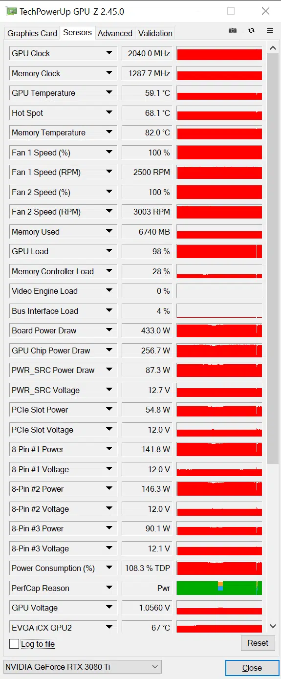

EVGA GeForce RTX 3080 Ti FTW3 ULTRA HYBRID GAMING overclocked sensor data
We started by maxing out the Power Target at 113% and boosted the GPU Temp Target up from 83C to 91C. We then cranked the fans up to 100% (which only appeared to control the 120mm fans and not the slot fan on the card). We did play with the voltage knob during our testing, but it did not seem to make a meaningful impact on performance or stability, therefore, given the low power budgets on the RTX 30 Series that we have seen so far, adding voltage has not been necessary as it only increases power consumption and reduces how far GPU Boost will push the core clock speed up.
With the power matters settled, we started by pushing the core clock up as high as it could go without touching the memory side of the equation. We were able to pick up an extra 160 MHz on the slider offset before we started crashing.
Next up, we set the core back to stock and boosted the memory to see how far we could take it. It appeared to be happiest at +1000MHz (2000MHz effective). This is a boost to 21GHz GDDR 6X over the stock of 19GHz GDDR6X.
Putting it all together, we first tried our max individual clocks together to see how it worked. This gave us a final stable overclock of 1525MHz core clock, 1960MHz boost clock, and 21GHz memory clock.

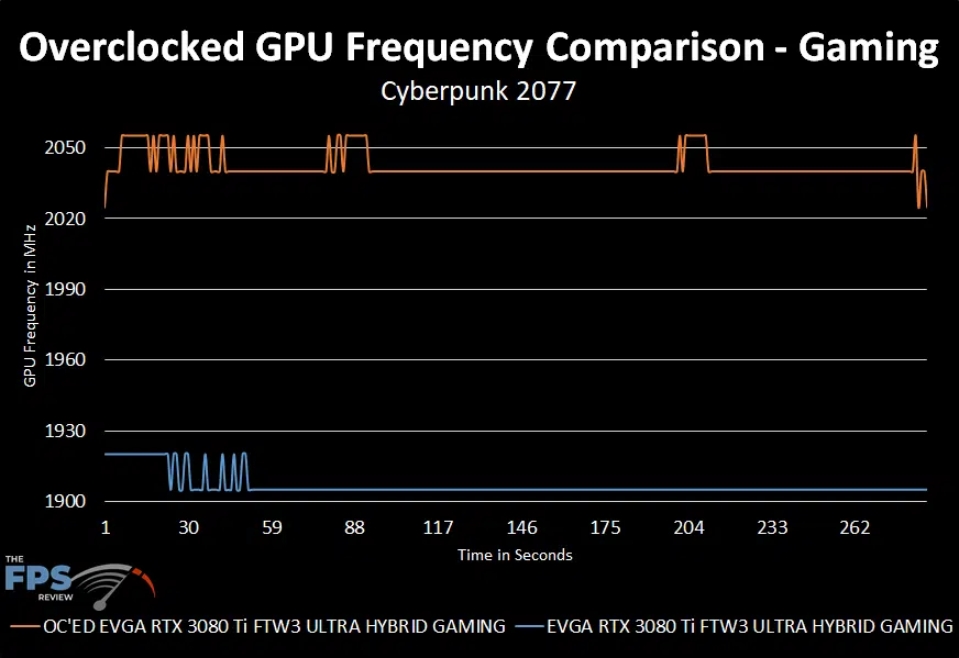

EVGA GeForce RTX 3080 Ti FTW3 ULTRA HYBRID GAMING overclocked gpu frequency over time
Comparing the sustained GPU frequency to the stock frequency, we see that the observed overclocked frequency averaged out to 2040MHz. This is a 7% increase over the stock clocks and a 12% boost over the stock Founders Edition performance. The memory at 21GHz is 10.5% faster than the stock clock as well.
