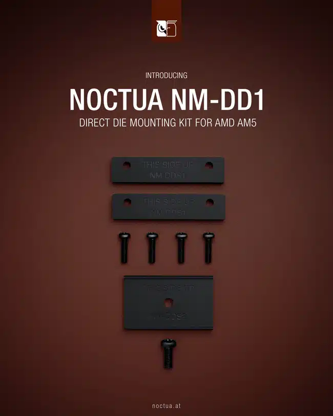

Noctua has announced that the NM-DD1, a direct die kit for delidded AMD AM5 processors, is now available to order exclusively via Noctua’s website for a service charge of EUR 4.90. Customers also have the option of 3D-printing the spacers contained in the NM-DD1 kit at home using STL files that can be found at Printables.com. “(NM-DDS1 spacers for coolers with two-piece fastening brackets and 83mm mounting-pitch, NM-DDS2 spacers for coolers with a single-piece fastening bracket and 78mm mounting pitch). Installing the fastening bracket(s) with the printed spacers will require four M3x12 screws (for NM-DDS1) or a single M4x10 screw (for NM-DDS2).”

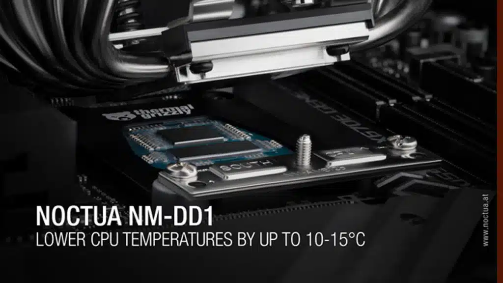

- Noctua introduced its new NM-DD1 direct die kit, developed in cooperation with professional overclocker and direct die cooling expert Roman “der8auer” Hartung.
- The NM-DD1 is a mounting spacer kit that makes it possible to use a wide range of Noctua CPU coolers on delidded AMD AM5 processors.
- Removing the processor’s integrated heat spreader (delidding) and putting the heatsink directly onto the dies allows for much more efficient thermal transfer and can lower CPU temperatures significantly, with typical gains in the range of 10-15°C.

Noctua today introduced its new NM-DD1 direct die kit. Developed in cooperation with professional overclocker and direct die cooling expert Roman “der8auer” Hartung, the NM-DD1 is a mounting spacer kit that makes it possible to use a wide range of Noctua CPU coolers on delidded AMD AM5 processors. Removing the processor’s integrated heat spreader (delidding) and putting the heatsink directly onto the dies allows for much more efficient thermal transfer and can thereby lower CPU temperatures significantly, with typical gains in the range of 10-15°C.
Removing the CPU’s integrated heat spreader (delidding) and putting the heatsink directly onto the dies using liquid metal thermal compound significantly improves thermal transfer and can typically reduce CPU temperatures by as much as 10-15°C. This increased thermal headroom can either be used to drastically reduce fan speeds and noise levels or, if the CPU allows, to achieve higher turbo boost frequencies.

The NM-DD1 contains spacers that are put underneath the heatsink’s fastening bracket(s) in order to make up for the height of the removed heat spreader as well as custom, longer screws that make it possible to reinstall the fastening brackets with the spacers in place. All other parts that are required for delidding and direct die cooling (delidding tool, direct die frame for protecting the CPU, liquid metal thermal compound) must be purchased separately.
