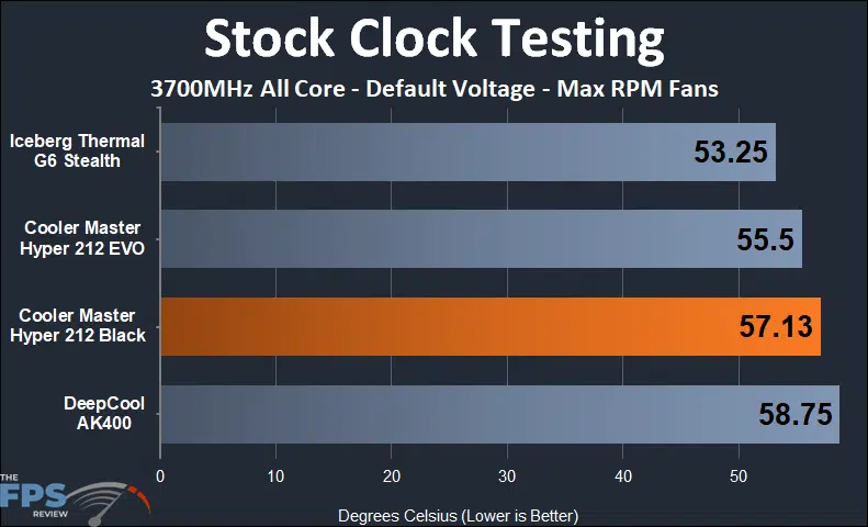

Cooler Master Hyper 212 Black max rpm fan stock clock testing
We started our testing today by turning the fans up all the way to 11. This brought the Cooler Master Hyper 212 Black to 57.13 degrees Celsius while the older Hyper 212 EVO landed a 55.5 degree Celsius temperature. The DeepCool AK400 brought up the rear at 58.75 degrees Celsius. The larger and more expensive G6 Stealth took the overall performance crown.
We noted that the max fan speed on the Cooler Master Hyper 212 Black topped out at 2300 RPM, the Cooler Master Hyper 212 EVO RPM, the DeepCool AK400 topped out at 1850 RPM, and the Iceberg Thermal G6 Stealth has the lowest max fan rpm at 1450 RPM.

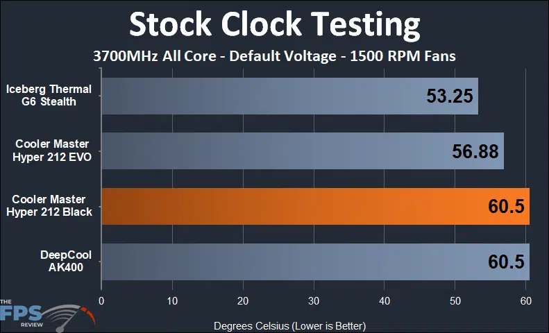

Cooler Master Hyper 212 Black 1500 rpm fan stock clock testing
Dropping the fans slightly to 1,500 RPM shifted the playing field a bit with the Hyper 212 Black and DeepCool AK400 tying at 60.5 degrees Celsius. They were led by the G6 Stealth and Hyper 212 EVO at 53.25 and 56.88 degrees Celsius respectively. Of note, the G6 Stealth is operating at its maximum of 1450 RPM for this test.

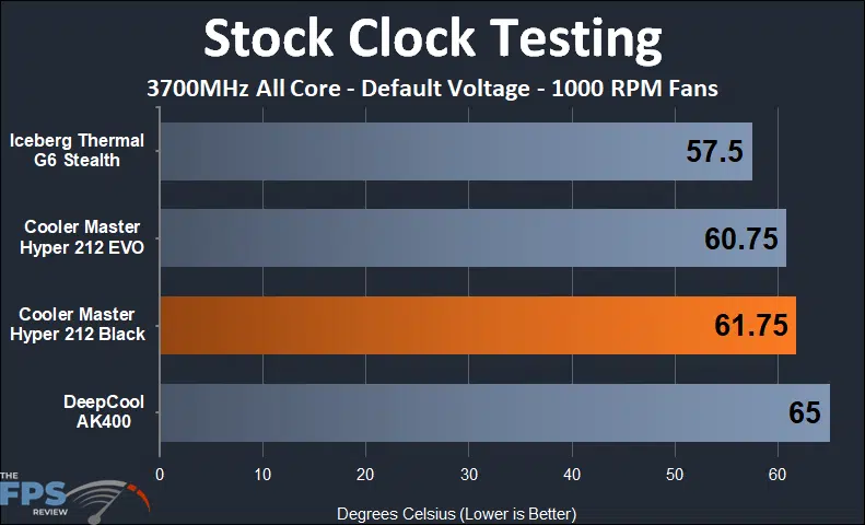

Cooler Master Hyper 212 Black 1000 rpm fan stock clock testing
Lowering the fan’s RPM further to 1,000 RPM sees the placement shuffle a bit with the Hyper 212 Black at 61.75 degrees Celsius, just a single degree behind the Hyper 212 EVO. The DeepCool AK400 brought up the rear at 65 degrees Celsius. The G6 Stealth’s hold on the lead got a bit slimmer at the lower fan speeds but was still at 57.5 degrees Celsius. Of note here, the Hyper 212 Black is operating at 1100 RPM, which is the lowest speed we could get configured on our PWM motherboard.

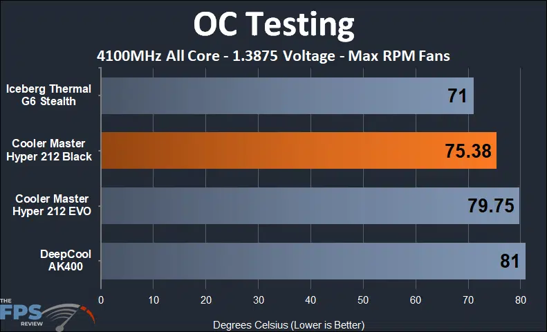

Cooler Master Hyper 212 Black max rpm fan overclocked testing
Running our HSFs at full tilt leads to the Cooler Master Hyper 212 Black posting a temperature of 75.38 which is significantly cooler than both the Hyper 212 EVO and AK400 which were at 79.75 and 81 degrees Celsius respectively. The G6 maintains the lead as expected at 71 degrees Celsius as it has more heat pipes and more fan capacity.

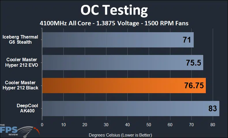

Cooler Master Hyper 212 Black 1500 rpm fan overclocked testing
At the 1500 RPM fan speed, the Hyper 212 Black delivered a temperature of 76.75 degrees Celsius which was 1.25 degrees above the Hyper 212 EVO and 5.75 degrees above the G6 Stealth. It also beat out the AK400 which was at 83 degrees Celsius.
