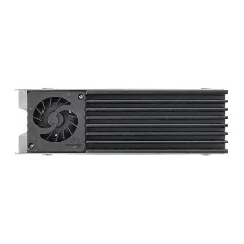

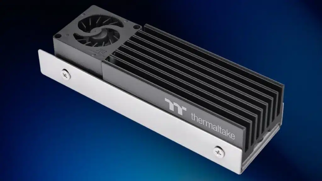

The Thermaltake MS-1 M.2 2280 SSD cooler is designed to keep some of the fastest Gen5 drives cool while performing high-speed data transfers. With its 8000 rpm/16 dB-A micro-blower fan, it is capable of quietly pushing 0.44 CFM of air through the aluminum heatsink with a static pressure of 1.6 mm. The 8-fin heatsink features a direct contact aluminum Ø6 mm heatpipe for optimal heat transfer.
The Thermaltake MS-1 M.2 2280 SSD cooler has been tested and shown to maintain read/write speeds of up to 12K/11K respectively, and engineered for constant speeds of up to 10K while maintaining up to 4°C lower temperatures than similar coolers and up to 7° C lower temperatures versus a pre-installed heatsink. Thermaltake has not yet revealed pricing and availability for the MS-1.

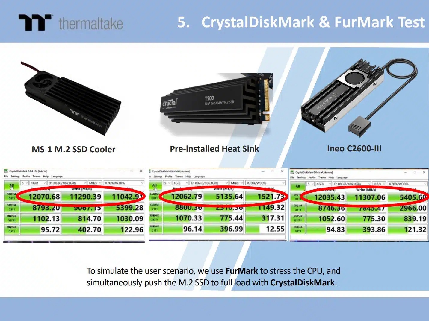

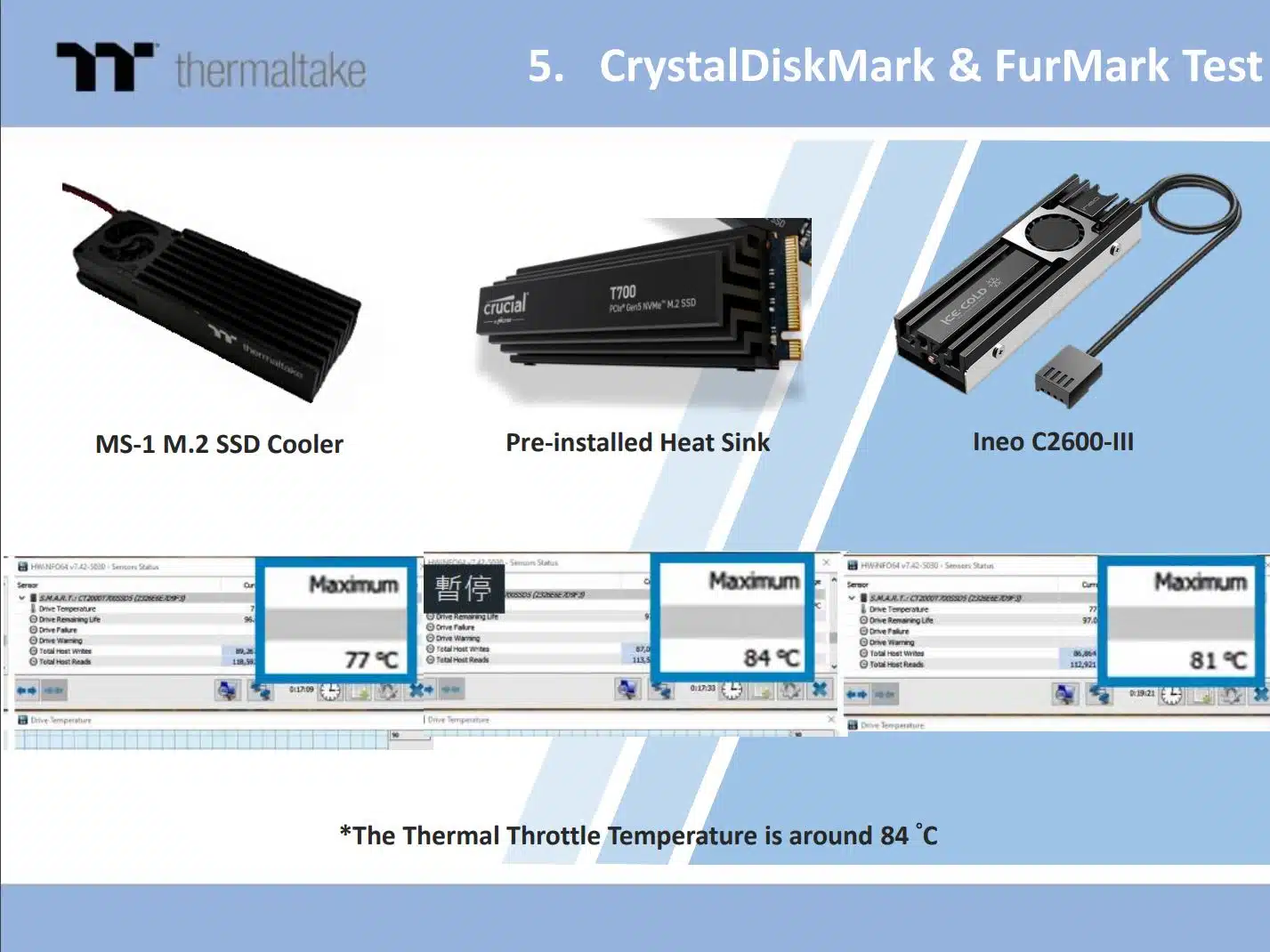

Per Thermal Testing Datasheet:
“During our test, the Crucial T700 PCIe Gen5 NVMe 2TB SSD activated thermal throttling when the core temperature reaches beyond 84°C, resulting in a significant drop in performance.
On the other hand, while pairing the SSD with MS-1 M.2 SSD Cooler, the highest temperature was 81°C, and the clock speed stayed above a healthy 10K MB/s, especially in writing and mixed writing & reading respectively.
In conclusion, the MS-1 M.2 Cooler can effectively dispense the heat and keep the clock speed running above 10K MB/s, boosting the performance by nearly 119% and 625%, write and mix writing & reading respectively.”

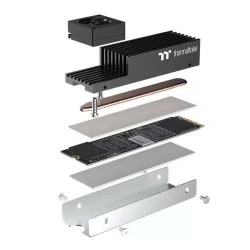

Specifications (per product page):
| P/N | CL-O043-AL02BL-A |
| COMPATIBILITY | M.2 SSD – 2280 |
| DIMENSIONS | 14 x 22 x 70 mm ( H x W x L) |
| HEATSINK MATERIAL | Aluminum Fins Copper Heatpipes |
| HEATPIPE | Φ6mm x 1 pcs |
| FAN DIMENSION | 20 x 20 x 8.6 mm ( L x W x H) |
| FAN QUANTITY | 1pcs |
| FAN SPEED | 8000 RPM |
| RATED VOLTAGE | 12V |
| START VOLTAGE | 10 V |
| RATED CURRENT | 0.035 A |
| POWER INPUT | 0.42 W |
| AIR FLOW | 0.44 CFM |
| STATIC PRESSURE | 1.6 mm-H2O |
| NOISE LEVEL | 16 dBA |
| AIRFLOW | 60,000 hours |
| PIN CONNECT | 2510 – 3Pin |
