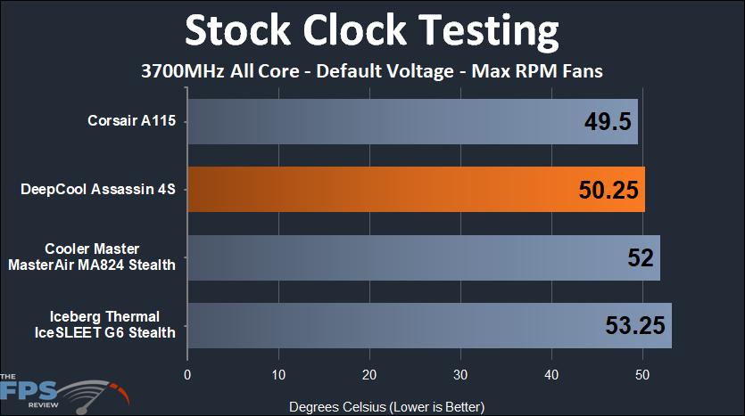

Max Fan
DeepCool Assassin 4S max RPM stock clock thermal testing results
We started our testing today by turning the fans up all the way to 11 and setting the course for our stock configuration. This brought the Assassin 4S to 50.25 degrees Celsius which surpassed the MasterAir MA824’s 52 degrees and the IceSLEET G6 Stealth’s 53.25 degrees but trailed the CORSAIR A115’s 49.5 degree result.
Note that the max fan speed on the Assassin 4S reached 1850 RPM while the CORSAIR A115 topped out at 1600 RPM, the MasterAir 824 topped out at 1900/1550 RPM and the IceSLEET G6 Stealth topped out at 1450 RPM.

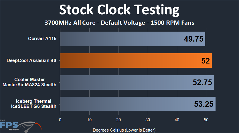

1500 RPM Fan
DeepCool Assassin 4S 1500 RPM stock clock thermal testing results
Dropping the fans to 1,500 RPM leveled out the playing field with the Assassin 4S turning in a 52-degree Celisus result that was ahead of the MasterAir MA824’s 52.75 and IceSLEET G6 Stealth’s 53.25 degrees Celsius. The Corsair A115 retained the lead at 49.75 degrees.

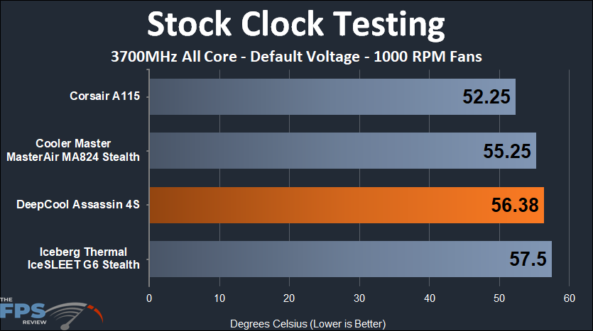

1000 RPM Fan
DeepCool Assassin 4S 1000 RPM stock clock thermal testing results
Lowering the fan’s RPM further to 1,000 RPM sees the two fan examples in this test start to pull away from the single fan examples. The Assassin 4S took a step down the rankings at 56.38 degrees Celsius which only knifed the IceSLEET G6 Stealth’s 57.5 degree result. The CORSAIR A115 and MasterAir MA824 took the lead at 52.25 and 55.25 degrees Celsius respectively.

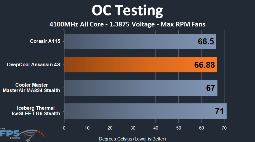

Max Fans
DeepCool Assassin 4S max RPM overclocked thermal testing results
Now it’s time to boost our platform to its overclocked settings and get the fans back to 11 or so. Starting off, the Assassin 4S’s 66.88 degrees Celsius result is very competitive with the CORSAIR A115 at 66.5 degrees Celsius and the MasterAir 824 at 67 degrees Celsius. Bring up the rear is the IceSLEET G6 Stealth at 71 degrees.

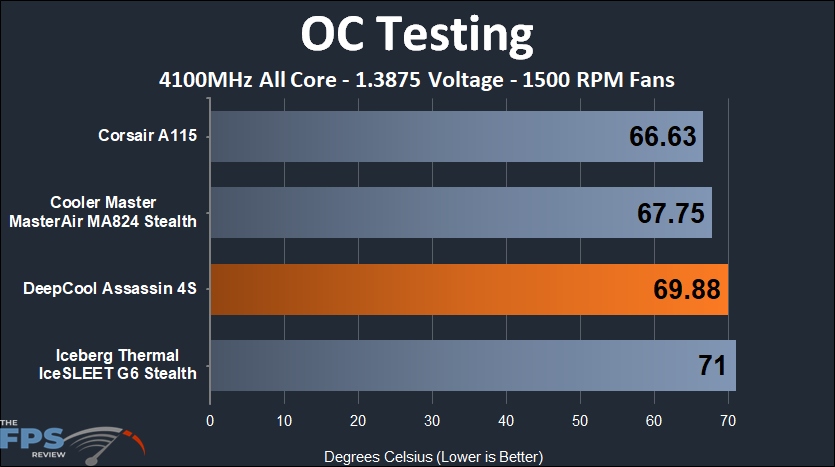

1500 RPM Fans
At the 1500 RPM fan speed, the be quiet! Dark Rock Pro 4 leads all challengers at 78 degrees Celsius while the Cooler Master Hyper 212 EVO posted a value of 79.75 degrees Celsius. The DeepCool IceSLEET X7 Dual was right on the Hyper 212 EVO’s heels at 79.88 degrees Celsius. Then, strangely, we see the IceSLEET X5 at 82.88 degrees Celsius while the IceSLEET X6 was watching everyone from the rear at 83.25 degrees Celsius.
DeepCool Assassin 4S 1500 RPM overclocked thermal testing results
At the 1500 RPM fan speed, the single fan coolers dropped back a bit with the Assassin 4S chalking up a 69.88 degree Celsius result. The CORSAIR A115 maintained its lead at 66.63 degrees compared to the MasterAir MA824’s 67.75-degree result. The IceSLEET G6 Stealth remained at 71 degrees Celsius temperature as it was still running at maximum fan speeds. Now that we have seen how all of our units cool, let’s see if we can still hear!
