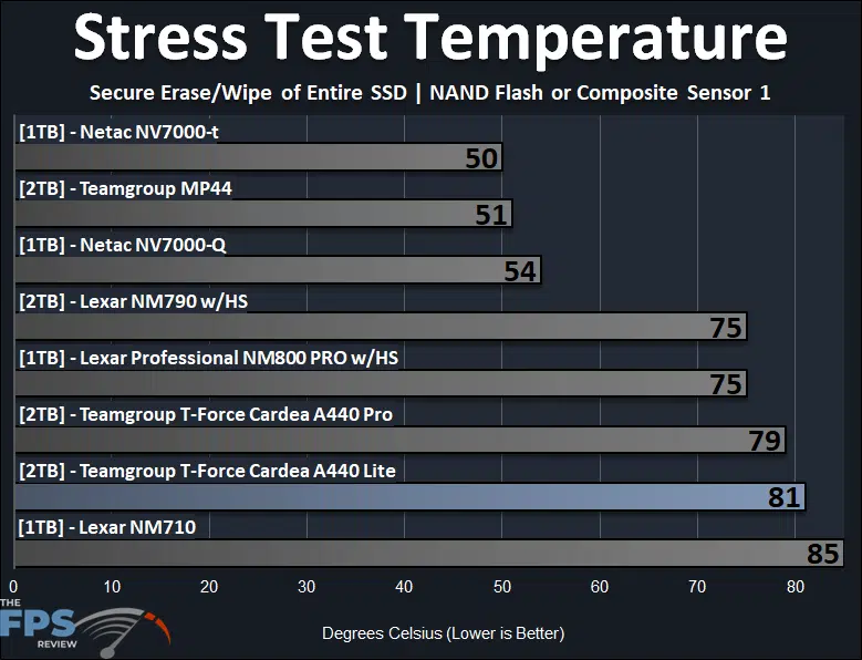

The TEAMGROUP T-FORCE CARDEA A440 Lite 2TB SSD is running simply with the graphene heat spreader installed, no other M.2 motherboard heatsinks are present, and no fans creating airflow, so this is a worst-case scenario of temperature. In the first graph, the NAND flash or composite sensor 1 detected 81c, which was a couple of degrees hotter than the A440 Pro (which also was only using the graphene heat spreader, no heatsink).

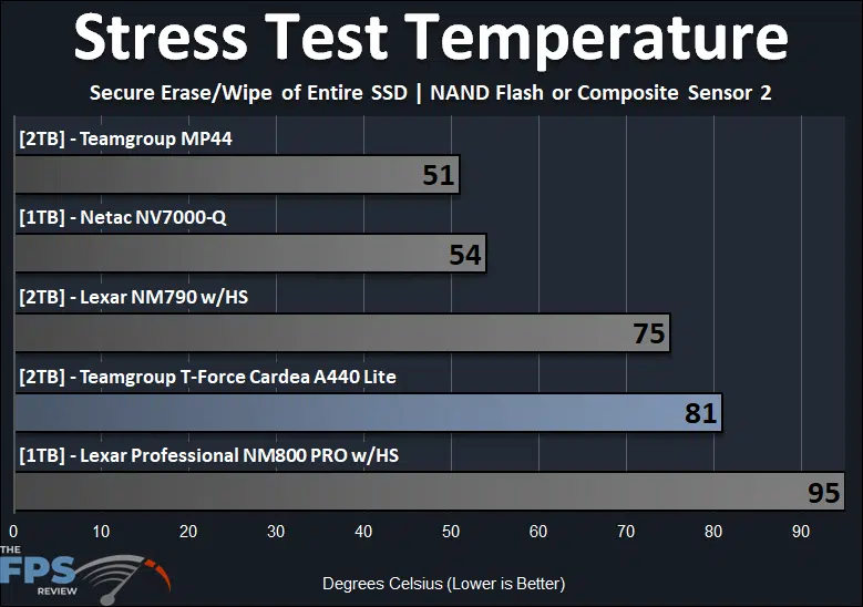

In the NAND flash or composite sensor 2, we also saw 81c, which puts it into the hot category (the A440 Pro doesn’t have this particular sensor). Our conclusion on temperature is that you should run an M.2 heatsink, either one provided by your motherboard or a third party. If this is being used in a laptop or notebook, it could possibly thermal throttle in the most intense use cases or constant write workloads, especially if your laptop has poor cooling.

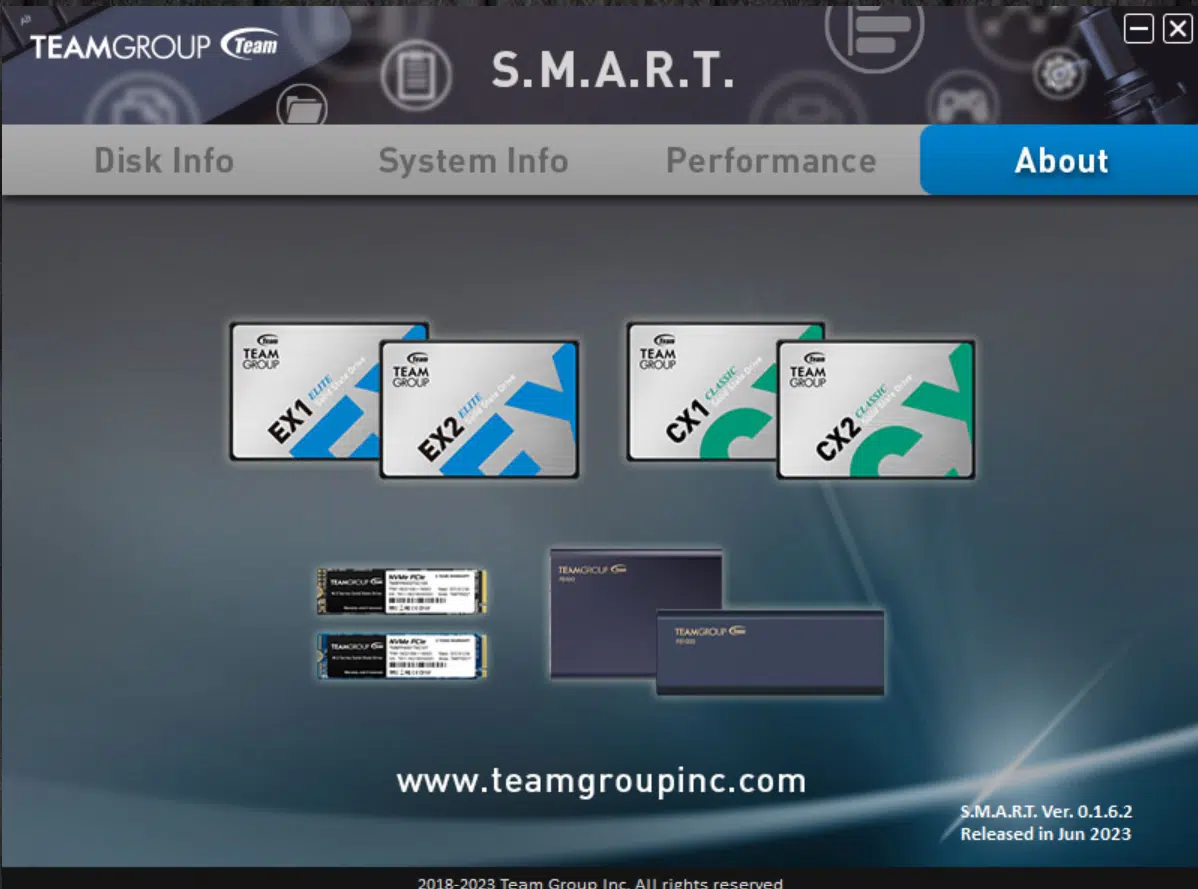

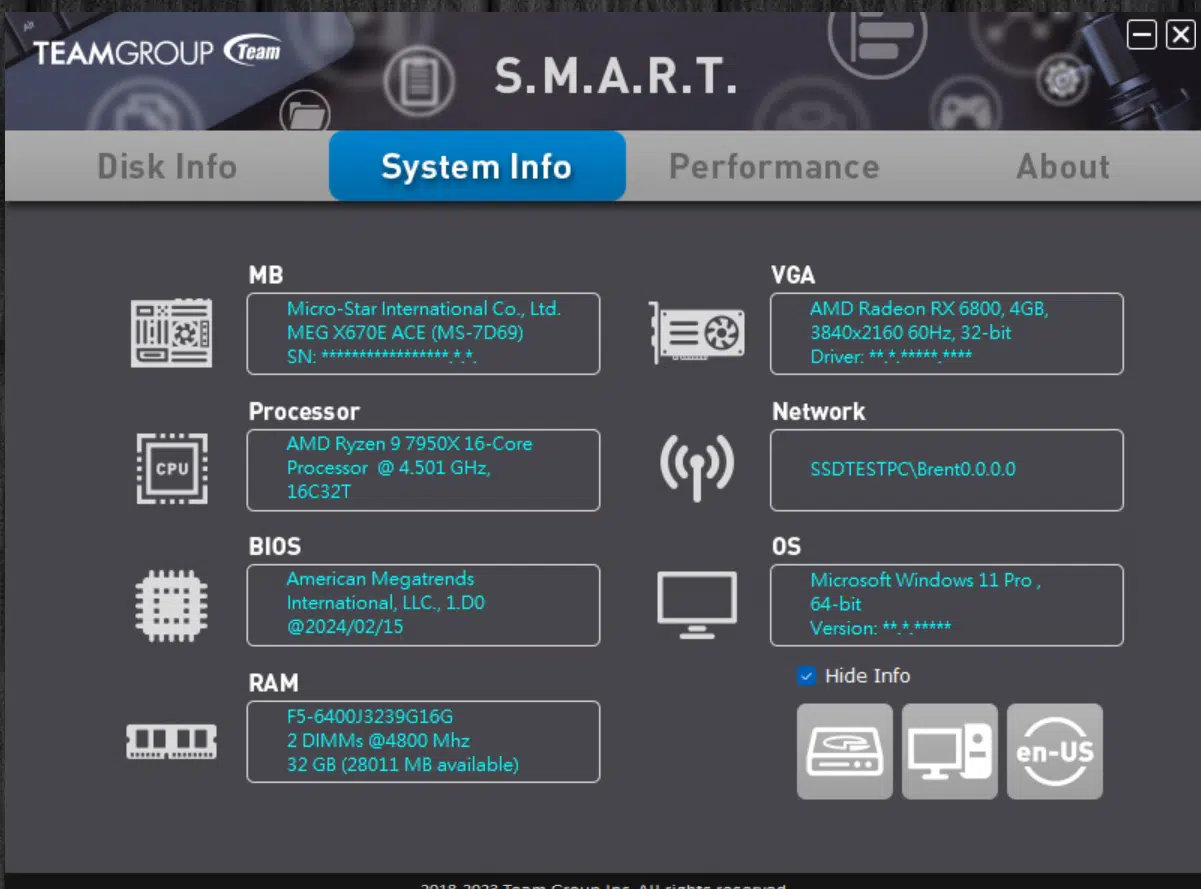

SSD S.M.A.R.T. Tool

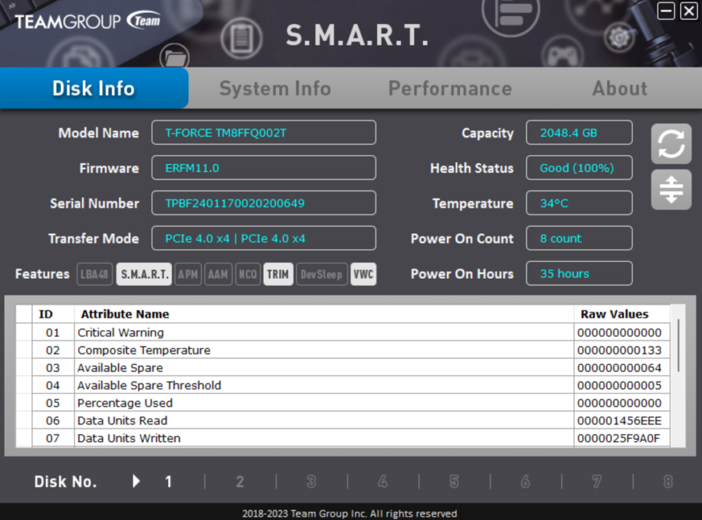

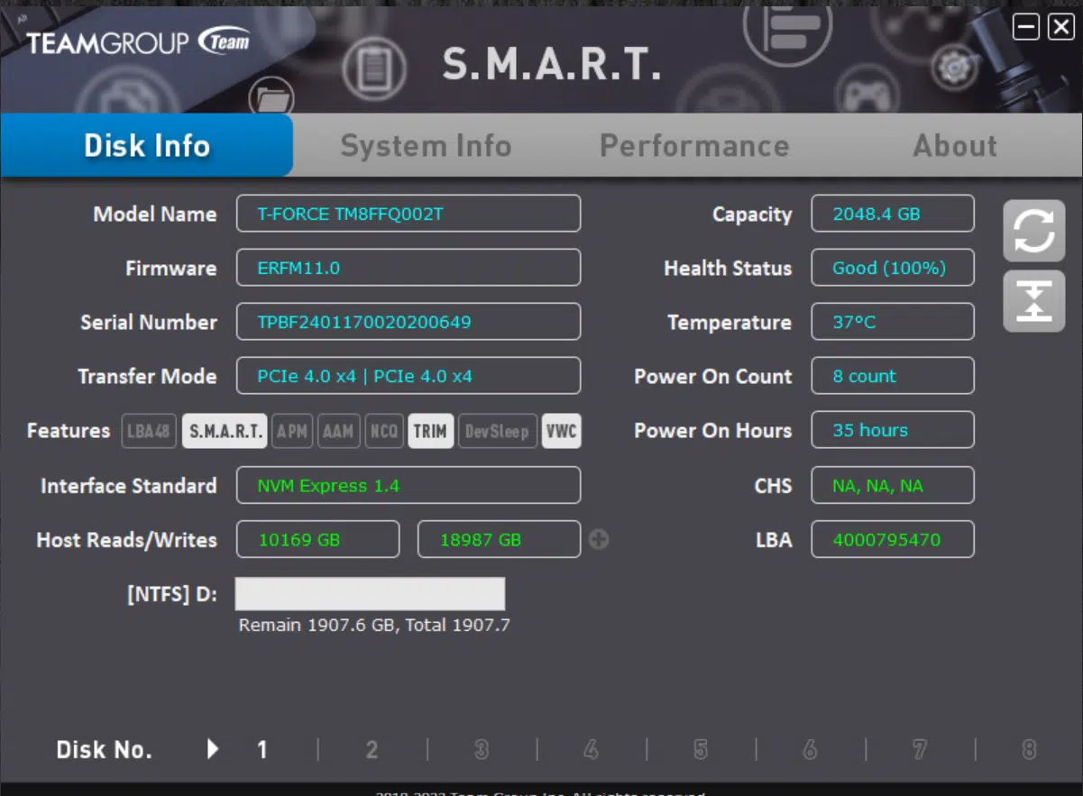

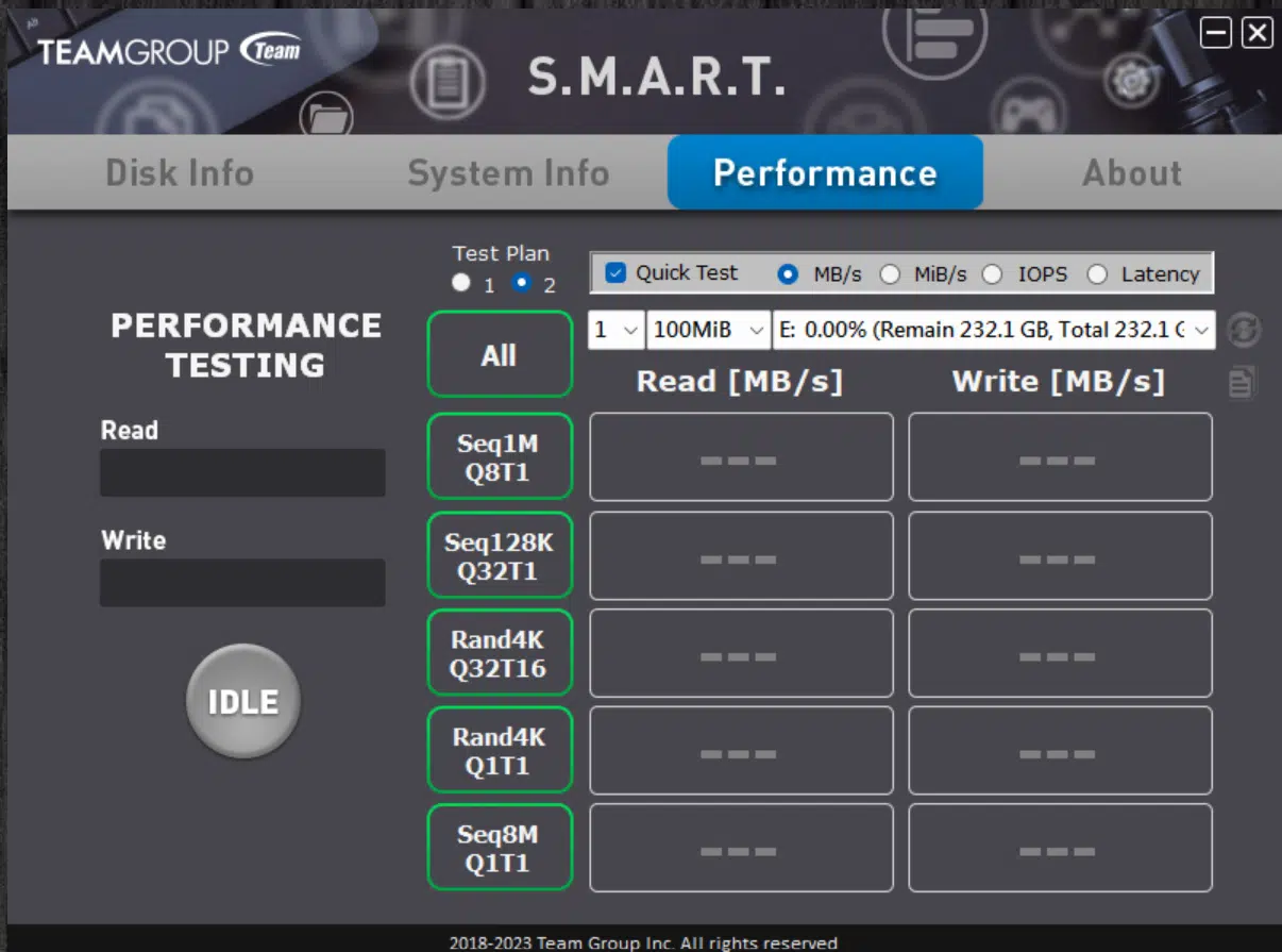

TEAMGROUP has its SSD S.M.A.R.T. Tool available for download. The software allows you to view the S.M.A.R.T. data and provides health and temperature information on the drive, as well as a benchmark and some device info. However, it does not have a firmware update checker or ability, which would be a great addition we’d like to see. The software has not been updated in a long while.
