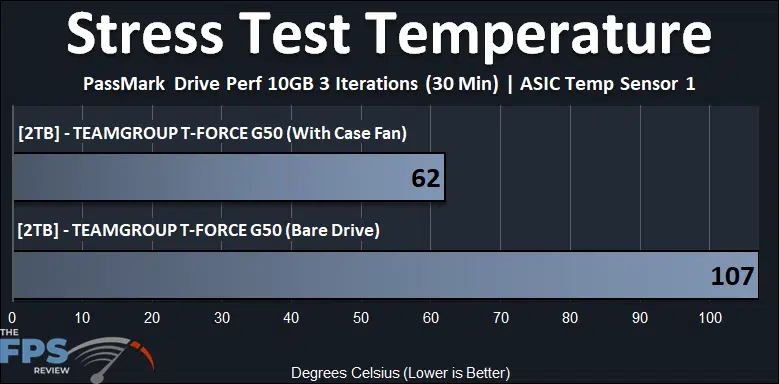

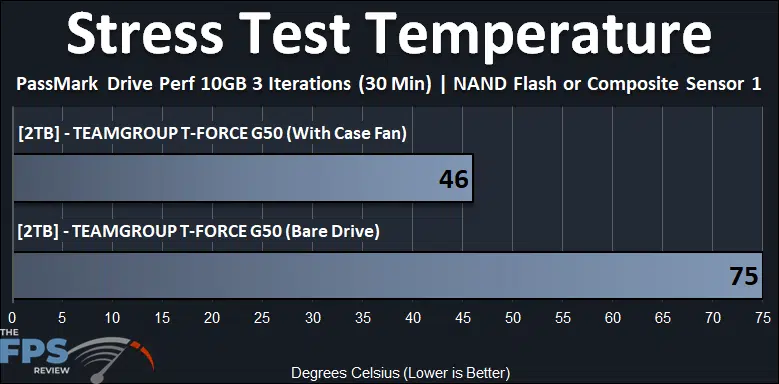

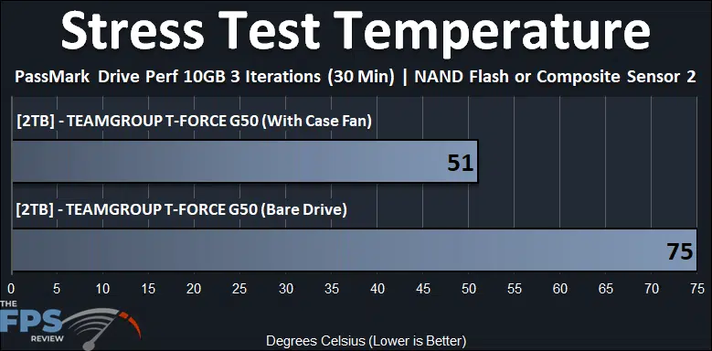

The goal of our temperature testing is to push the SSDs as hard as possible by performing a stress test of read and write. We run PerformanceTESTS’s advanced disk benchmark with a 10GB file, set to run each read/write test for 3 iterations, culminating in a 30-minute run. This is not typical usage behavior, but our goal is to find the maximum limits of the cooling. We utilize HWiNFO64 for reporting SSD temperatures, taking note of all sensor data, either the (NAND Flash or Composite Sensor) or the (ASIC) sensor. We have indicated “With Case Fan” and “Bare Drive” on the graph. Bare Drive does include any heat spreaders applied that come with the drive.
The graph above shows you the temperature difference between the Bare Drive (with Graphene heat spreader applied), compared to turning on a Case Fan that we have blowing across the SSD to simulate good case cooling. There is a distinct difference with the fan turned on. The Composite Sensor 1 and 2 reaches 75c with the bare drive, and cools down to 46c and 51c with a fan turned on.
The hottest component is the controller, in the ASIC temperature testing it reached 107c without a fan or heatsink. When we turned the case fan on, temperatures dropped massively down to 62c. Note that even at 107c, no drive failure, or drive warning messages were triggered, though you’d certainly not want it to remain at that temperature sustained. We recommend installing your M.2 heatsink from your motherboard, in a PC, and making sure you have good case cooling. In a laptop, you are more limited, but it shouldn’t cause any major issues unless you write to the drive at 100% load for 30+ minutes at a time non-stop. As a gaming drive, it will not have this load and will work just fine in a laptop.

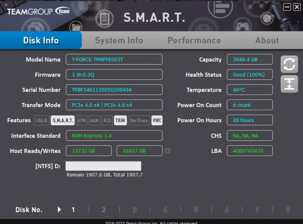

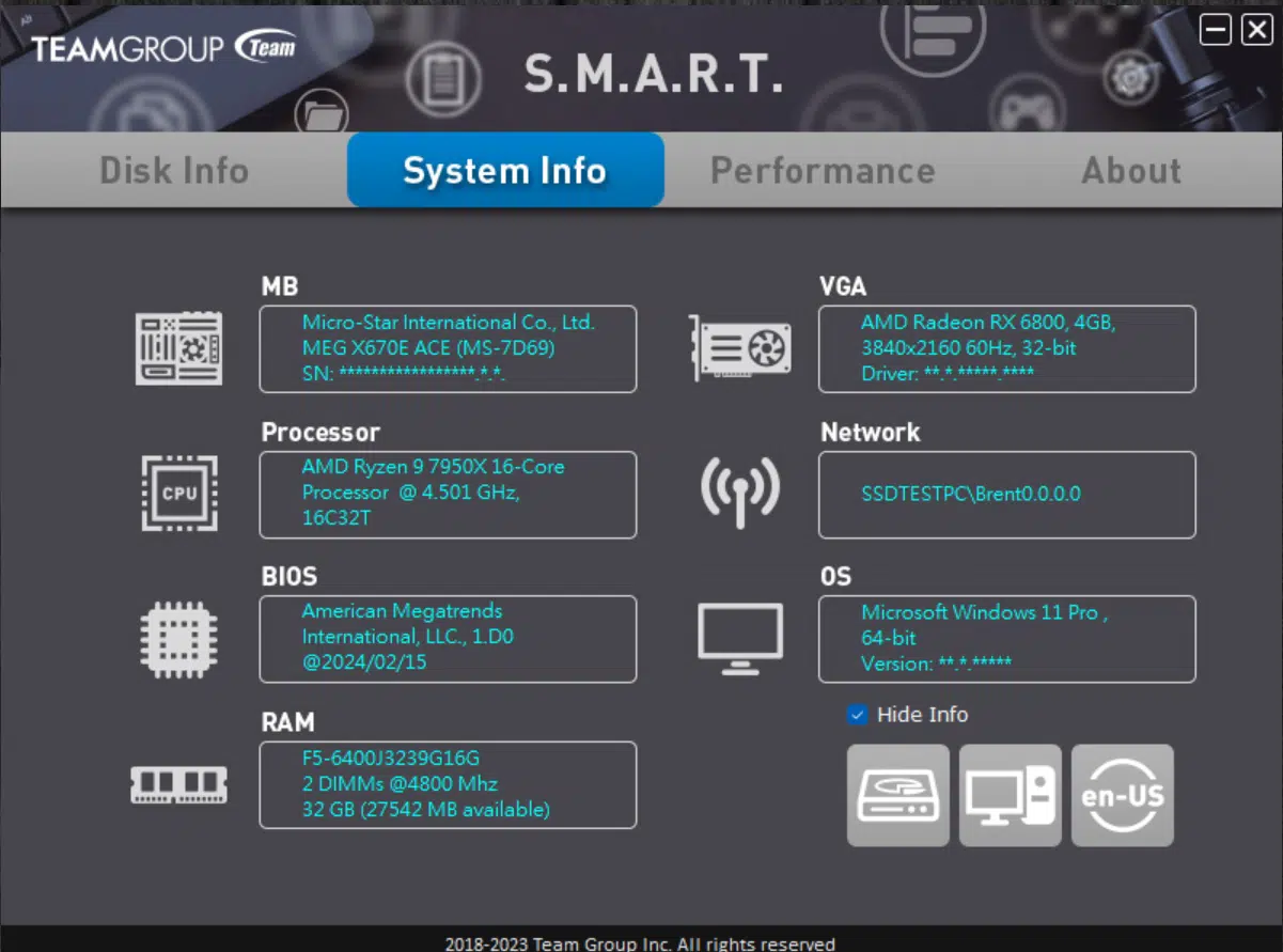

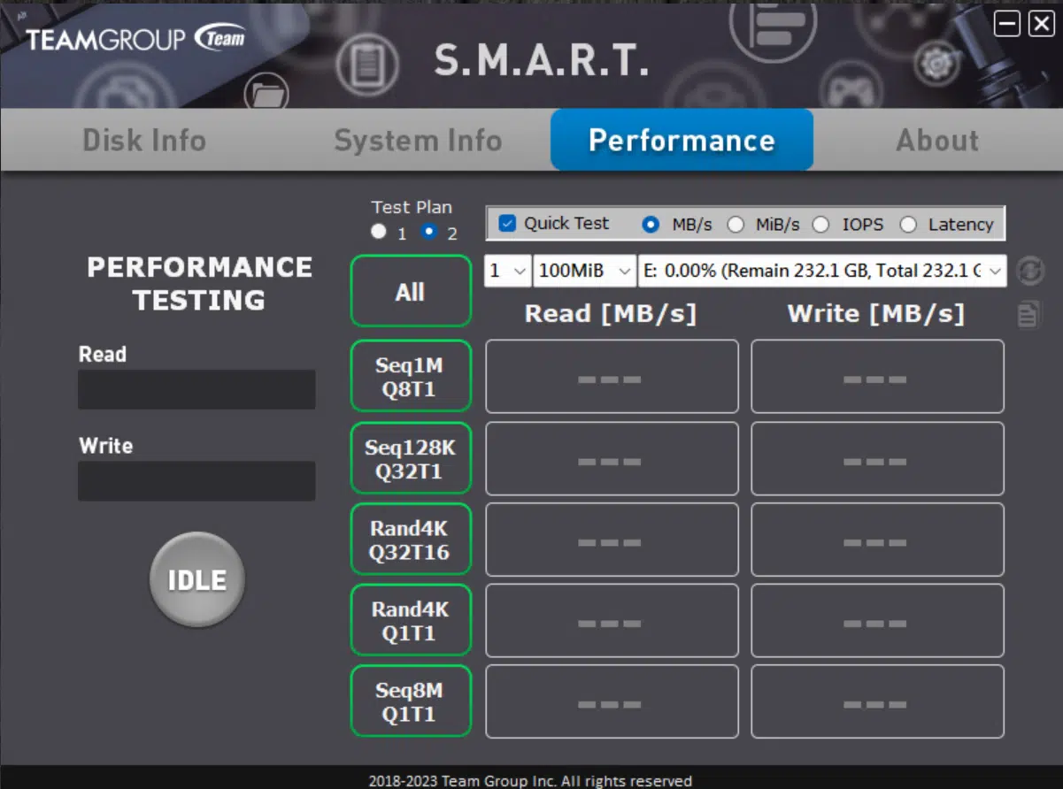

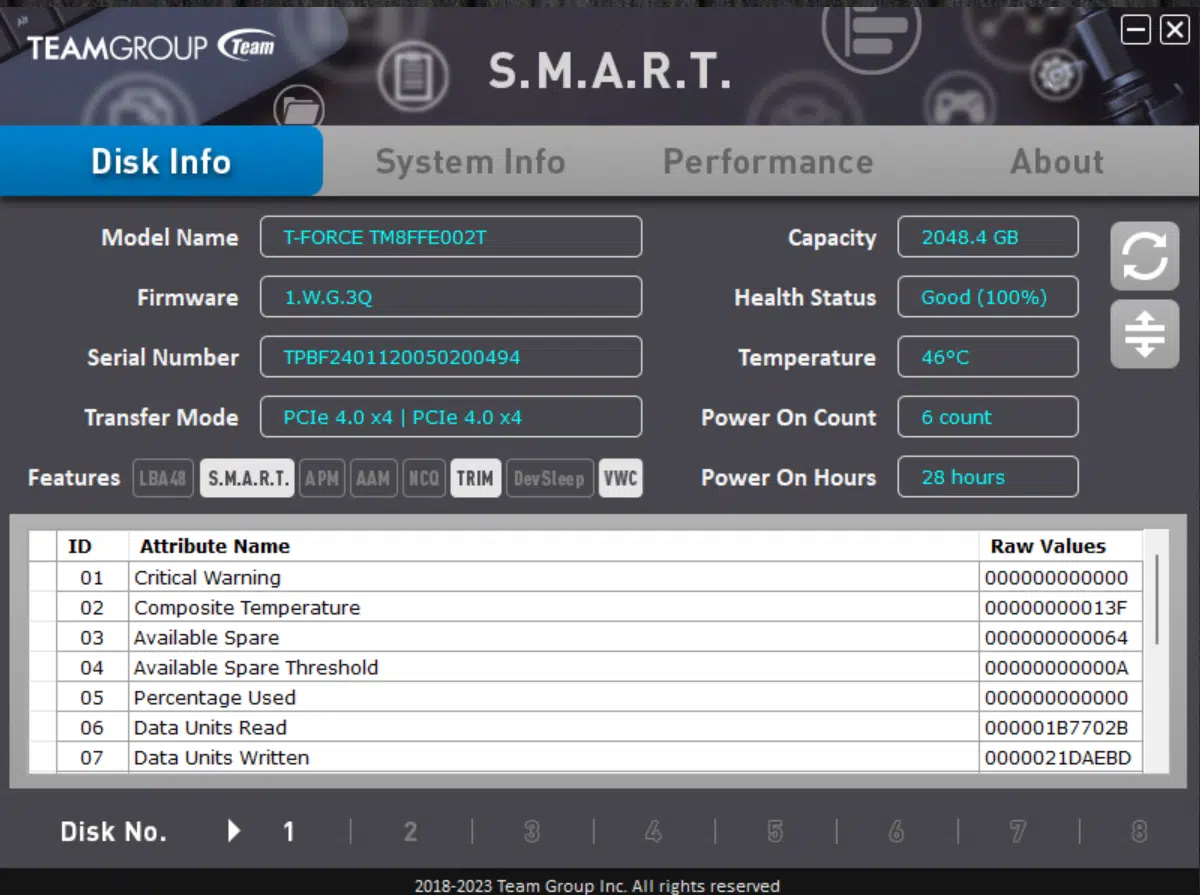

SSD S.M.A.R.T. Tool
TEAMGROUP has its SSD S.M.A.R.T. Tool available for download. The software allows you to view the S.M.A.R.T. data and provides health and temperature information on the drive, as well as a benchmark and some device info. However, it does not have a firmware update checker or ability, which would be a great addition we’d like to see. The software has not been updated in a long while.
