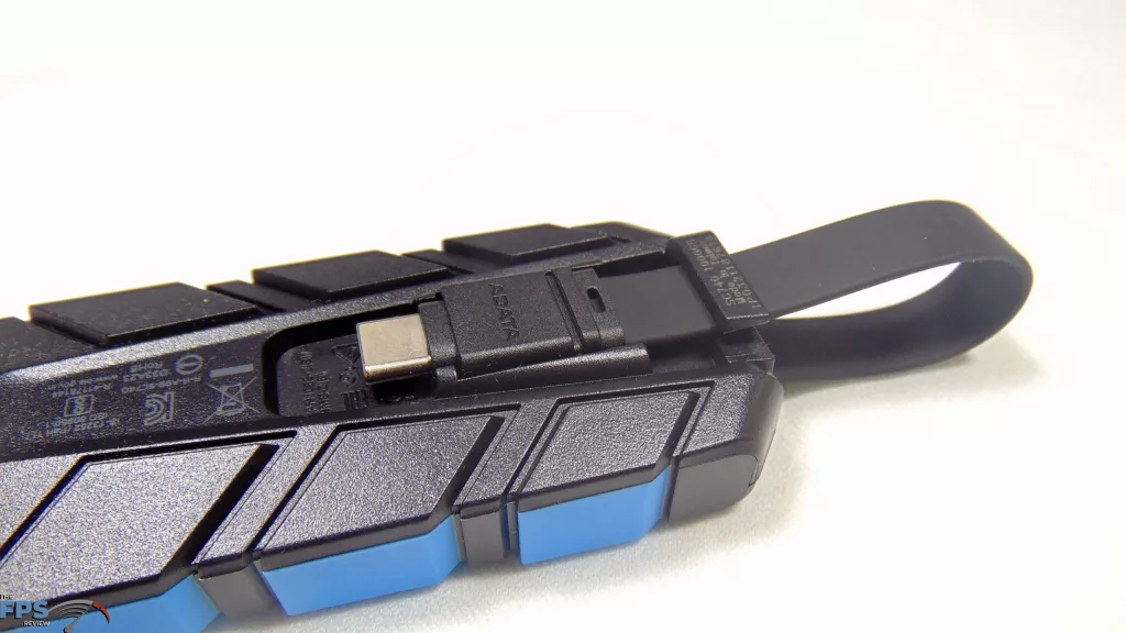

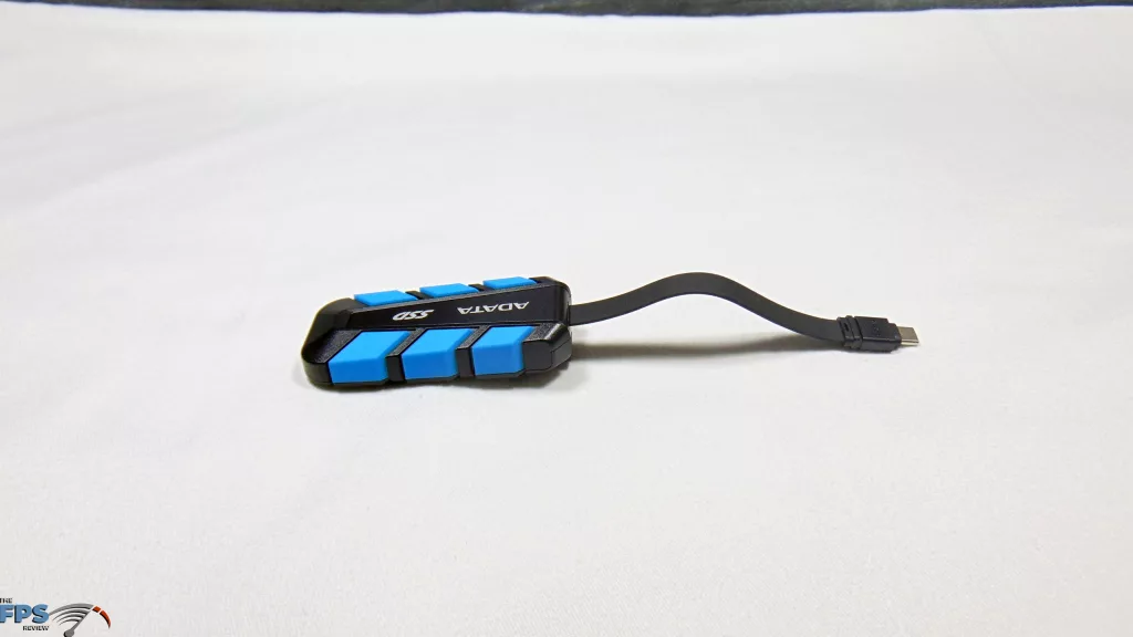

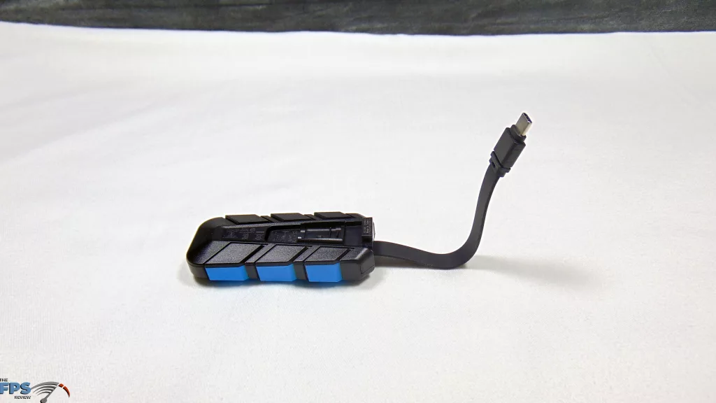

The ADATA SC740 has two unique features, the first is the built-in transfer cable. The Type-C connector cable is always attached to the USB and is stored in a convenient clip on the backside, folded up when not in use. It can be unclipped and provides 5″ (inches) of extension length. The other claim to fame is the fact that the ADATA SC740 meets the MIL-STD-810G 516.6 impact resistance standard to survive accidental drops and jarring. The MIL-STD-810G 516.6 standard means the device has passed drop-testing from a height of 1.22 meters.

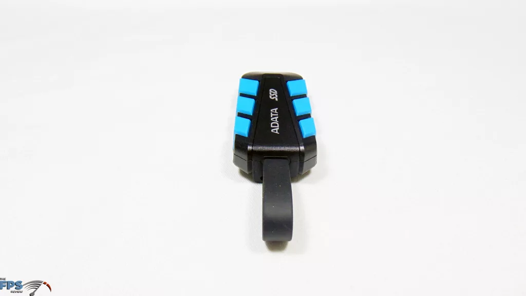

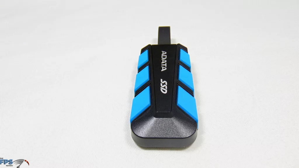

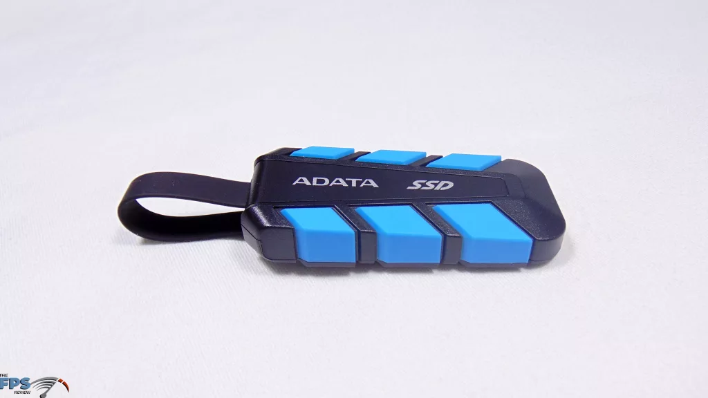

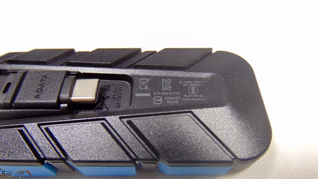

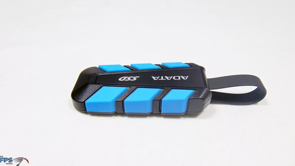

The ADATA SC740 is fully plastic and very light at 40g (1.41oz), there isn’t any weight to it. The blue bits on the edges are fully rubberized and take impact force, though the bottom edge is fully plastic; no rubber there on that end. The rubber does make gripping it easier, else it would slip out of your hand since the plastic is very smooth and slippery. The dimensions are: 121.75mm x 40.5mm x 22.3mm (4.8″ x 1.6″ x 0.88″) with the cable folded. The cable tucks in underneath the drive, folded, and clips in. When it is extended, you get 5″ of length.

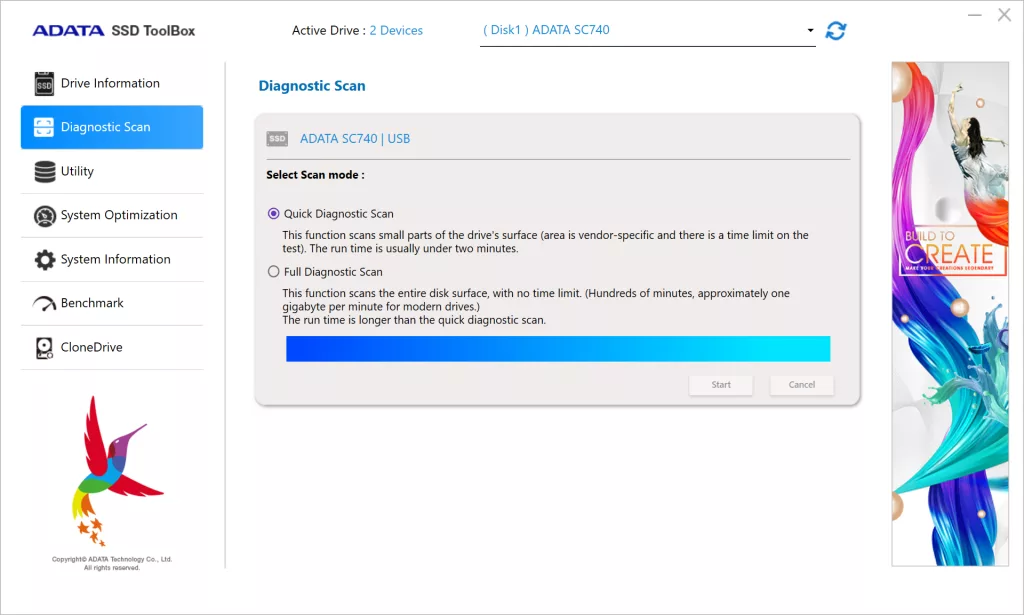

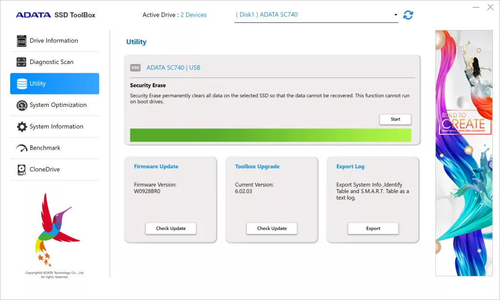

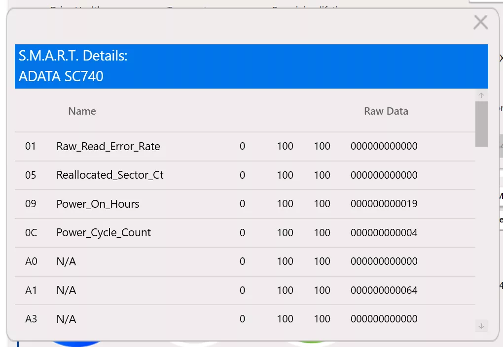

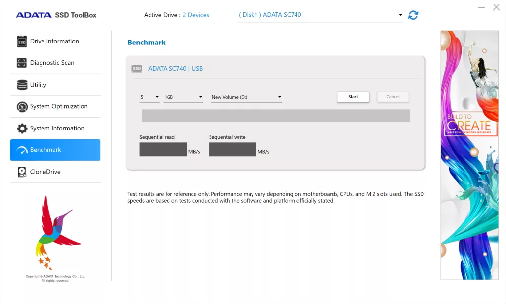

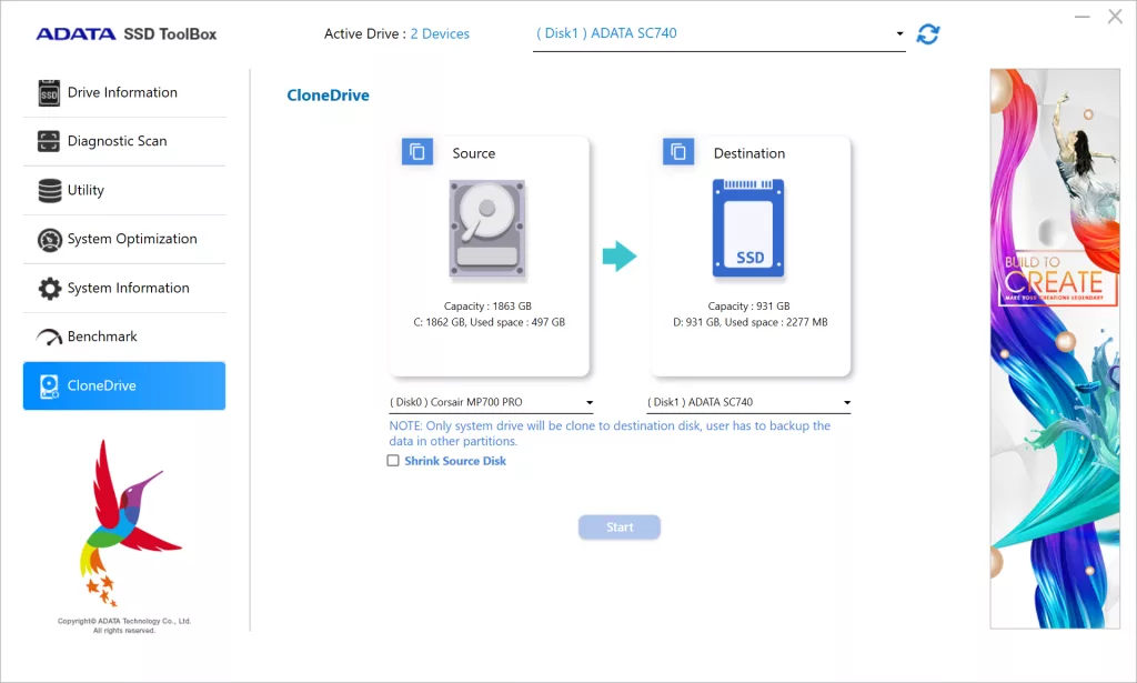

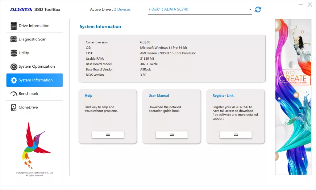

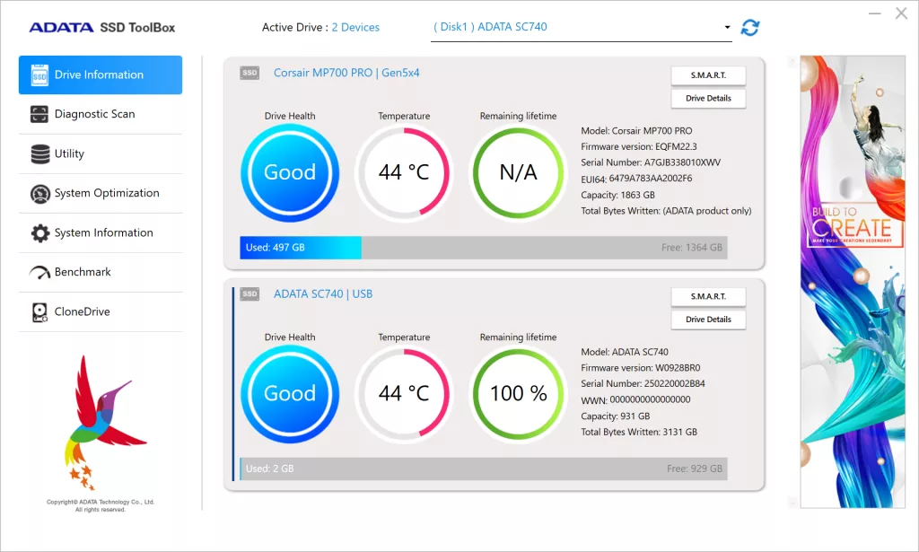

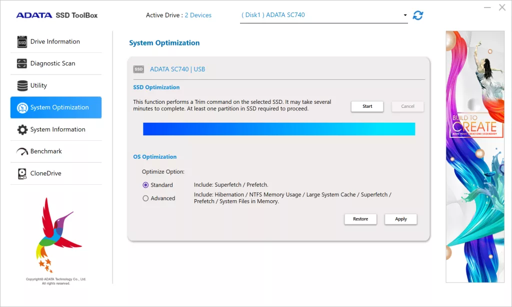

ADATA SSD ToolBox

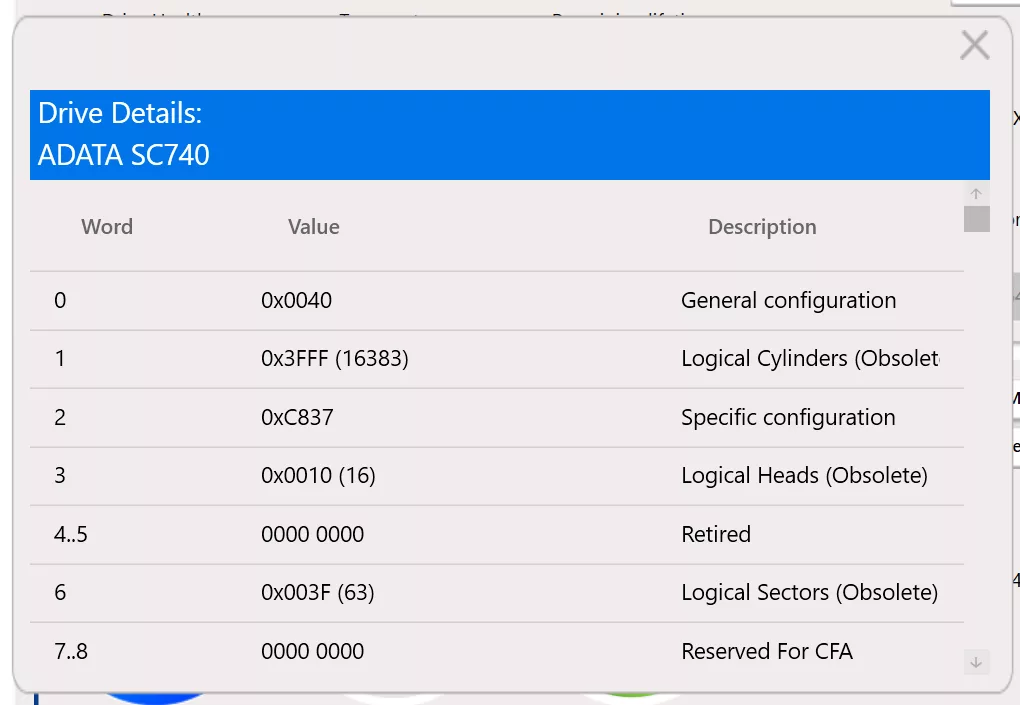

ADATA offers the SSD ToolBox for download, which provides useful information and features for the ADATA SC740. From the main screen, we can see the external SSD’s temperature, drive health, and remaining lifetime, which is really useful information for an external drive. It also has a diagnostic scan function to scan for drive problems. The utility feature allows for a Secure Erase function, great to see, and the ability to check for Firmware Updates. System Optimization allows you to set some Windows optimization commands to improve performance. There is also a built-in benchmark mode. It also includes a CloneDrive function built right in, which is great to see. As we mentioned, Backup software can also be downloaded from ADATA.
