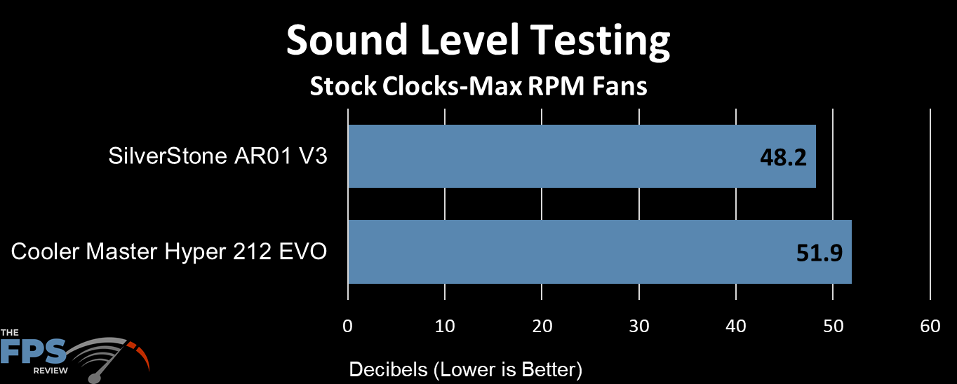

100% Fans
SilverStone AR01-V3 Sound Level Testing at Max RPM Fans
At maximum fan levels, the SilverStone AR01-V3 hit 48.2 dB(A) while the Cooler Master Hyper 212 EVO hit 51.9 dB(A). From a subjective perspective, both coolers sounded loud but not high pitched.

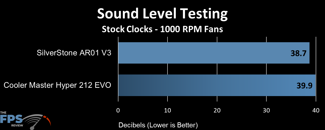

1000 RPM Fans
SilverStone AR01-V3 Sound Level Testing at 1000 RPM Fans
When we lowered the fans down to 1000 RPM, the SilverStone AR01-V3 kept the lead with a value of 38.7 dB(A) but the Cooler Master Hyper 212 EVO is right there on its heels at 39.9 dB(A). At this point, the noise sounded like it merged with the background noise.

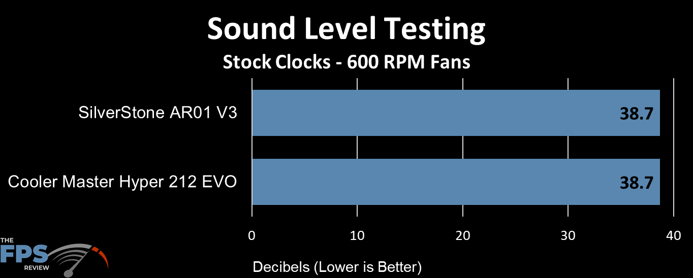

600 RPM Fans
SilverStone AR01-V3 Sound Level Testing at 600 RPM Fans
Lowering the fans to 600 RPM, the SilverStone AR01-V3 and Cooler Master Hyper 212 EVO tied at 38.7 dB(A).
Save for testing at 600 RPM, the SilverStone AR01-V3 was far and away the quieter of the two coolers. Even at 600 RPM it still did an excellent job, it was just the Cooler Master Hyper 212 EVO was finally starting to get its noise level in check as well and they ended up tied. That is definitely a solid outcome for the AR01-V3. With that said, let’s move on and recap all of this for you today!
