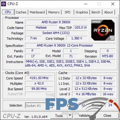

Unfortunately, our test CPU is incapable of achieving stability at 4.3GHz. As a result, 4.2GHz was all that I could get out of it with stability. This required a voltage setting of 1.4v, which reads as 1.38v in CPU-Z. I didn’t have to make any adjustments to CPU load-line calibration or anything else. All the settings were left on automatic.

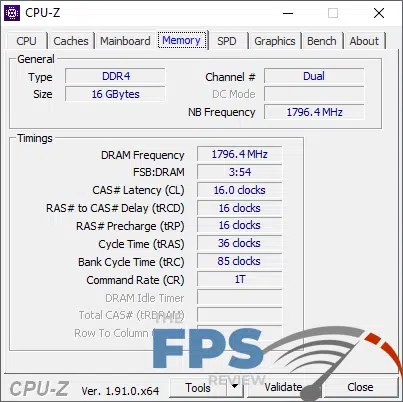

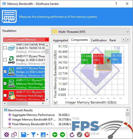

Memory overclocking is rather easy as well. I simply enabled XMP and verified the memory voltage was correct at 1.35v. I was able to take the G.Skill DDR4 3600MHz modules to 3733MHz with ease. The B550 Aorus Master never gave me headaches, lockups or problems when overclocked. It was as easy to work with as any motherboard I’ve ever worked with. In fairness, I’ve had this CPU on the bench a very long time and as a result, I can skip a lot of tweaking and dial in the settings I know the CPU needs. However, some motherboards do add difficulty in that I have to make some additional settings changes to achieve stability. That wasn’t the case here.
