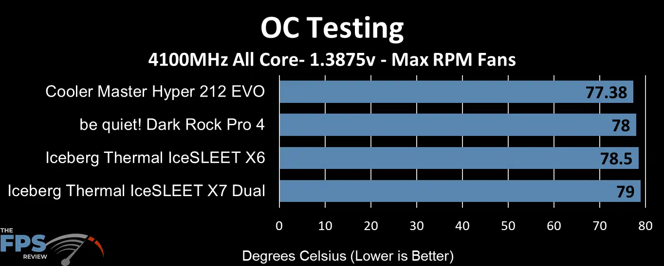

Max Fans
Iceberg Thermal IceSleet X6 Overclocked Max RPM Fan performance chart
Running our HSFs at full tilt leads to the Iceberg Thermal IceSLEET X6 posting a temperature of 78.5 degrees Celsius which is just ahead of the X7 Dual which is posting a temperature of 79 degrees Celsius. It trailed the Cooler Master Hyper 212 EVO (77.38 degrees Celsius) and be quiet! Dark Pro 4 (78 degrees Celsius). We noted that the max fan speed on the Cooler Master Hyper 212 EVO topped out at 2050 RPM, the Iceberg Thermal IceSLEET X6 topped out at 1900 RPM, the Iceberg Thermal IceSLEET X7 Dual topped out at 1600 RPM, and the be quiet! Dark Rock Pro 4 has the lowest max fan rpm at 1500 RPM.

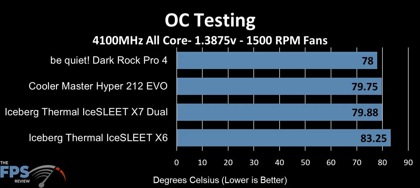

1500 RPM Fans
Iceberg Thermal IceSleet X6 Overclocked 1500 RPM Fan performance chart
At the 1500 RPM fan speed, the be quiet! Dark Rock Pro 4 leads all challengers at 78 degrees Celsius while the Cooler Master Hyper 212 EVO posted a value of 79.75 degrees Celsius. The Iceberg Thermal IceSLEET X7 Dual was right on the Hyper 212 EVO’s heels at 79.88 degrees Celsius and the IceSLEET X6 was watching everyone from the rear at 83.25 degrees Celsius.

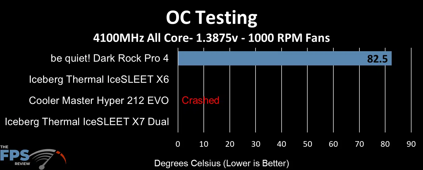

1000 RPM Fans
Iceberg Thermal IceSleet X6 Overclocked 1000 RPM Fan performance chart
At the 1000 RPM fan speed, the be quiet! Dark Rock Pro 4 posted a value of 82.5 degrees Celsius. The Cooler Master Hyper 212 EVO, Iceberg Thermal IceSLEET X7 Dual, and Iceberg Thermal IceSLEET X6 all failed to keep the temperature in check here and our system crashed.
