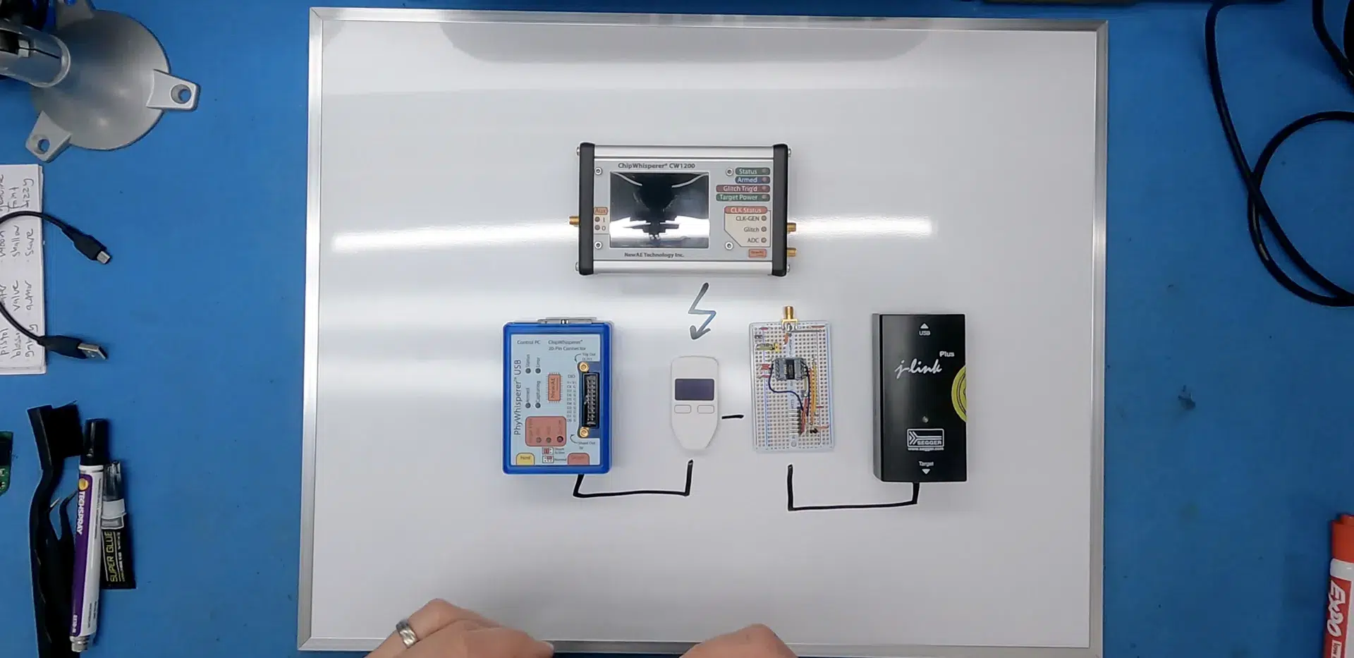

“I was contacted to hack a Trezor One hardware wallet and recover $2 million worth of cryptocurrency (in the form of THETA). Knowing that existing research was already out there for this device, it seemed like it would be a slam dunk. Little did I realize the project would turn into a roller coaster ride with over three months of experimentation, failures, successes, and heart-stopping moments. It reminded me that hacking is always unpredictable, exciting, and educational, no matter how long you’ve been doing it. In this case, the stakes were higher than normal: I only had one chance to get it right.”

Simply put, the exploit(s) for getting the wallet to release its booty revolved around another previously discovered by a 15-year-old in the U.K. back in 2017. That person had helped another recover roughly $30,000, small fry compared to this latest lost treasure. The trick involved finding where the PIN had been stored in RAM after a firmware update that allowed unauthorized code to be installed. The method was not without risks, as it could inadvertently cause the RAM to erase itself. This led the two to look at the research done in 2018. They discovered that the wallet would still temporarily move the PIN to RAM to prevent it from being erased during updating. The solution was a type of fault injection attack to read the PIN before it was removed. The risk was still high, as this could be a one-shot, and if it failed, the PIN would be lost forever.
Lucky for them, it worked, and Dan did pay Joe a percentage of the recovered funds as compensation for his hard work. Trezor has also published a statement that this exploit has since been patched out in another firmware update.
