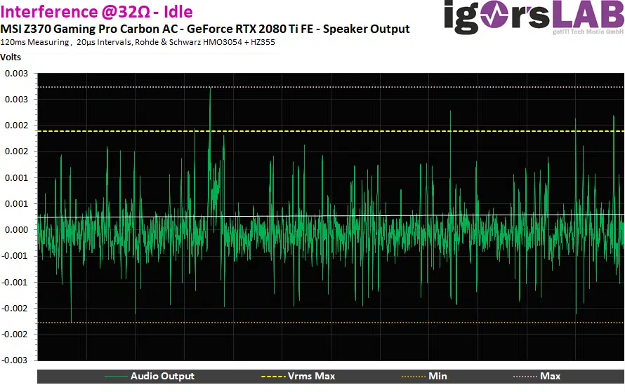

External voltage distance and the graphics card
For a better comparison, let’s first start in absolute idle mode, where nothing moves on the screen and even the mouse has a transmission pause once. What we now see as measurement curves is the so-called extraneous or interference voltage. Transients can even be cruel! Here, too, I do not claim laboratory accuracy with the rather simple test setup, but it is always accurate enough to be able to make a reliable statement. The volume control is in the position where the distortion-free maximum level was previously determined.
