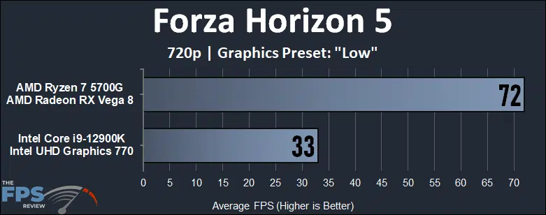

The next most recent game released is Forza Horizon 5 on the PC. For this game, we are utilizing the graphics preset options, and the built-in benchmark.
Intel 12900K (UHD 770) iGPU vs AMD 5700G (Vega 8) APU Performance Benchmarks Forza Horizon 5 720p performance graph
In this graph above we are playing the game at 720p and with the “Low” graphics preset selected. The “Low” setting is actually not the lowest setting, there is a “Very Low” setting, but we actually didn’t have to go down that low because even the Intel UHD 770 here was averaging around 33FPS at “Low” settings, and the game was playable. However, that is nothing on the AMD Ryzen 7 5700G Vega 8 which is running at an astonishing 72FPS average, well above 60FPS. Suffice it to say, that’s extremely playable and enjoyable. At this setting the 5700G with Vega 8 is 118% faster than the 12900K with Intel UHD 770!

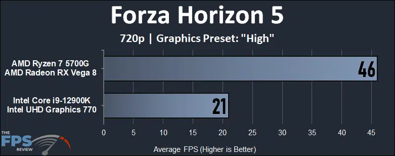

Since Forza Horizon 5 performed so well on the AMD Ryzen 7 5700G with AMD Radeon RX Vega 8 graphics we decided to see what we could crank the game settings up to and still get very smooth performance. We found that we could take the game all the way up to the “High” graphics setting on the 5700G with Vega 8, we still got 46FPS average. This is 119% faster than the 12900K Intel UHD 770.

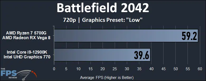

Battlefield 2042
Next on the list is Battlefield 2042, we had to find out how this would also perform. We chose to create a private Portal server, and test with no players, it’s the only way we can assure a consistent run-through. We created a custom team deathmatch and a manual run-through in the whole map.
Intel 12900K (UHD 770) iGPU vs AMD 5700G (Vega 8) APU Performance Benchmarks battlefield 2042 720p performance graph
Starting at 720p and “Low” settings wasn’t as bad as we had expected. The Intel Core i9-12900K with UHD Graphics 770 performed around 39FPS on average, but it wasn’t a smooth experience. There was a lot of lagging and jerkiness while playing on the UHD 770, it certainly had some texture loading problems slowing down performance and smoothness. The Ryzen 7 5700G with Vega 8 did much better, nearly 60FPS gameplay at these settings, and it was smooth, no lagging. The 5700G with Vega 8 was 49% faster.

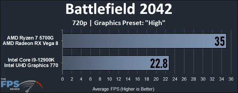

Since the AMD Ryzen 7 5700G with Vega 8 performed so well, we cranked the settings up at 720p to see what would happen. Turning the settings up past “Medium” did bring down performance quite a bit, even on the Vega 8. It’s now down to 35FPS at “High” settings. It’s 54% faster than the Intel UHD 770.
