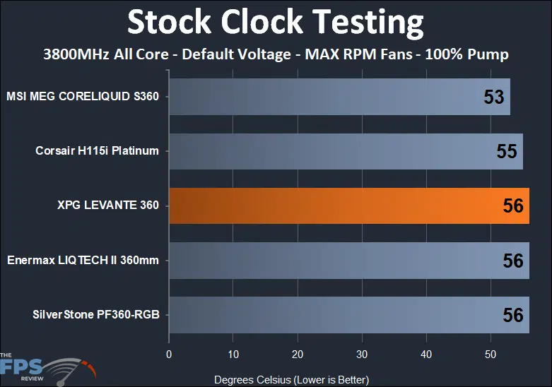

Max Fans – 100% Pump Speed
XPG Levante 360 stock clock, max RPM thermal performance
Starting off our testing, the XPG LEVANTE 360 turned in a temperature of 56 degrees Celsius which was tied in the back of the pack, but still a reasonable showing compared to the others.
Keep in mind that the maximum speed varies between the units in this test. This ranged from the XPG LEVANTE 360 was running at 2150RPM down to the Corsair H115i Platinum in the 1600RPM range.

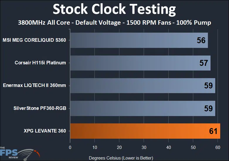

1500 RPM Fans – 100% Pump Speed
XPG Levante 360 stock clock, 1500 RPM thermal performance
Dropping the fans to 1500 RPM caused the field to separate a bit with the XPG LEVANTE 360 dropping behind its competition at 61 degrees Celsius.

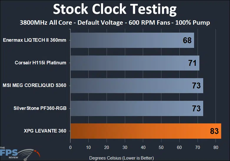

600 RPM Fans – 100% Pump Speed
XPG Levante 360 stock clock, 600 RPM thermal performance
Finally, down at 600 RPM, the XPG LEVANTE 360 takes a bow for its 83 degree Celcius performance, a full 10 degrees hotter than the SilverStone PF360-RGB and MSI MEG CORELIQUID S360.
