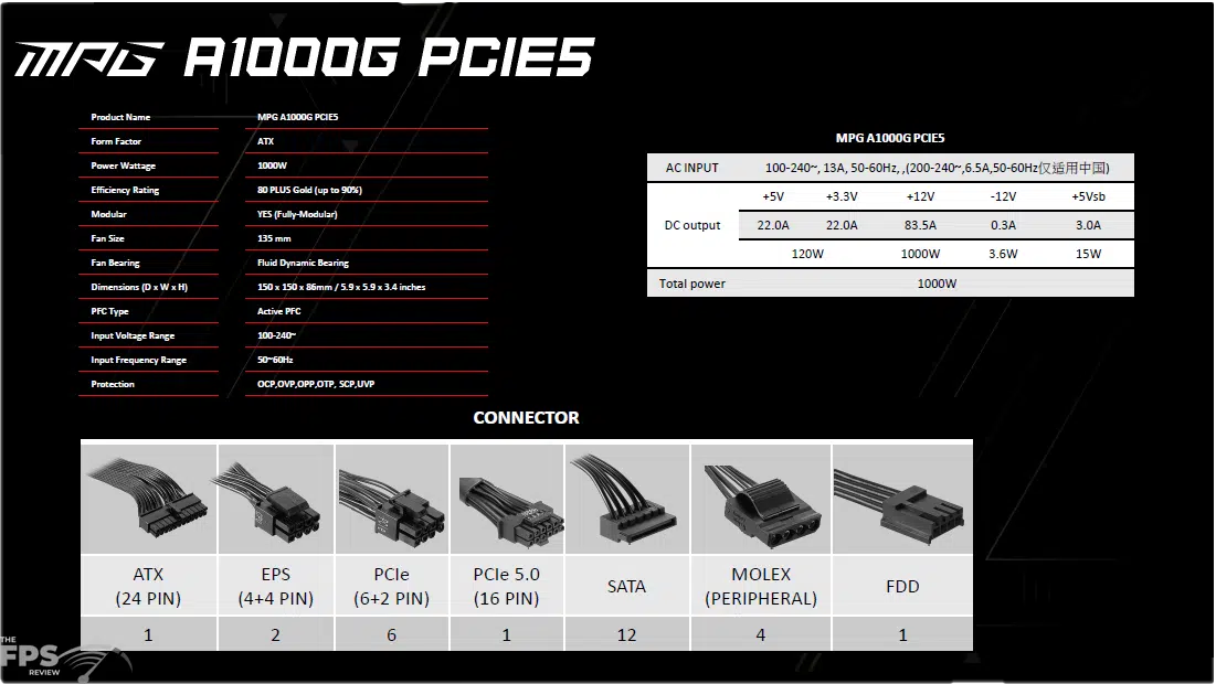

The MPG A1000G PCIE5 is a 1000W power supply and 80 Plus Gold up to 90%, fan size is 135mm.  The power supply measures 5.9 inches in depth and width and 3.4 inches in height.  As you can see from the label it supports 1000W across the +12V rail at 83.5A and 120W across the +5V and +3.3V.  It comes with 1x ATX 24-pin, 2x 4+4 EPS, 6x 6+2 PCIe, 1x PCIe 5.0 16-pin, 12x SATA, 4x Molex and 1x FDD. MSRP will be $199.99.

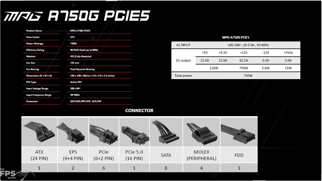

The MPG A750G PCIE5 is a 750W power supply and 80 Plus Gold up to 90%, fan size is 135mm.  The power supply measures 5.9 inches in depth and width and 3.4 inches in height.  As you can see from the label it supports 750W across the +12V rail at 62.5A and 120W across the +5V and +3.3V. It comes with 1x ATX 24-pin, 2x 4+4 EPS, 6x 6+2 PCIe, 1x PCIe 5.0 16-pin, 8x SATA, 4x Molex and 1x FDD.
