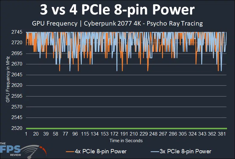

3 vs. 4 PCIe 8-pin Power
The GeForce RTX 4090 Founders Edition video card comes with a power adapter that allows 3x or up to 4x 8-pin PCIe Power Connectors to be connected. NVIDIA states that the requirement is only 3x 8-pin PCIe Power Connectors and that the 4th one is there to allow up to 600W of power for increased overclocking potential. We wanted to test the GPU clock speed between 3x and 4x PCIe 8-pin Power Connectors to make sure this claim is true and see if there are any differences between 3x or 4x PCIe 8-pin Power Connectors on the Founders Edition video card.
NVIDIA GeForce RTX 4090 Founders Edition 3 vs 4 PCIe 8-pin Power GPU Frequency Comparison Graph
Sensors3x PCIe 8-pin Power4x PCIe 8-pin Power
Board Power Draw431.6W435.6W
GPU Chip Power Draw354.3W357W
GPU Temperature66.9c68.3c
GPU Hot Spot78.8c77.7c
MVDDC Power Draw70.5W70.4W
PWR_SRC Power Draw79.5W79.6W
GPU Voltage1.0500V1.0500V
From the graph we can see that the GPU clock speed lines up exactly between 3x or 4x PCIe 8-pin Power Connectors, there is no difference in default settings. It has the same minimums and maximums, and pretty much lines up. We can further see from the power table that the Board Power, GPU Chip Power, Temperature, MVDDC Power, and PWR_SRC are all similar between 3x or 4x PCIe 8-pin Power Connectors on the Founders Edition, they are all within marginal errors. This means that there are indeed no drawbacks to running just 3x PCIe 8-pin Power Connectors on the GeForce RTX 4090 Founders Edition, the 4th one is not required for normal operation.

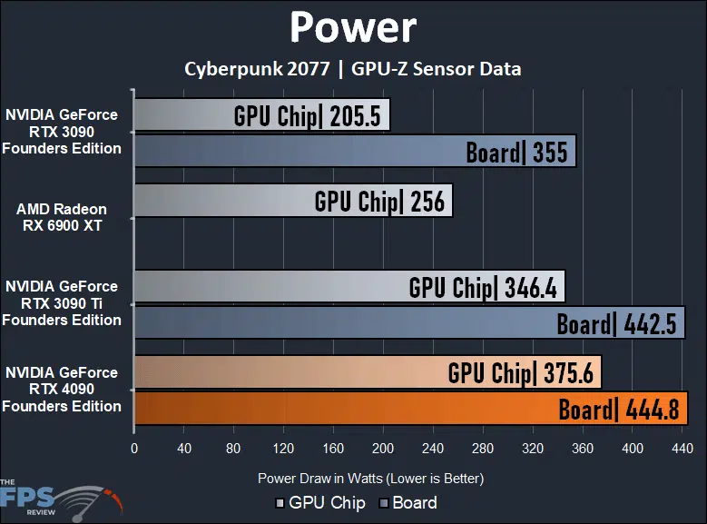

NVIDIA GeForce RTX 4090 Founders Edition Power Graph

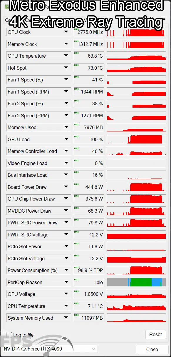

Testing power draw on the NVIDIA GeForce RTX 4090 Founders Edition resulted in some interesting data. First and foremost, we could not max out the TDP of the video card just playing games. We did have all 4 of the PCIe 8-pin Power Connectors plugged in during these power tests. We tried various games and graphics settings trying to push the GPU as hard as possible, and we could not get it to ever reach 100% TDP or 450W, the maximum was 96.8% TDP according to GPUz. The closest we could come to was in Metro Exodus Enhanced at 4K pushing the Extreme Ultra Quality Ray Tracing quality setting.
In this setting, the card hit 444.8W Board Power as the maximum, which was only just about a couple of Watts higher than the GeForce RTX 3090 Ti FE. The GPU Chip Power was higher though at 375.6W versus the GeForce RTX 3090 Ti FE at 346.4W. This is different than the GeForce RTX 3090 FE, which we could max out the TDP with. That said, these values are not exceeding 450W, and in fact the power efficiency of the GeForce RTX 4090 FE seems to be very good, it’s no more power-hungry than the GeForce RTX 3090 Ti FE, yet performs so much faster in gameplay performance.

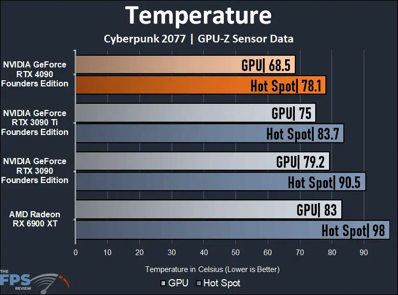

NVIDIA GeForce RTX 4090 Founders Edition Temperature Graph
Speaking of temperatures, wow are they impressive on the NVIDIA GeForce RTX 4090 Founders Edition video card. This beefy cooler is doing its job alright. The GeForce RTX 4090 FE is actually the coolest running GPU on this graph. It only reached 68.5c maximum GPU Temperature and 78.1c Hot Spot. This is cooler than the GeForce RTX 3090 Ti and Radeon RX 6900 XT. What’s more, it did this at only 45% and 41% fan speeds, meaning the video card ran very quietly. For comparison, the GeForce RTX 3090 Ti FE ran at 60% fan speed on both fans and the GeForce RTX 3090 FE ran at 70% on both fans.

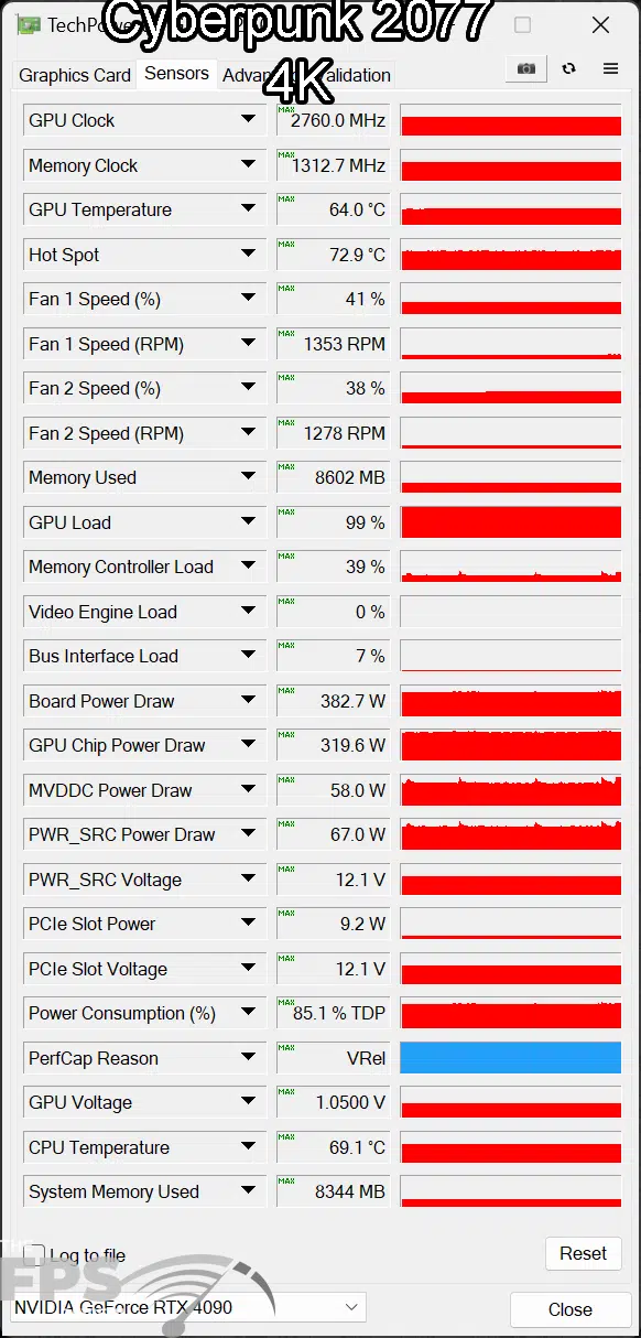

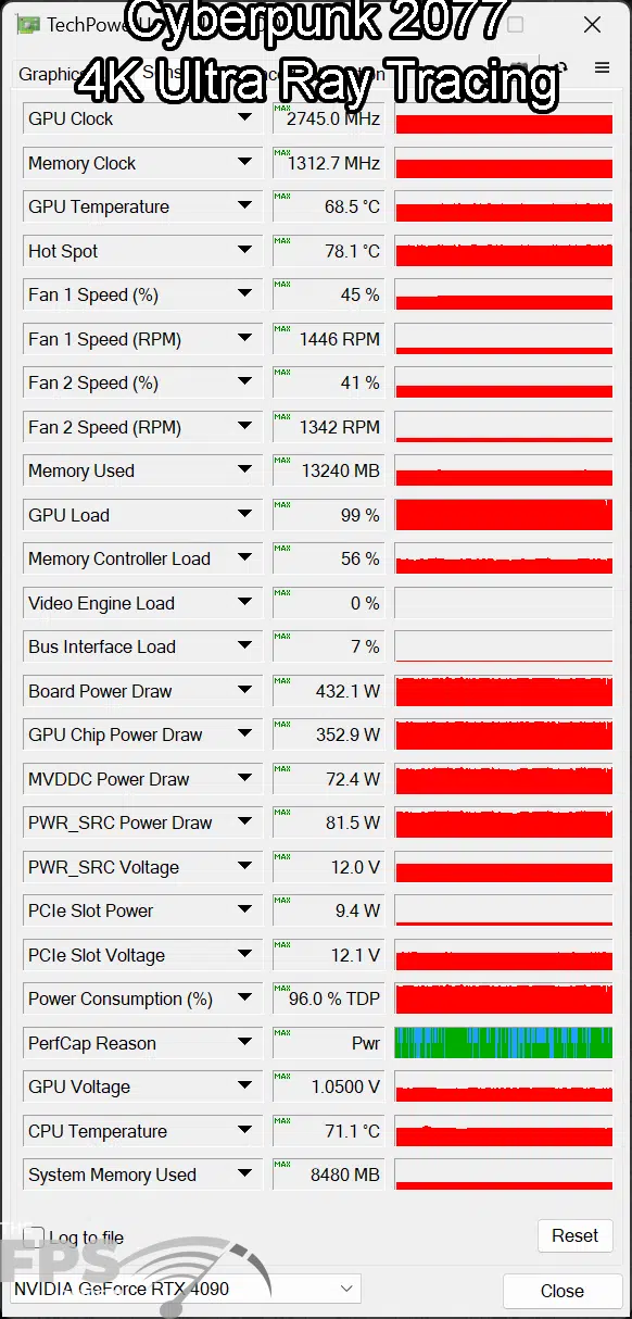

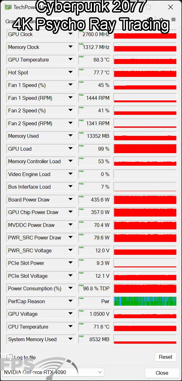

GPU-Z Sensor Data
In the above GPUz screenshots, you can see the full sensor results at various game settings on the GeForce RTX 4090 Founders Edition.
