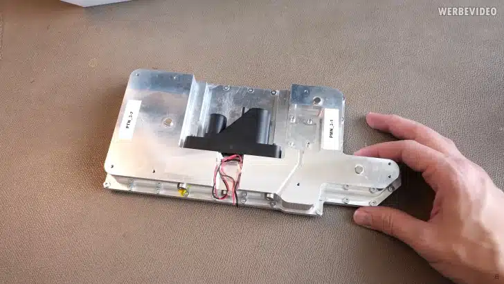

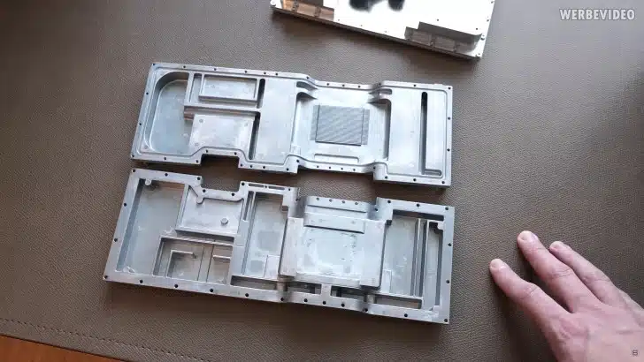

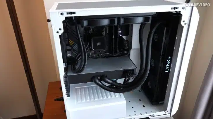

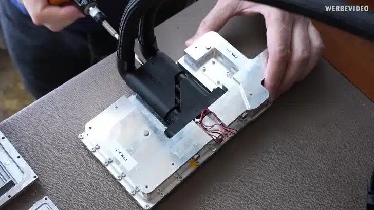

Der8auer used an early demo version made for an AMD Radeon RX 7900 XTX. Another good candidate for testing in light of power consumption and heat. It was seen holding 50C, and 75C at the junction, under load with Furmark. The LYNK+ block is made from aluminum diecast that has been CNC milled. It was paired with a 360mm radiator but a 240 mm will be available as well. The system features a quick connect solution for plugging in components. This means when a user upgrades their GPU they need only disconnect the system, removed the old card and block, install the new card with its new block (unless the old one fits), and reconnect it.
Per Wccftech:
“The radiator is interesting and two designs were showcased, a 240mm and a 360mm. Both feature the pump, reservoir, and radiator along with additional air pockets so that air cannot get trapped in the water block since it can cause adverse effects in relation to the temperatures. But what makes the LYNK+ modular is its connectors which come in a sort of quick connector design.”
A modular design also means that the user could add additional radiators, and swap out hoses for longer or shorter as needed. Unlike current-gen AIOs the pumps are external and paired with the radiators.
