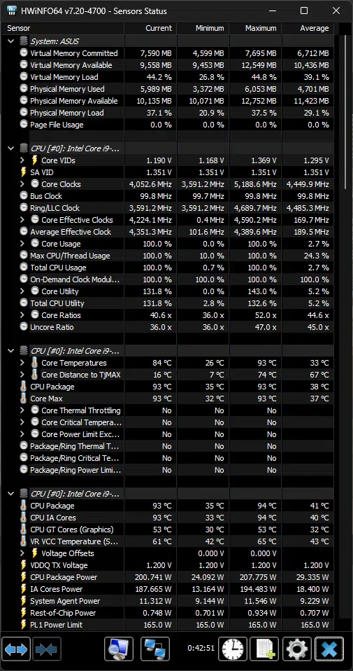

Here you can see the average clocks are a bit lower than you would expect, though the maximum clocks are respectable. The PLL power limit max was only 207w whether the Intel limit was enforced or not. This definitely shows a limitation of the board hardware. If you look at the CPU temperatures, they are still a few degrees below throttling. On other boards, you can push a bit further and hit 101c if you want to. Additionally, you’ll see the PLL power limit hit about 247w on average. We are well below that here. Again, I think we are truly limited by the VRMs and their input power having only one 8-pin CPU power connection. Even though it does have an ASUS ProCool power connector, it’s not going to carry enough voltage to really feed the upper-echelon CPUs.
