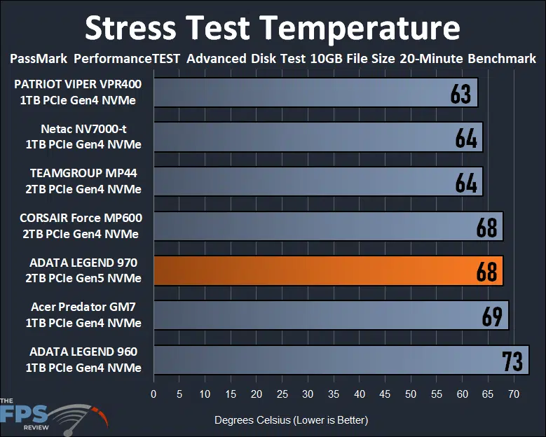

The ADATA LEGEND 970 2TB SSD we have reviewed today does utilize a custom heatsink and fan pre-installed. Our maximum temperatures while running a stress test for 20 minutes managed to heat up the SSD to 68c.
It is true that PCIe Gen5 SSDs run hotter, the controller is more powerful and can push higher bandwidths, and with that comes added heat. It is imperative to keep a Gen5 SSD cooled with either a robust passive heatsink or an active solution, especially the faster you go.
With the ADATA LEGEND 970 hitting 68c, it doesn’t run as hot as the ADATA LEGEND 960 or Acer Predator GM7. However, it is still on the higher end of the spectrum, but consider the performance it offers. The temperatures are well within tolerable limits for the SSD, and at these temperatures, it will not throttle.

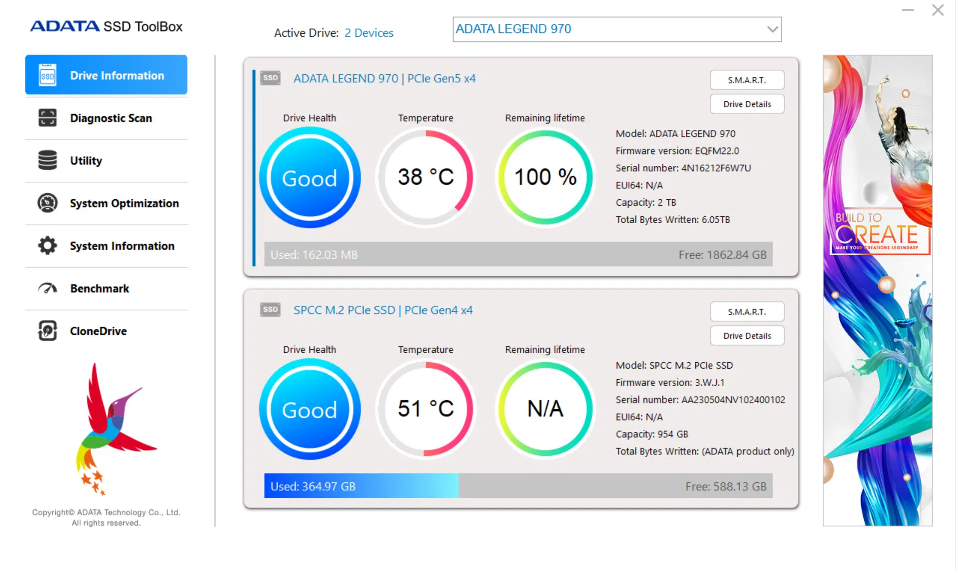

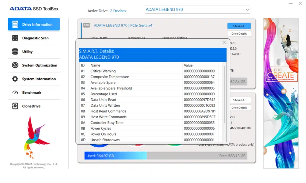

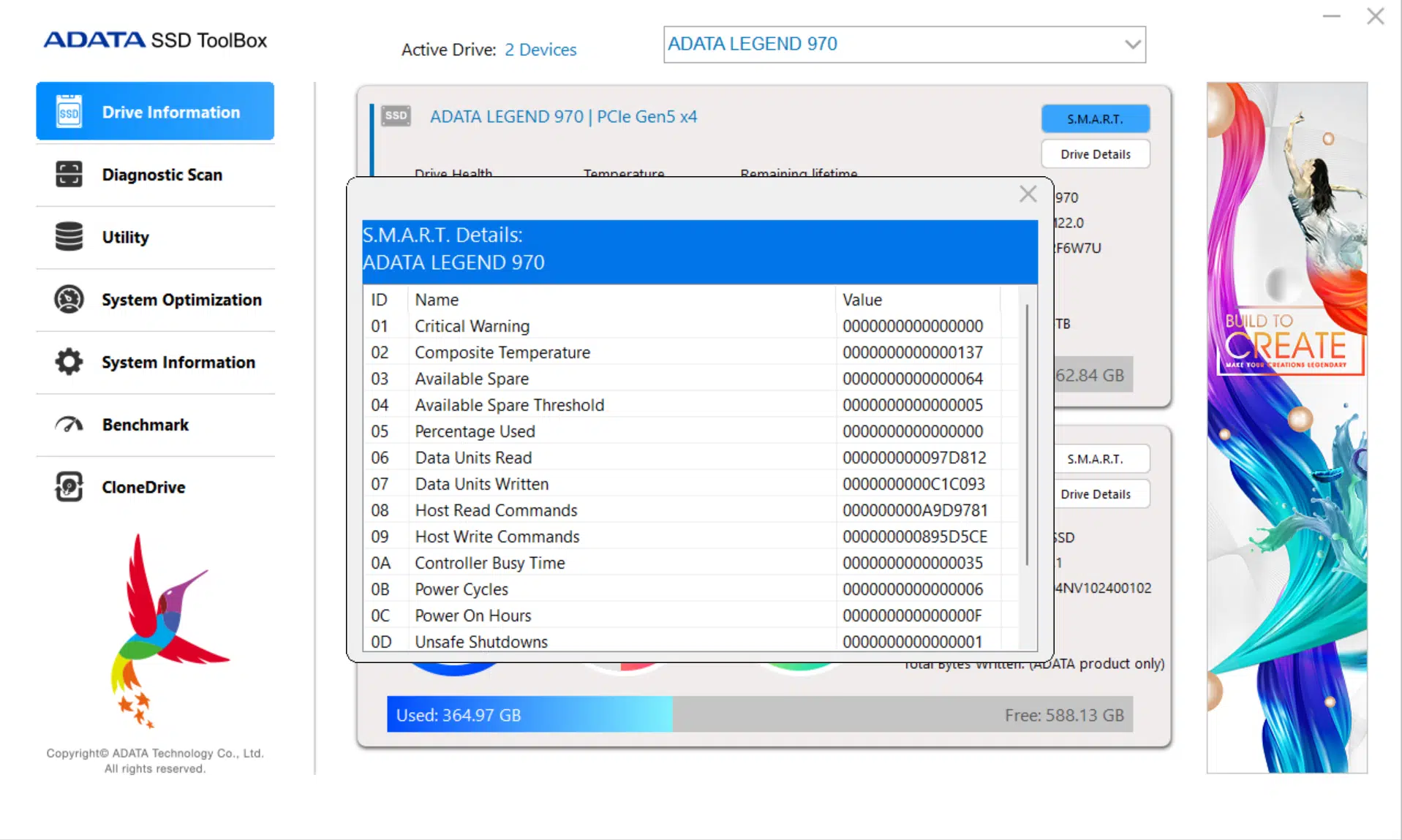

Starting in the main menu, you are able to view the drive health, temperature, and remaining lifespan of the ADATA LEGEND 970. These metrics are extremely important in owning an SSD, so that you may keep an eye on its lifespan and health. In addition, the temperature monitoring is a great bonus so you can easily see how hot the SSD is getting, and if it is getting to throttling temperatures. In addition, you can check S.M.A.R.T. status and drive details from this menu as well.

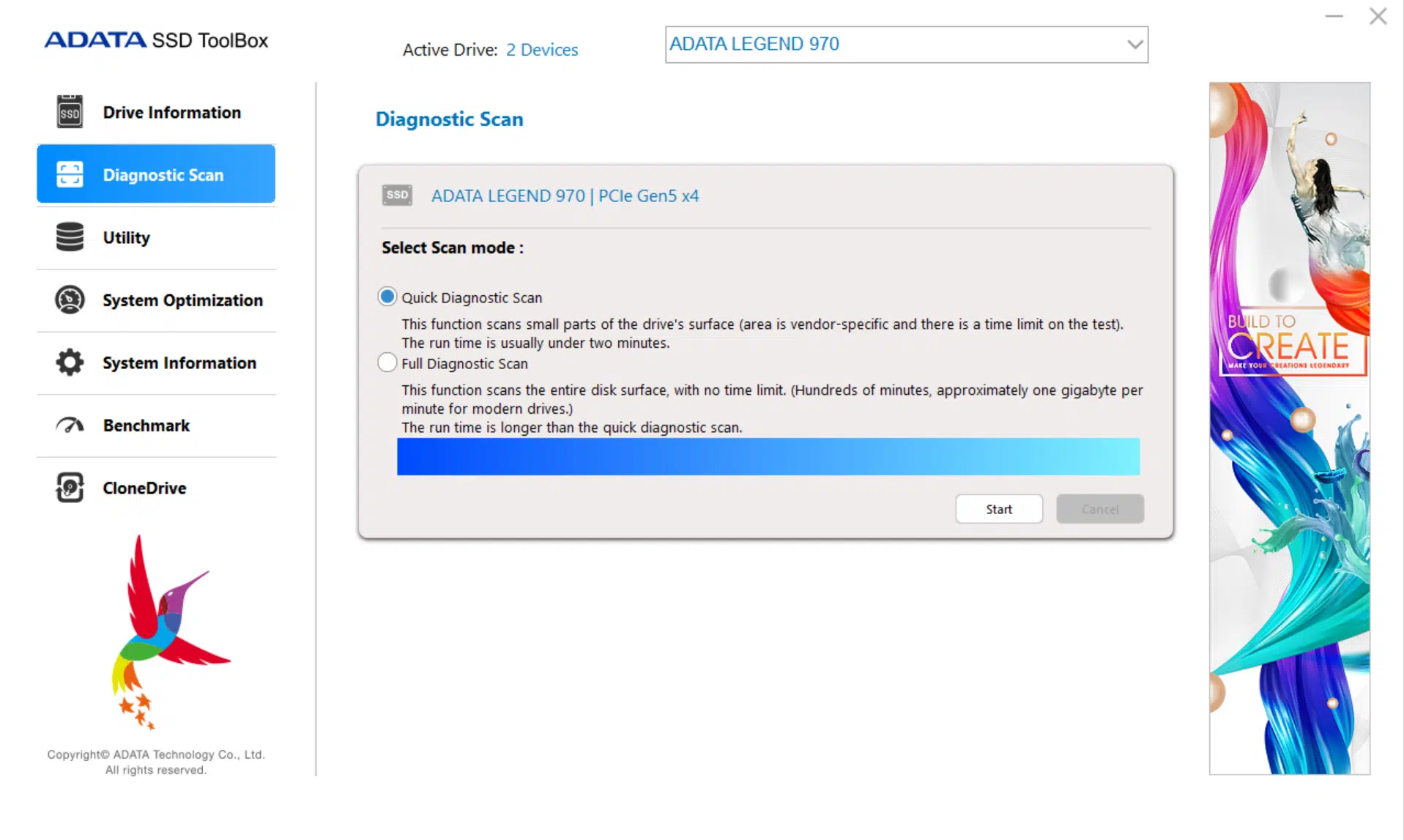

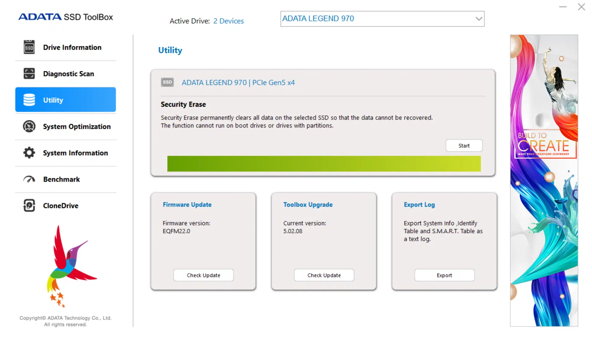

The ADATA SSD Toolbox offers a quick and full diagnostic scan ability that scans your drive for errors. The SSD Toolbox also allows you to check for firmware updates and update firmware if needed, something we did check before testing. This ability is very important. It also offers a Secure Erase function, to securely erase data on the SSD, another very important feature.

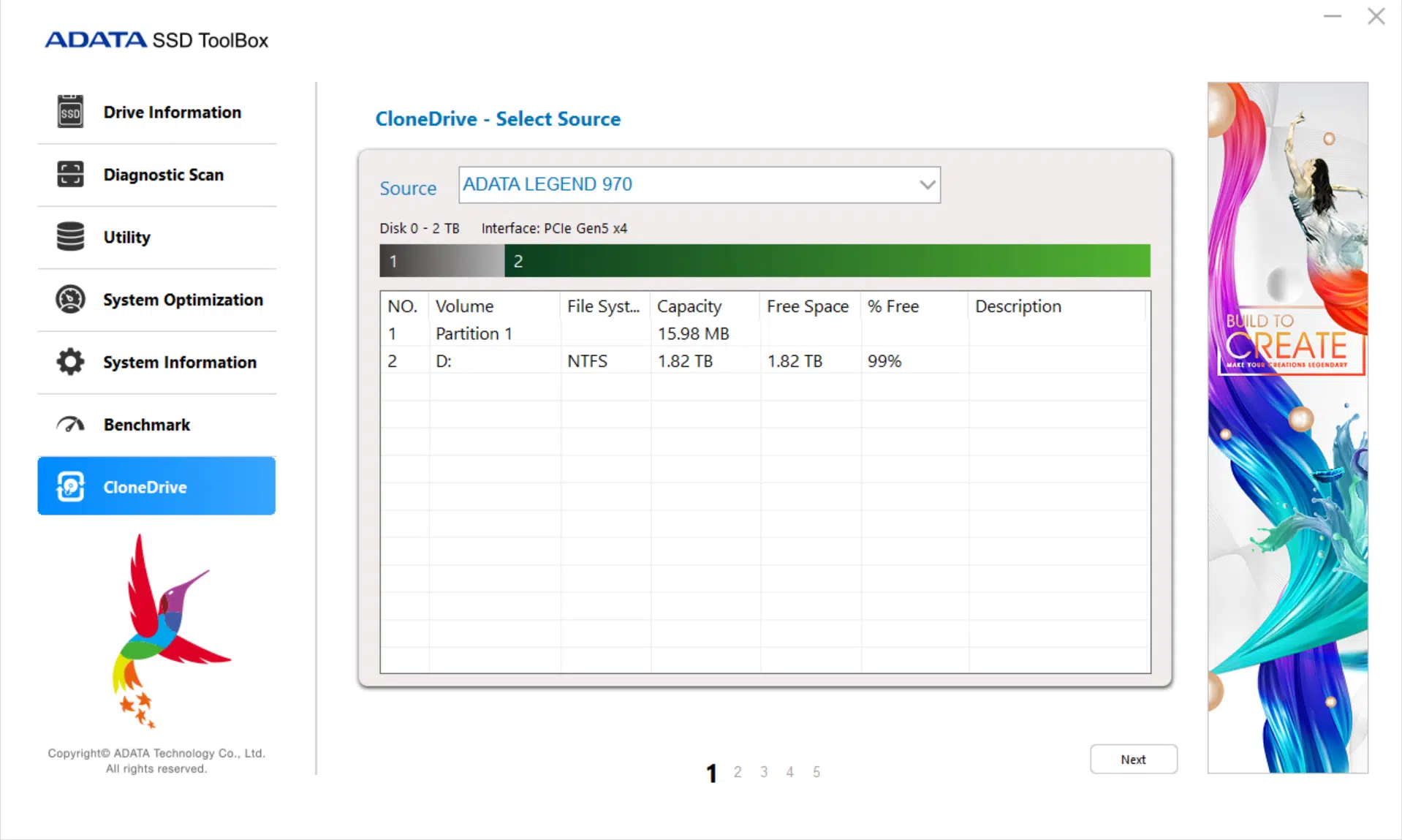

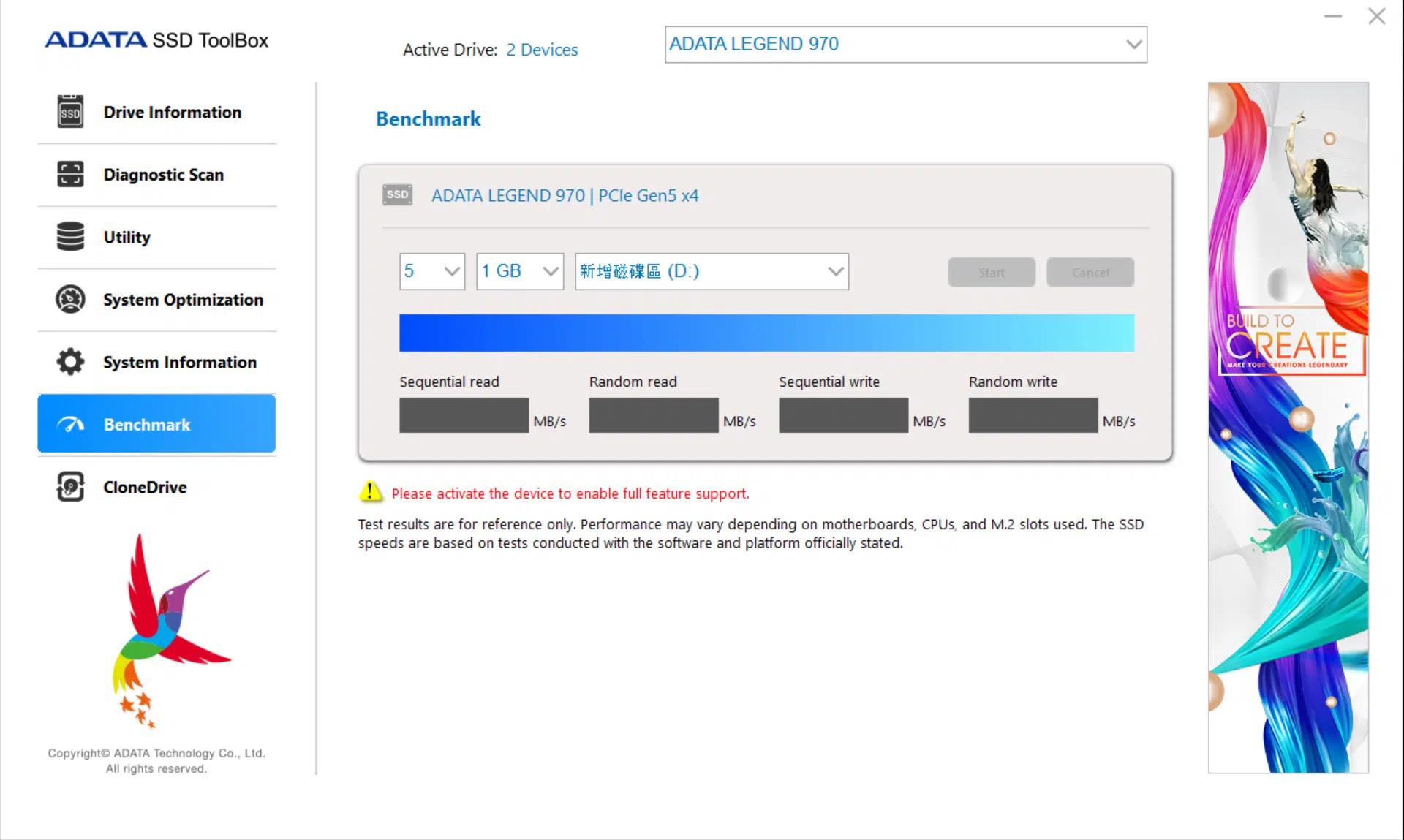

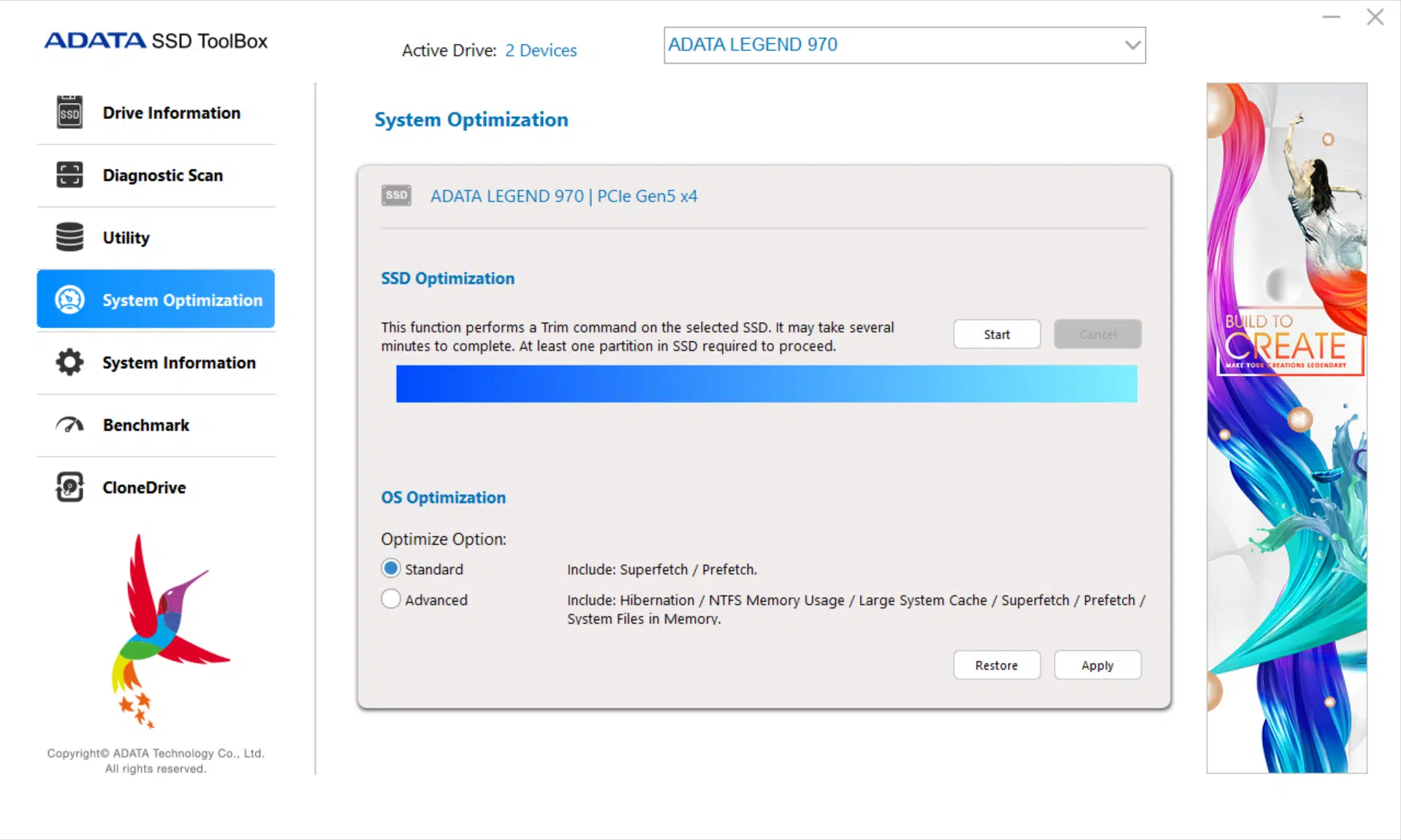

There is an SSD Optimization menu that allows you to enable Superfetch/Prefetch, as well as Hibernation/NTFS Memory Usage/Lare System Cache/System Files in Memory to optimize drive performance with Windows features enabled or disabled. There is also a built-in benchmark to check the SSD performance and track it over time. Lastly, the ADATA SSD Toolbox offers a CloneDrive feature allowing you to clone one SSD to another, or vice versa. This is a very handy ability, and it is built right into the SSD software, very nice.
