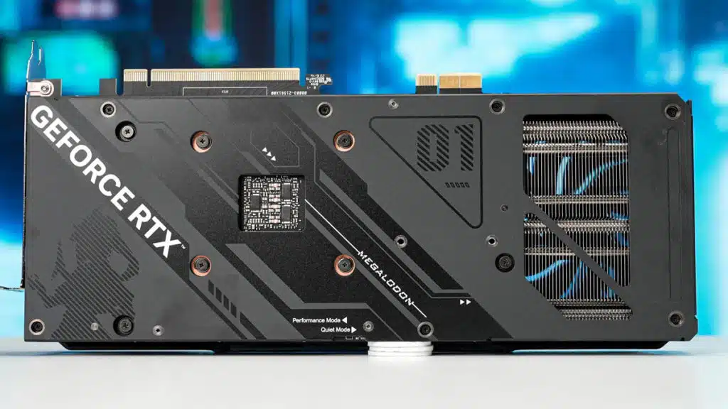

@momomo_us has shared what appears to be official documentation for HPCE, a new power connector that is capable of delivering more than 600 watts of power to graphics cards without cables. The schematics provided suggest that the connector is very similar to PCIe, with one diagram showing how the connector sits relative to the primary PCIe x16 slot when used on a motherboard. One page notes that this connector is already widely used in server products, meaning that this connector technically isn’t new, but consumers should be able to find it in upcoming products that include ASUS’ GeForce RTX 4070 BTF GPU.

Not sure about that but it is tied to the multiple stories we've had about ASUS over the last six+ months. The catch here is that it really just moves the connector for the PSU to the other side of the motherboard so you need to have a case/chassis that allows access to it. Beyond that, everyone would need to agree to a standard and do it. Additionally, though, 600W through a single port/adapter is not going to get rid of the issues we already have with 12VHPWR if not designed and implemented properly. I'm not saying this can't be a good thing but just that there is more to consider with it.

Here's the first leaked images of this design that ASUS showed off in a tour. The power for this connector is through a port on the backside of the mobo. The whole, "look ma, no cables" is a bit misleading. Unless I'm mistaken, it's not pulling through the PCB, it's just being rerouted.

That's not really a good example. They put a lot of other stuff on the back of that same motherboard. Most likely trying to display some sort of "no cables at all" visible on the front of the PCB.
If you look at the rear of that motherboard you can clearly see the 12VHPRW connector on the back isn't even directly behind/under this new connector but off to the side next to some other PCIE connectors and along the same edge as the ATX 24-pin connector as well as USB (maybe). While it also has SATA and other connectors on the back side of this motherboard.
ASUS was just trying to show off a completely cable-less build design.
The connector can be placed nearly anywhere on the motherboard, front or back.
