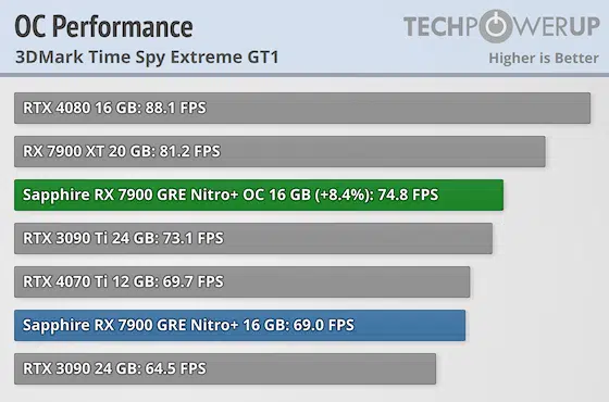

TPU on the Radeon RX 7900 GRE’s overclocking process, noting an “artificial limitation”:
  • To start, you have to raise the power limit to maximum, the slider ends at +15%
  • Next, max out the memory clock slider, it’s rather short, topping out at 2316 MHz, definitely not high enough to use the full potential of the memory chips.
  • Now, also increase “Max Frequency” to maximum, which is at 2803 MHz, not much higher than the default of 2530 MHz, another artificial limitation
  • At this point run a first stability test and record performance.
  • Now gradually lower the maximum voltage (default is 1.05 V), until your card becomes unstable, which happened for me at 0.89 V to 1.02 V, depending on the card.
  • Increasing the Min Frequency slider made no significant difference in performance. This might increase power consumption though for very little actual FPS improvement.
TPU’s OC findings:
Image: TPU
