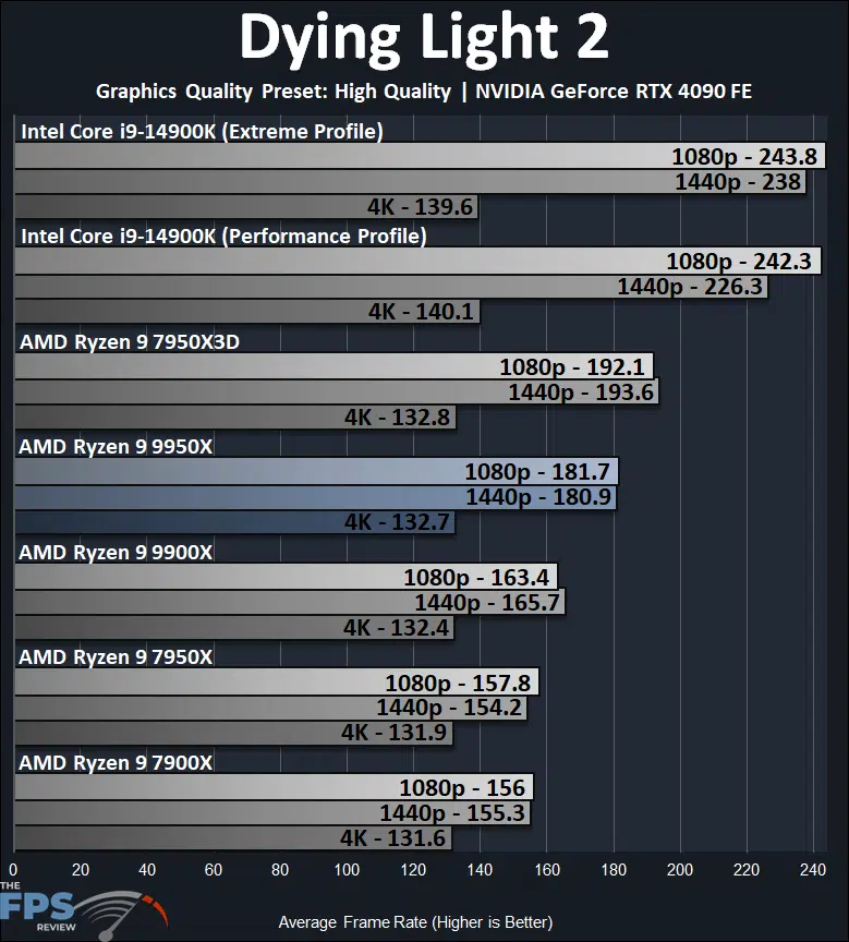

Dying Light 2
AMD Ryzen 9 9950X Dying Light 2 Performance Graph
Dying Light 2 is one game that we have found that shows differences well in the architecture. Notably, the Intel Core i9-14900K is in a league of its own in this game, with the absolute fastest performance that trounces everything else for some reason, even at 4K, which is odd, but there you go.
Otherwise, the AMD Ryzen 9 7950X3D comes in top for the AMD CPUs, with the best performance at 192 FPS at 1080p. We do see that it is bottlenecked at 1080p, as it has the same 1440p performance, and this is the case for all the AMD CPUs actually. The new AMD Ryzen 9 9950X is a healthy 15% performance uplift compared to the AMD Ryzen 9 7950X from the previous generation. This is the kind of performance uplift we had wished to see on more games, but have not. However, in Dying Light 2, there it is.
Comparing the AMD Ryzen 9 9950X to the Ryzen 9 9900X the AMD Ryzen 9 9950X is 11% faster, showing a nice advantage for the 9950X in this game. At this performance level, the AMD Ryzen 9 9950X is only 5.4% behind the Ryzen 9 7950X3D.
