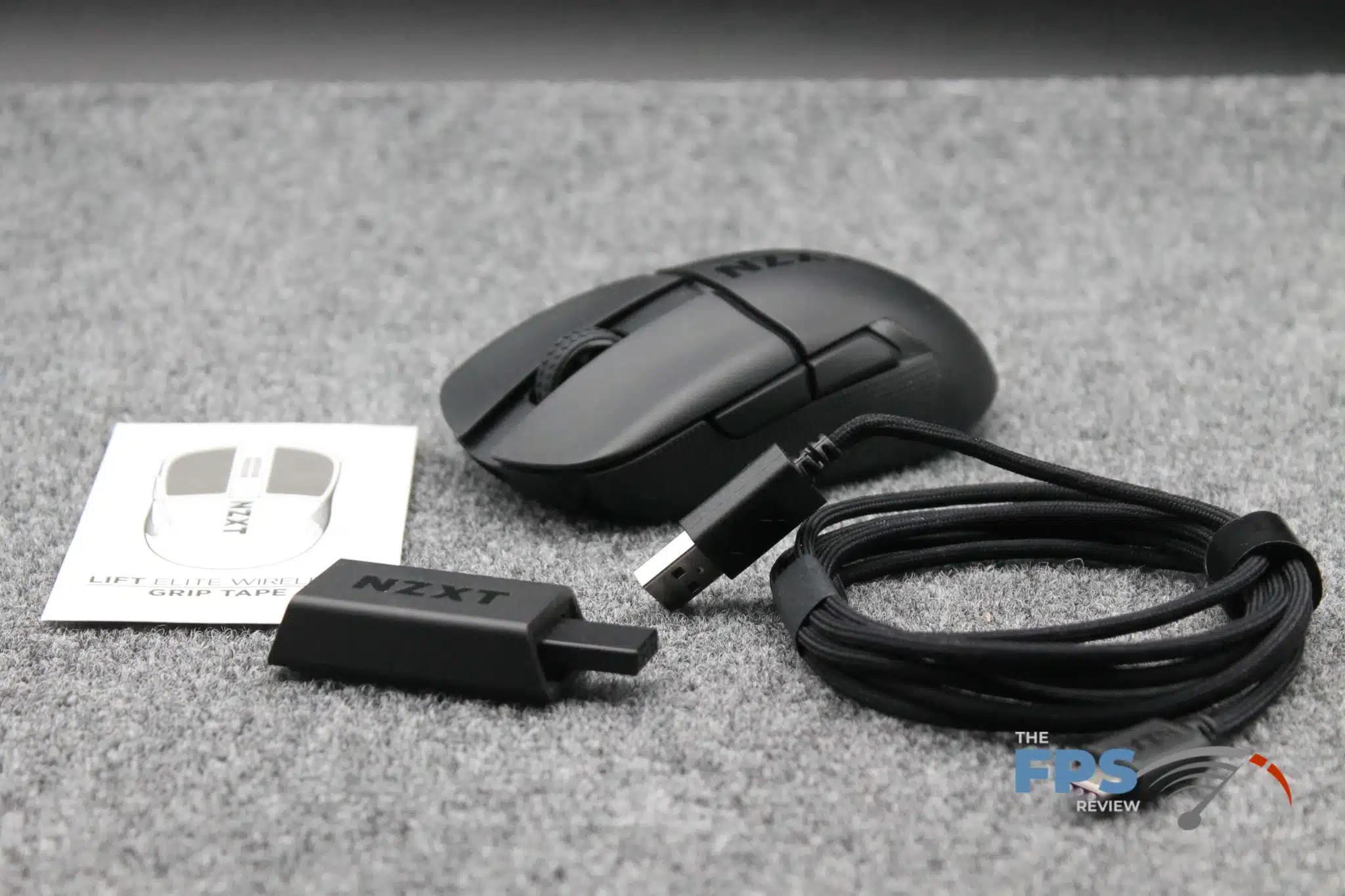

The NZXT Lift Elite Wireless mouse is packaged neatly and simply, as only the mouse itself, a USB-A to USB-C cable for charging, a receiver dongle, and a packet of grip tape were provided. The USB-A 2.4GHz dongle is located in a USB-C to USB-A sled so you can use the charging cable to connect the dongle directly or use the charging cable to connect directly to the mouse.

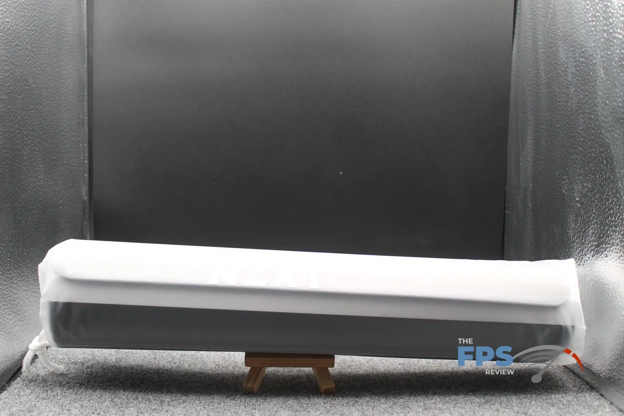

NZXT Zone Elite mousepad was a bit more straightforward than the mouse, as it was found rolled up within its box and inside a drawstring sleeve that could be used for future storage or transport.

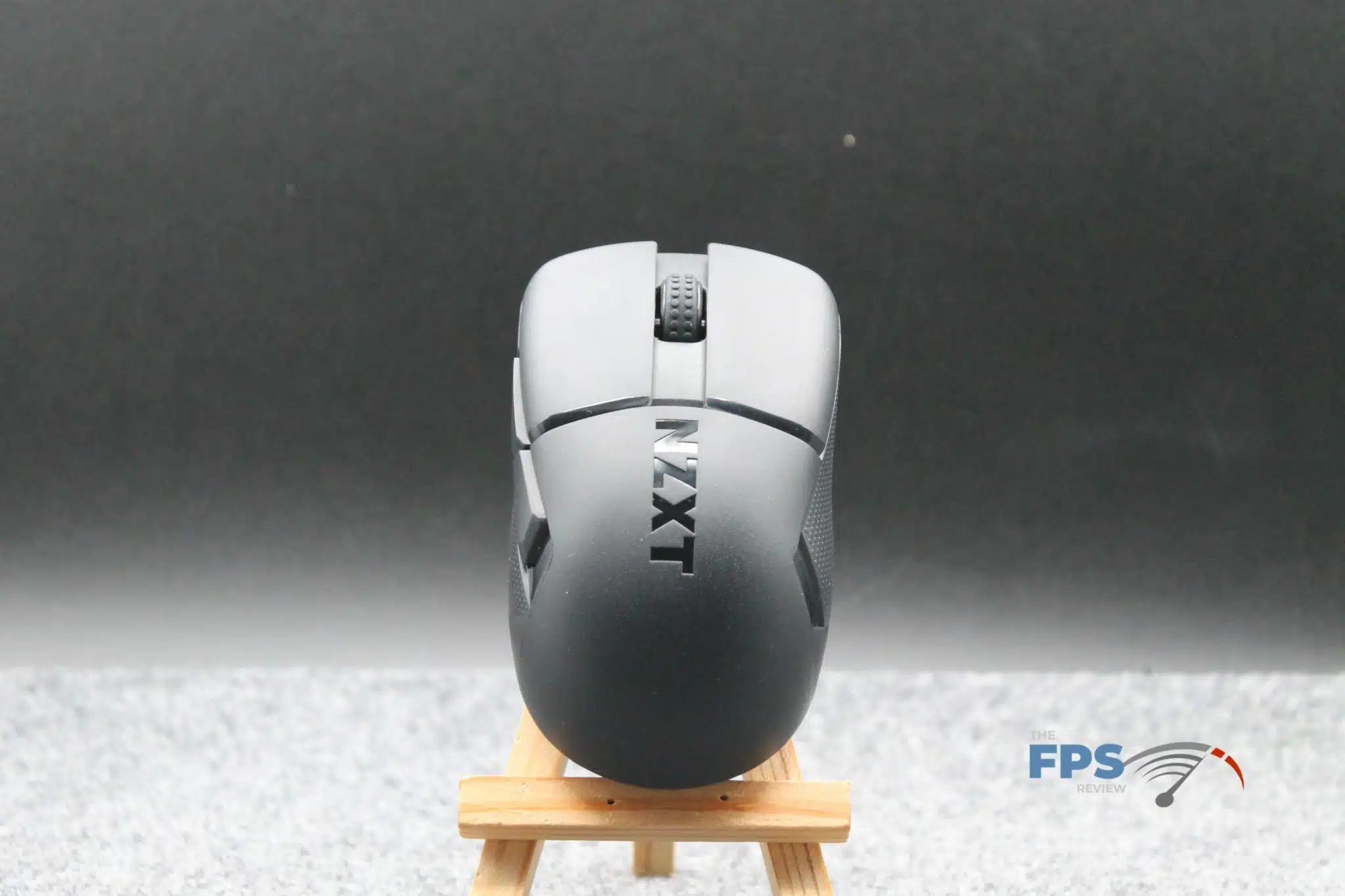

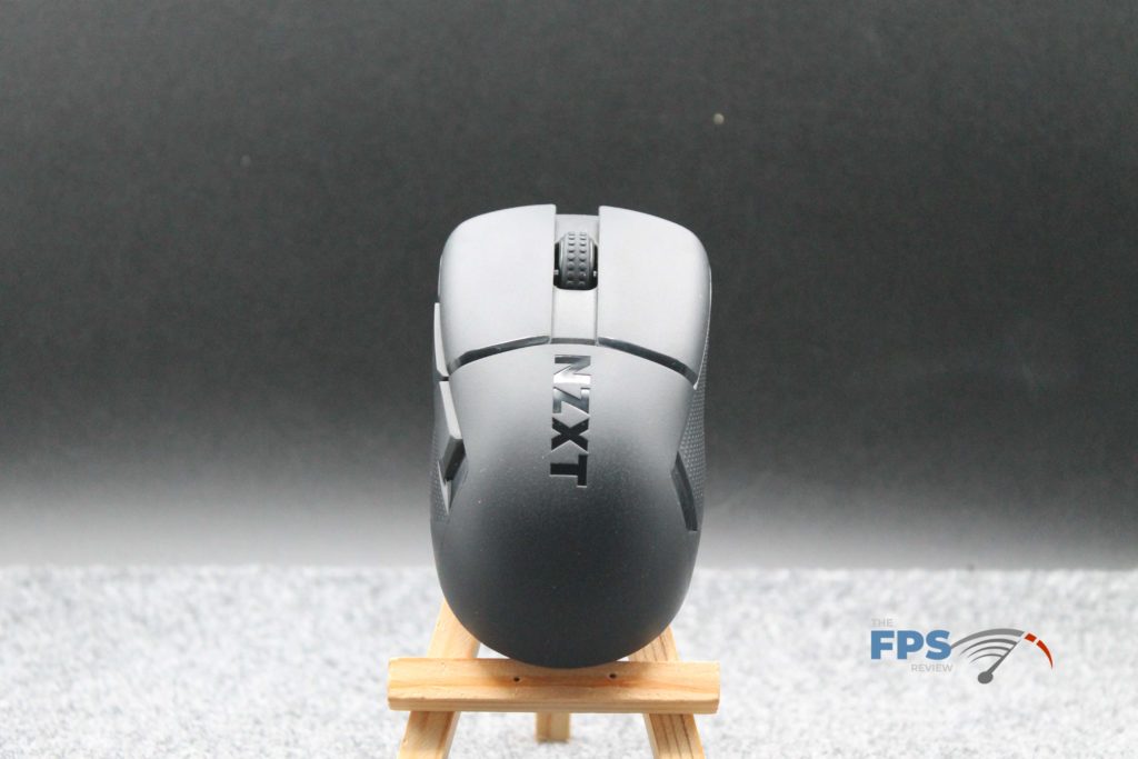

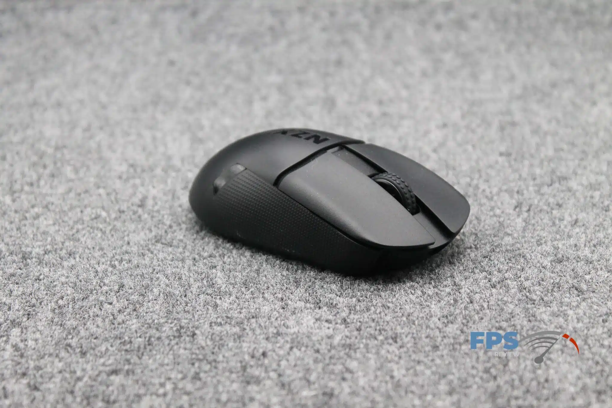

The Lift Elite Wireless Mouse is designed as a small, ultra-lightweight mouse that clocks in at a mere 57 grams (including the battery) and can operate both with a wire attached or wirelessly using its 2.4GHz dongle for up to 70 hours on a single charge. NZXT notes that the battery life quoted is for the 1,000 Hz polling rate and a higher polling rate will result in reduced battery duration (up to 4,000 Hz is supported). NVIDIA Reflex is also supported.

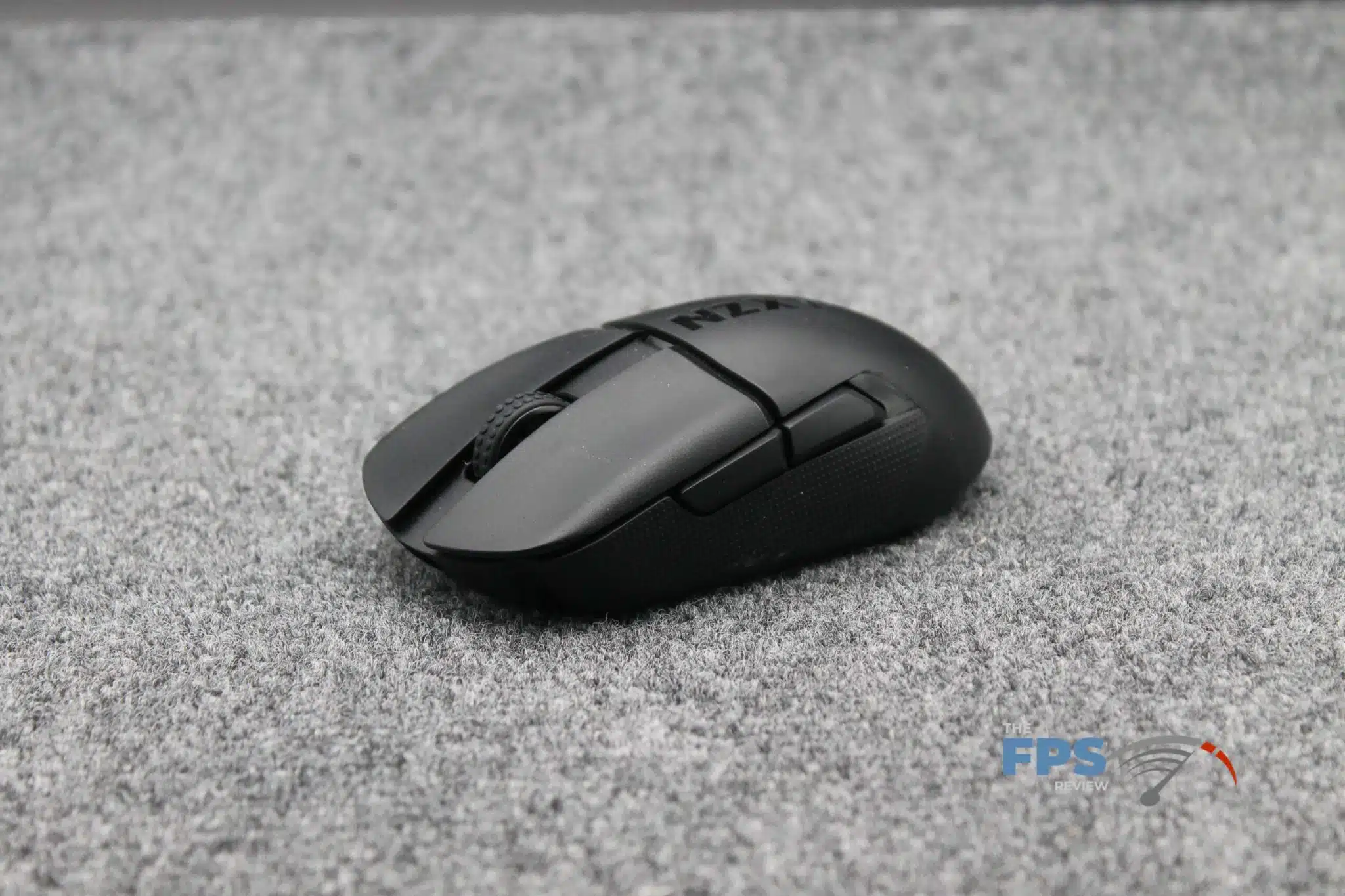

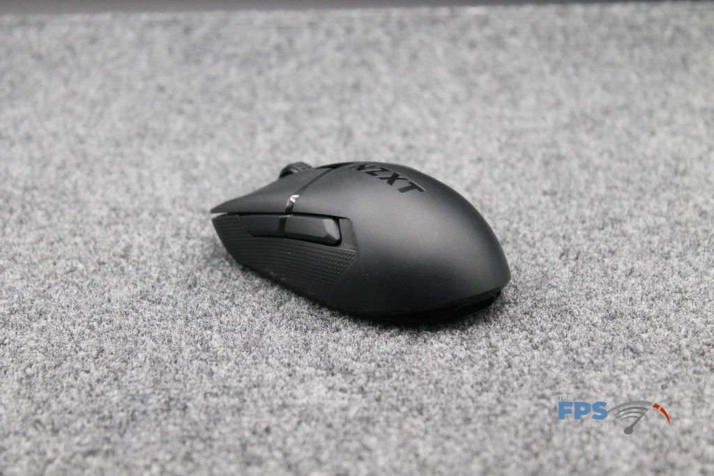

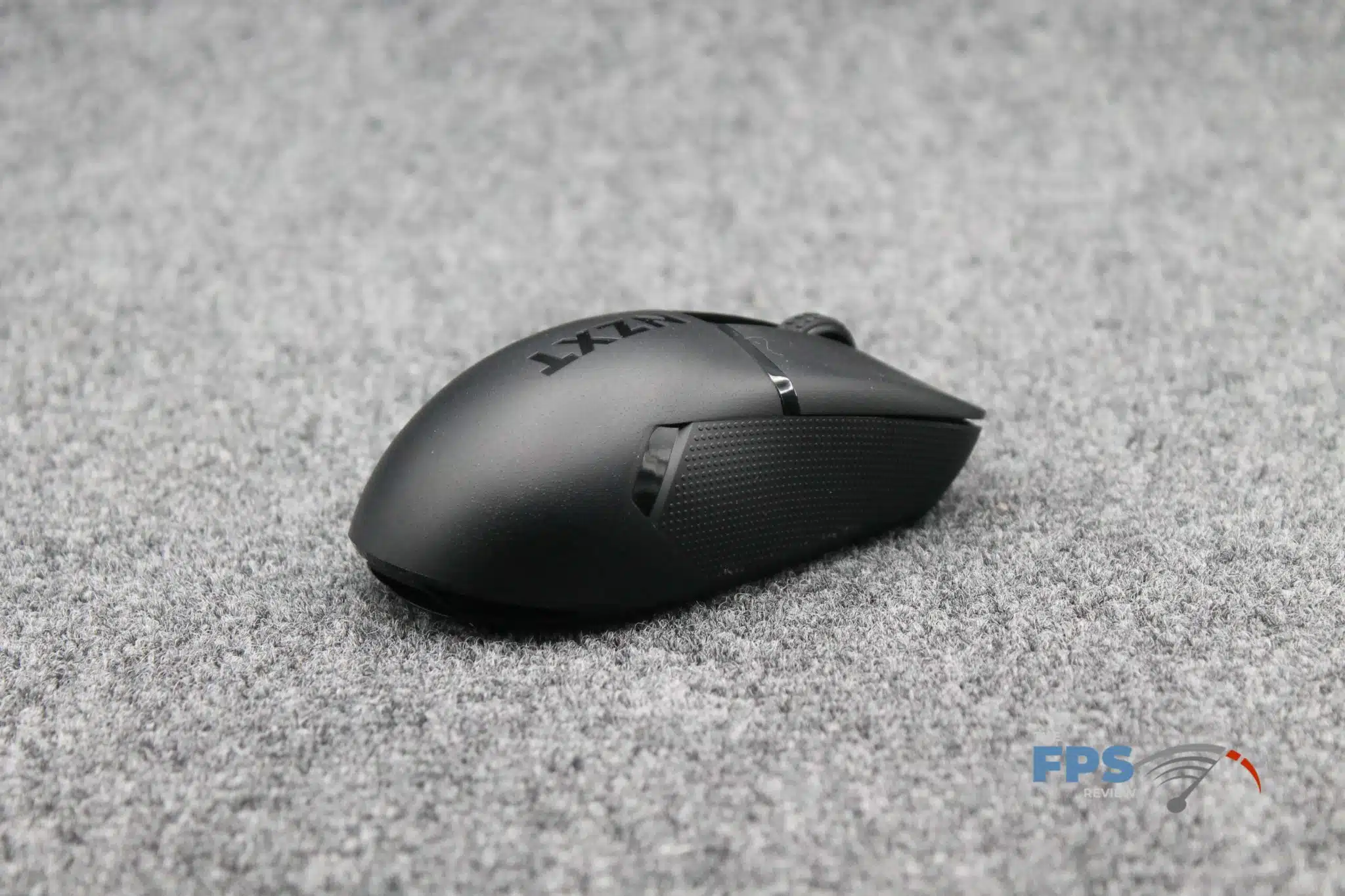

The mouse has a laser-etched rubber side body to assist with grip (that can be enhanced with the included grip tape) and is constructed using a double-injection molding to enhance grip and prevent peeling over time. According to NZXT, it sports a universal shape, however, with the forward and back buttons being located on only one side of the mouse, it’s probably going to be a difficult one for a left-hander to adopt.
Even though it is very lightweight, it has a significant amount of structural strength which is tested under 50 Newtons of force to confirm there will be no deformation or cracking of the mouse.

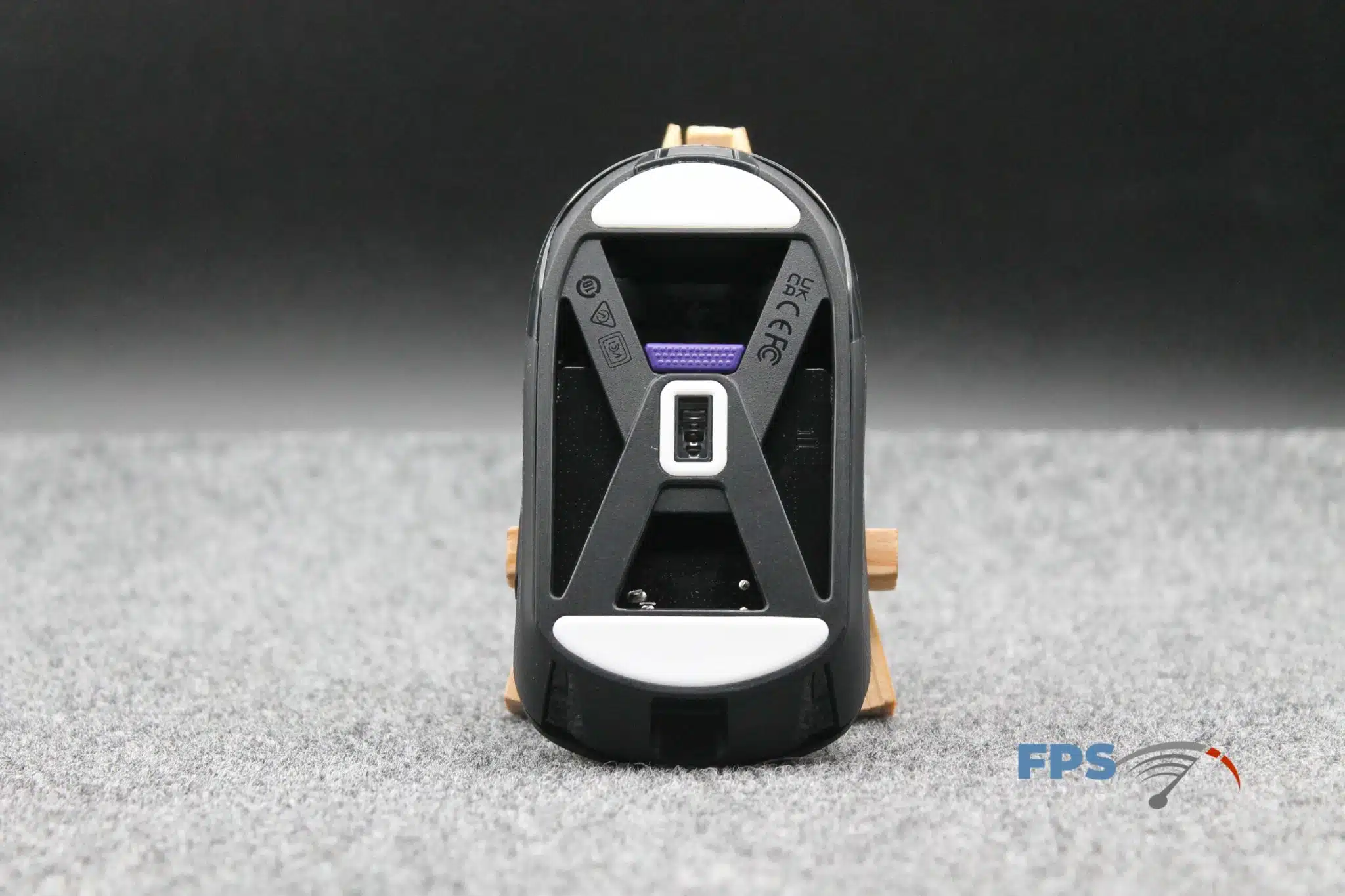

The triggers themselves are separate buttons from the main body and do not exhibit any play. The triggers are crisp and provide clicky feedback without much travel. Underneath, there are two PTFE mouse feet at the top and bottom and a button just below the sensor that is used for changing DPI profiles.

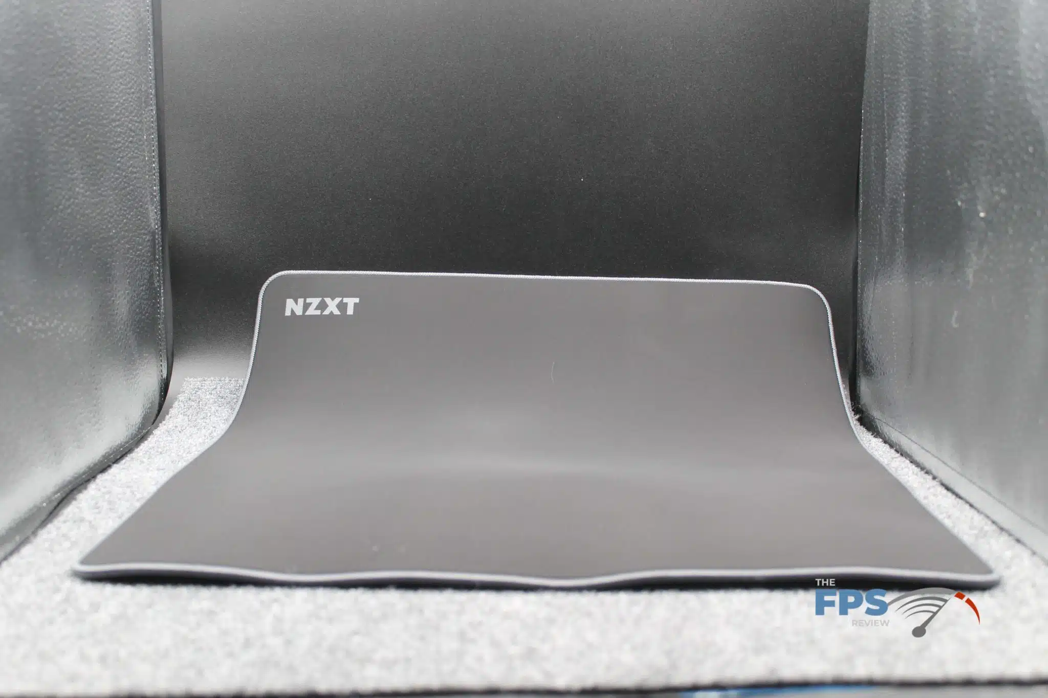

The NZXT Zone Elite mouse pad that we took a look at was the “Large” size, clocking in at 400mm x 400mm (for a $29.99 MSRP). It was certainly larger than my daily driver mousepad, however, it also happens to be the smallest of the three size flavors, with the Zone Elite XL weighing in at 400mm x 750mm ($44.99 MSRP) and the Zone Elite XXL at 400mm x 900mm ($54.99 MSRP).
The NZXT Zone Elite mouse pads feature a nano-kit fabric surface designed for fast, precise movements. It has a soft foam base to assist with stopping power and overall comfort. The underside has a secure grip coating that will help keep it in place, especially when you’re about to yeet something during your gaming session. The logo is purposefully minimalist to avoid interference with mouse movement tracking.

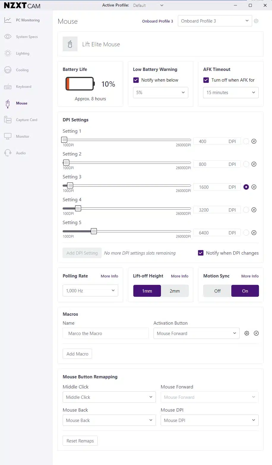

Like many gaming peripheral vendors, NZXT has developed a single application to allow for control and customization across their product range. NZXT CAM serves this purpose for the brand and supports the Lift Elite Wireless Mouse.
Button Assignment and Macros

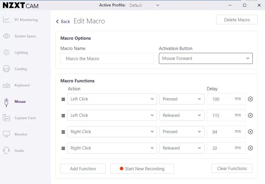

The mouse screen within the NZXT CAM software provides quick access to all the knobs and dials that are available to customize the mouse. It has the ability to store up to 5 DPI profiles on the mouse itself (so it can function sans software running while being controlled by the button by the sensor).
Battery life estimates, a low battery warning configuration, and AFK timeout are available to assist with power management. The polling rate, lift-off height, and motion sync configurations are available along with macros and button remapping features.
The Macro functionality allows you to manually configure or record macros and then assign them to mouse buttons for playback.

I really did not feel or see a difference in use between the wired connection and the wireless connection. For battery life, I did not have to charge the mouse during the week+ and I have been using it as my daily driver. NZXT also says that its initial charge can be fast, netting 15 hours of use from a quick 15-minute charge. As you can see from the screenshots though, I’m nearing the end of my first full charge as I’ve only got 10% left as I wrote up this review. This amount of battery life certainly exceeds my expectations for such a light mouse.
