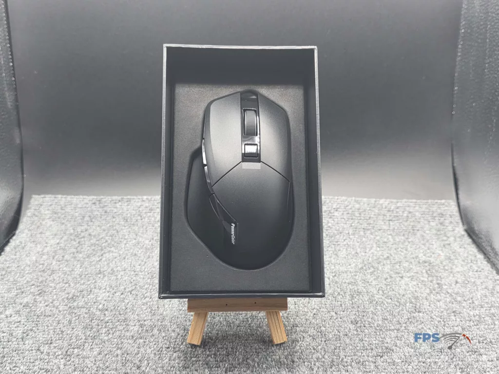

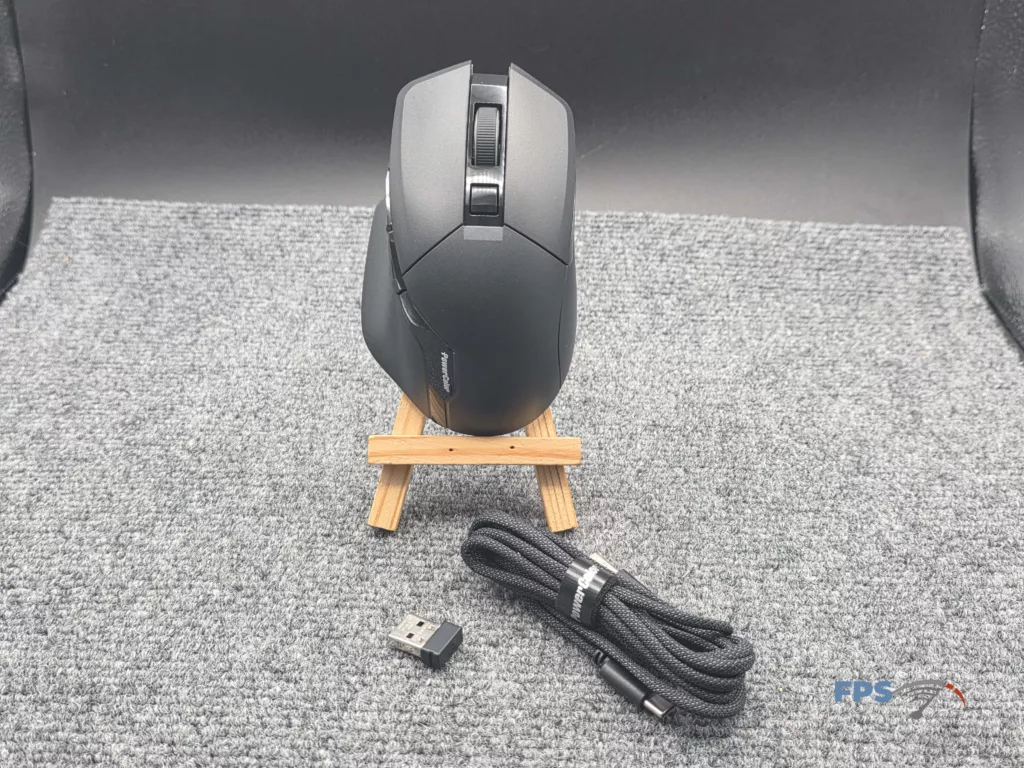

The retail box holds the mouse, the cable, and the 2.4GHz dongle. That is the lot. No grip tape, no spare feet, no dongle sled or extension adapter.
PowerColor flags in its own review guide that the 2.4GHz dongle performs best when it is not seated next to a USB 3.x port, and says a USB extender ships in the press kit specifically to avoid that interference. Ours did not include one. It turned out not to matter, since the front-panel USB ports on our test system put the dongle well clear of the rear I/O and did the same job, but it is worth knowing that the advice reaches the retail buyer without the part attached.

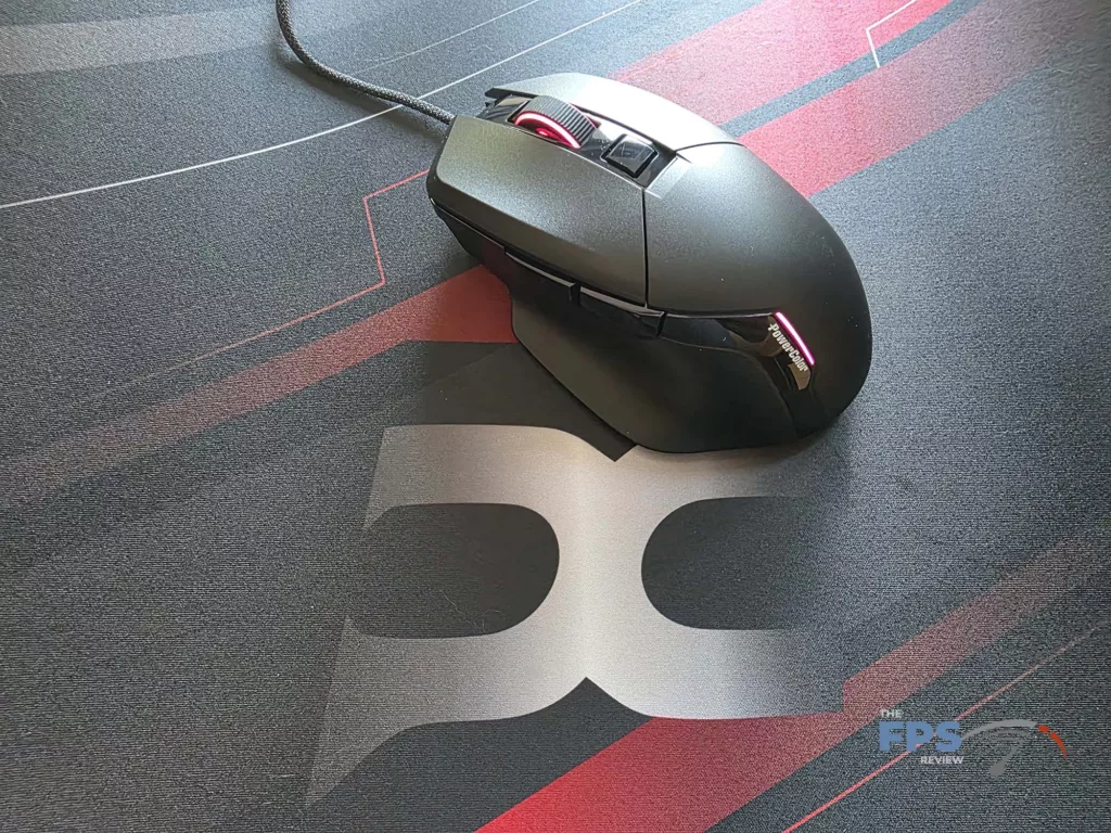

The cable is a 2.1m detachable paracord, USB-A on the host end and USB-C into the nose of the mouse. It doubles as the charge cable.

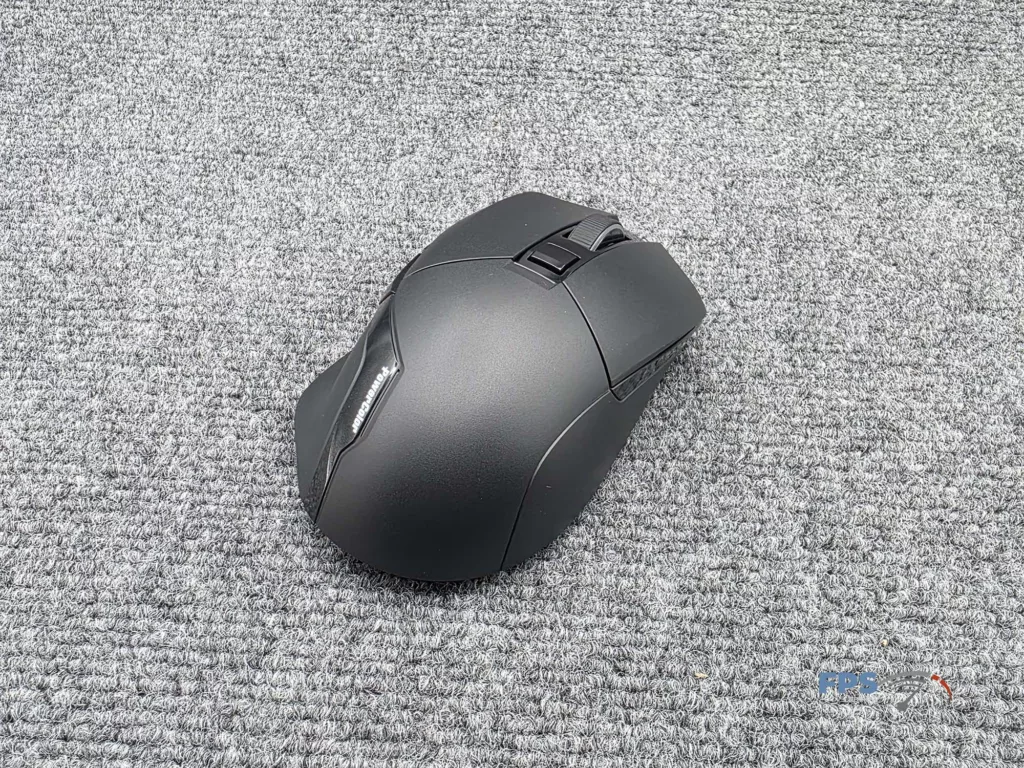

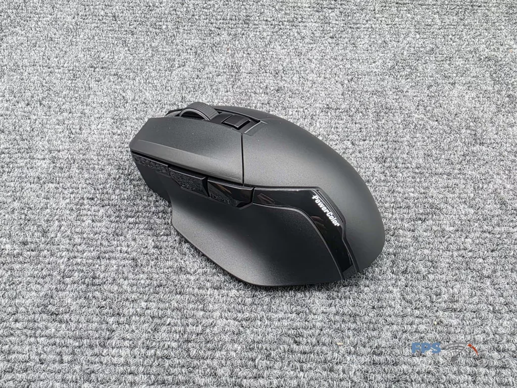

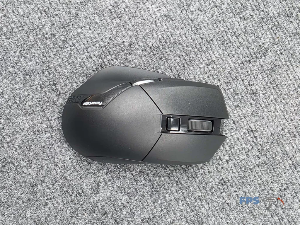

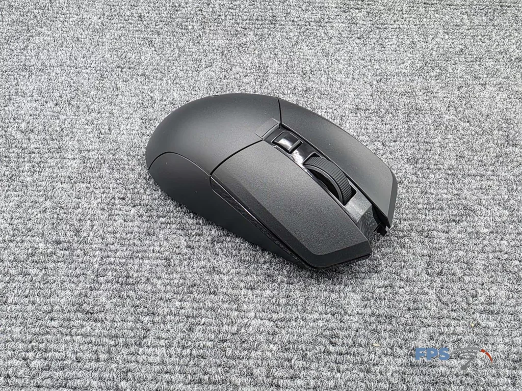

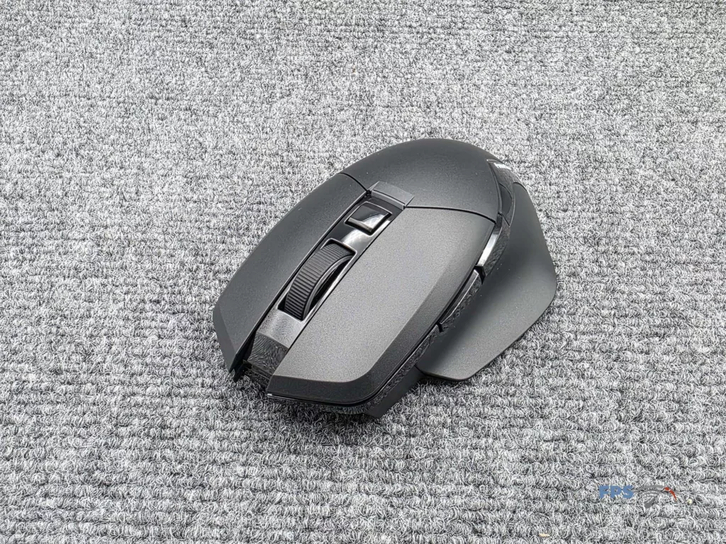

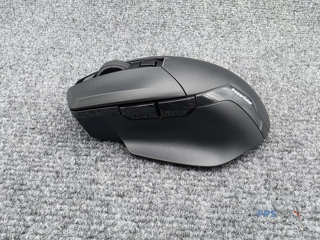

The AM10 is a full-size, right-handed ergonomic shell with a sculpted thumb rest and six programmable buttons, and PowerColor rates it at 95g. That is not ultralight territory, but it is light for a shape this size, which is most of the pitch: the footprint is closer to a G502 than to the honeycomb featherweights that dominate the sub-$50 wireless bracket.
PowerColor does not publish the shell material or the coating. In hand, it is a matte finish, and after a week of continuous skin contact, it still looked like it did out of the box, with no polishing or shine developing at the thumb rest or the click surfaces. The shell does not flex or creak under a firm squeeze. Whatever else PowerColor got wrong at launch, the physical construction was not it.

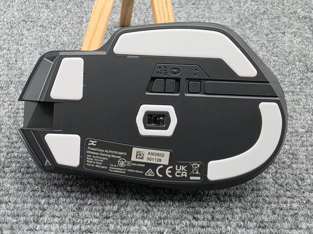

Underneath there are five separate PTFE feet of varying sizes rather than the usual two large skates, and a three-position slider covering wired (off), 2.4GHz, and Bluetooth, with a pairing button alongside. The slider is firm enough to stay where you put it, which sounds like faint praise until you have owned a mouse that switches itself off at an inconvenient time.
The side buttons sit on the left flank only, behind the thumb rest, so left-handed use is off the table.

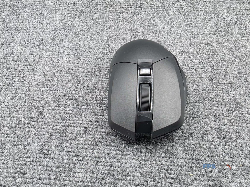

In use, the mains have moderate travel. There is no mushiness and no obvious slop, but this is not one of the near-zero-travel designs that competitive shooters have been drifting toward, and if you are coming off something with a very short throw, you will notice the difference in the first hour. From a sound perspective, the buttons make a muted, clicky sound.
The scroll wheel is good. Well-defined, no accidental double-steps, no complaints across a week of work. The one thing it lacks is a free-wheel mode, and that is the single feature I missed most moving over from my daily driver, the ancient Logitech G700s. Whether that matters depends entirely on how much of your day is spent scrolling through long documents.

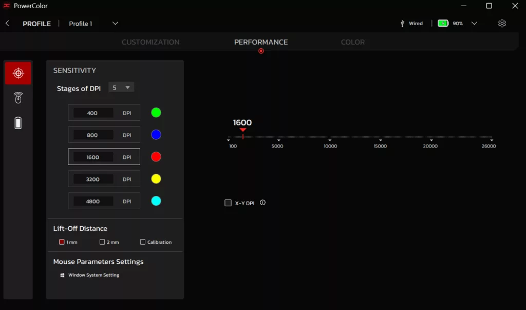

The Sensitivity page under Performance is the densest screen in the app. A Stages of DPI dropdown sets how many steps sit in the cycle, five in our configuration, and each step gets its own DPI value plus an indicator color, so the DPI LED tells you which stage you are on without opening anything. The slider runs the full 100 to 26,000 range, and any stage accepts a typed figure, so the stock 400 / 800 / 1600 / 3200 / 4800 ladder is a starting point rather than a constraint. An X-Y DPI checkbox splits horizontal and vertical sensitivity for anyone who wants it.
Lift-off distance is exposed as a straight choice between 1mm and 2mm, with a separate calibration option for tuning to a specific surface. Below that, a shortcut drops you into the Windows pointer settings, which is a small courtesy that saves a trip through Settings.

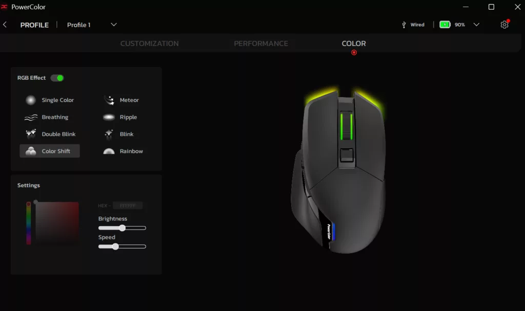

Lighting
The Color tab starts with a master RGB toggle and then eight effects: Single Color, Breathing, Double Blink, Color Shift, Meteor, Ripple, Blink, and Rainbow. A picker with a HEX field handles color, with Brightness and Speed sliders under it, and a live render of the mouse previews the result. For a single zone with 12 LEDs, eight effects is generous.
