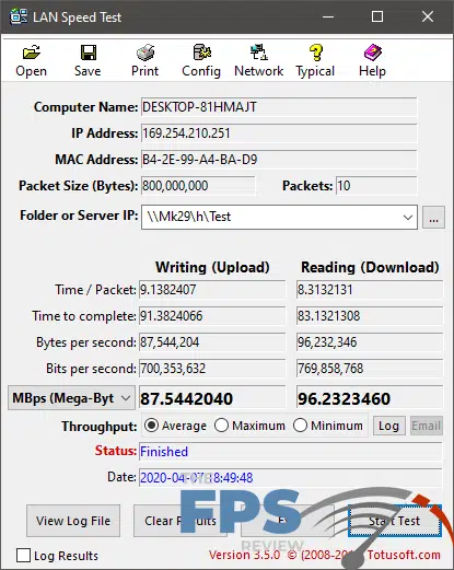

All said and done, we saw far better performance than we could have imagined for this controller. For the average throughput in the write test, we saw a result of 87.54MBps. For the read test, the GIGABYTE X570 Gaming X achieved an average result of 96.23MBps.

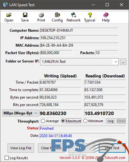

The maximum write speed was 90.83MBps while the read speed topped out at 103.49MBps. In contrast, the minimum write speed was 85.92MBps and the minimum read speed was 60.01MBps. CPU utilization was 4% in the write test and 3% in the read test. Again, very surprising performance out of a Realtek controller. I have no explanation for why it worked so well as these types of controllers are usually underwhelming.
