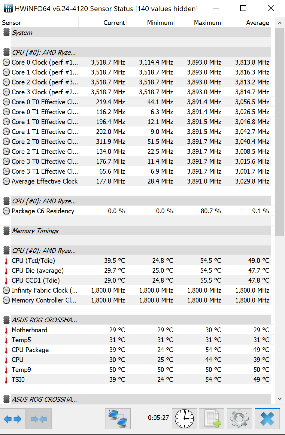

Clock Speed
The boost frequency on the Ryzen 3 3300X is 3.9GHz and the base is 3.6GHz. Below you will see what we experienced while running Cinebench R20 on all threads.
Note that Precision Overdrive was disabled. Our CPU reached a maximum of 3.893GHz. HWiNFO says the CPU Boost Max is 3900MHz. Therefore, we are hitting this max boost. The actual sustained clock speed for each thread as you can see was 3.891GHz, which is right in-line with where it should be when all cores are pushing full-load.

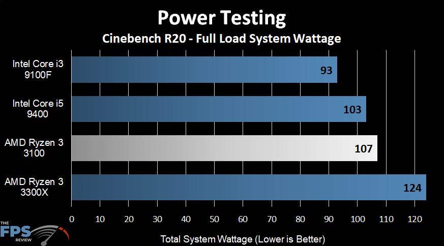

Power
In terms of total system Wattage at the wall, the AMD Ryzen 3 3100 consumed 107W running Cinebench R20. This sits right under the AMD Ryzen 3 3300X and only slightly more than the Core i5-9400. It is more power than the competing Core i3-9100F, but we will have to see how performance lines up.

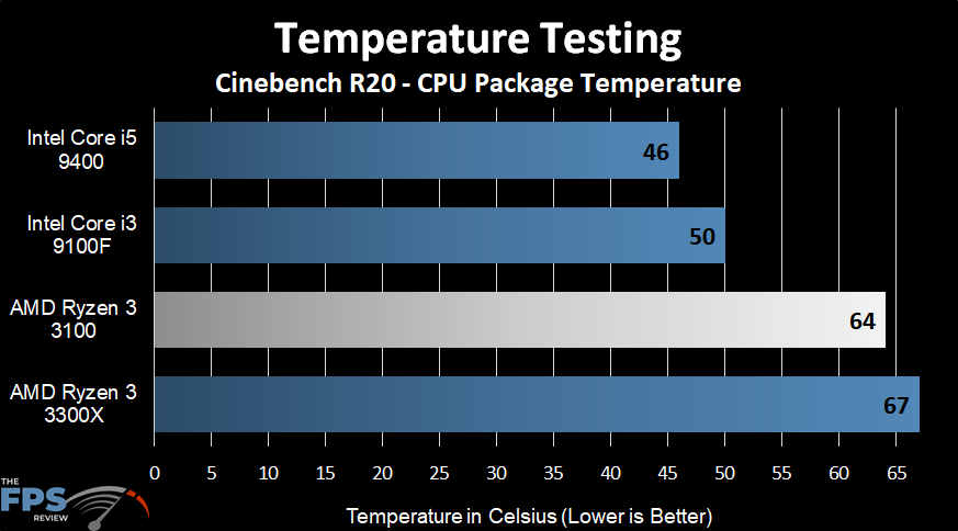

Temperature
For temperature we are taking the package temp reading in HWiNFO. Our Ryzen 3 3100 hit 64c in Cinebench R20. This is a few degrees cooler than the AMD Ryzen 3 3300X, but warmer by a long shot compared to the Core i3-9100F.
