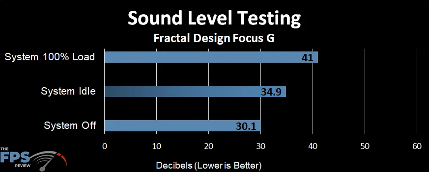

Noise Level
The noise level testing is straight forward and consists of three readings. The three readings are a baseline with nothing running, 10 minutes after the system has fully booted into Windows and finally peg the system at 100% on the CPU and GPU and record those readings after 10 minutes.
Here we can conclude that idle adds 4.8 dB of noise. It doesn’t seem like a lot, but I can definitely tell the computer is on without having to look at the power LED. If you plan on watching media without noise cancelling headphones, you’ll need to value having some background noise accompany the show.
Once we load the rig up, decibels jump by 10.9 dB over the off position. While 10.9 does not seem like a huge difference when between 30.1 dB and 41 dB, the logarithmic nature of the decibel scale means that it is twice as loud under load compared to being placed in the off position. If you’re gaming with speakers instead of headphones, just turn that volume on up to 11 and you’ll have no issues here.
