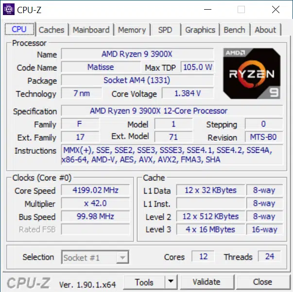

That being said, the motherboard performed very well in that I was able to easily clock the Ryzen 9 3900X to 4.2GHz all core. 4.3GHz was flat out not going to happen. However, using 1.3875v, I was able to manage the 4.2GHz clocks easily. I did have to max out LLC and increase thermal protection to 125c. Temperatures notwithstanding, the MSI X570-A PRO did its job.

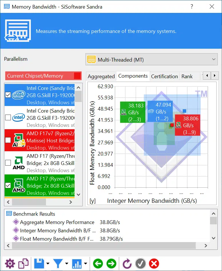

When it came to how the board performed, the numbers speak for themselves. The MSI X570-A PRO outperformed all the other X570 motherboards we’ve recently tested outside of thermals which is where all the concern lies. The VRM cooling implementation simply has to be run pretty close to the edge of what it’s capable of to handle the upper echelon of AMD CPUs. It limits the upgrade path one can take with this motherboard. As we’ve seen here, using a 12c or 16c CPU is possible, but it’s so far from ideal.
