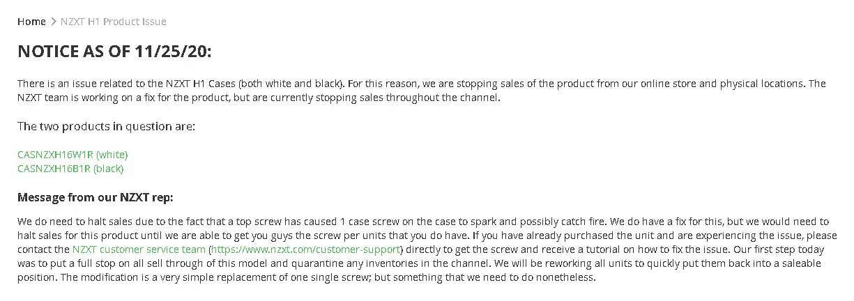

NZXT didn’t elaborate on what the actual issue is, but according to a message from a rep that was published by Central Computers, one of the screws can cause a fire. (The page has since been removed, but a cached version can be found here.)
“We do need to halt sales due to the fact that a top screw has caused 1 case screw on the case to spark and possibly catch fire,” NZXT’s rep wrote. “We do have a fix for this, but we would need to halt sales for this product until we are able to get you guys the screw per units that you do have.”
