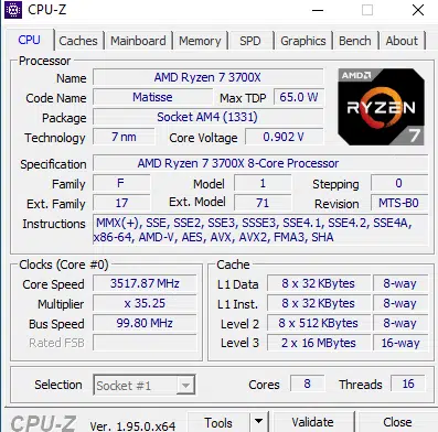

Default Clocks
Again we see, the default clock on the Ryzen 7 3700X is 3500MHz. It seemed to down clock from the normal default of 3600. A lot of the Ryzen 3xxx chips run at this base clock. Now let’s see what we can get this chip up to on this motherboard.

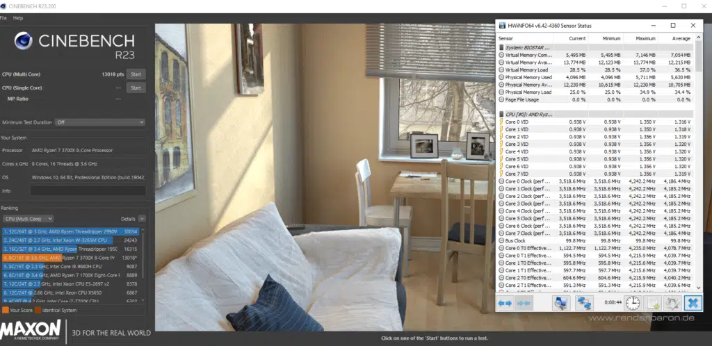

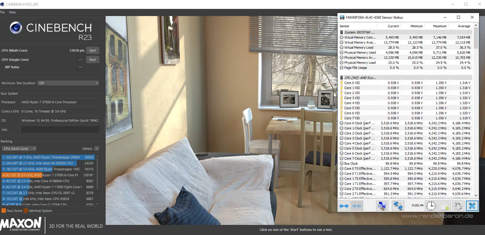

As we can see from the above Cinebench R23 picture, at the stock clock of 3.6 GHz we were able to score 13018. It boosted up to 4.242 GHz on all of the cores. Not too bad for being at the stock clock.

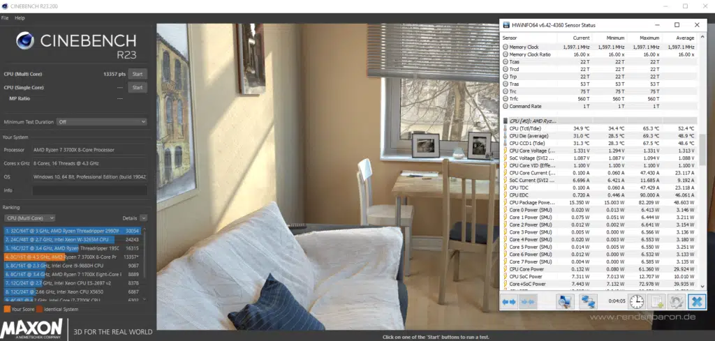

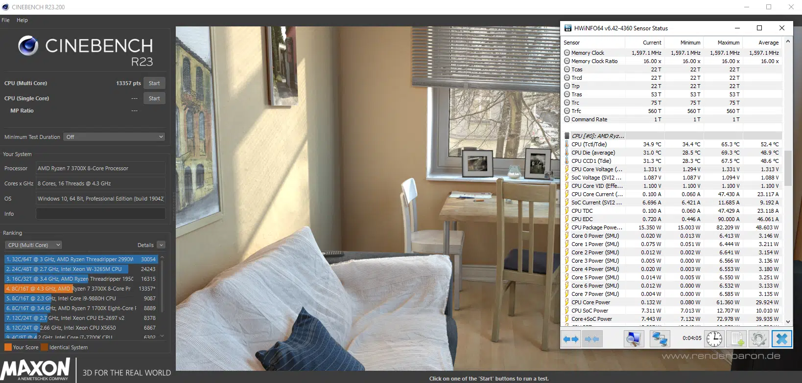

Next, we decided to manually overclock this chip and voltage. We figured we would start by trying an achievable 4.4 GHz. Unfortunately, it would not boot at this clock speed. We tossed 1.45 volts at the CPU and it still wouldn’t boot.
What I was able to achieve with this board, was 4.3GHz. I tried 4.35 and no matter what I tried, it would not boot and/or be stable at anything more than 4300 even.
At the best we could do, 4.3GHz, we received a Cinebench score of 13,357 which was close to 400 points below the recently reviewed MSI B550 GAMING EDGE WIFI.
