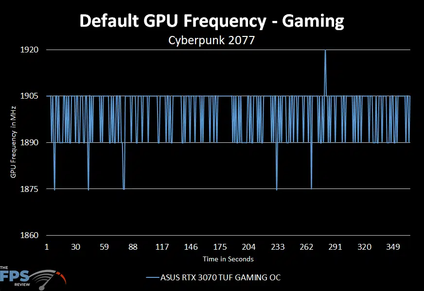

ASUS RTX 3070 TUF GAMING OC default gaming frequency over time
The ASUS RTX 3070 TUF GAMING OC Video card settled in between 1890MHz and 1905MHz during testing and maintained a temperature of 64 degrees Celsius. Comparing to the Founders Edition that averaged 1935MHz, the ASUS RTX 3070 TUF GAMING OC Video card came up a bit short even though it has a higher boost clock.  Memory in both the Founders Edition and the ASUS RTX 3070 TUF GAMING OC Video card is set to 14GHz using GDDR6 memory.

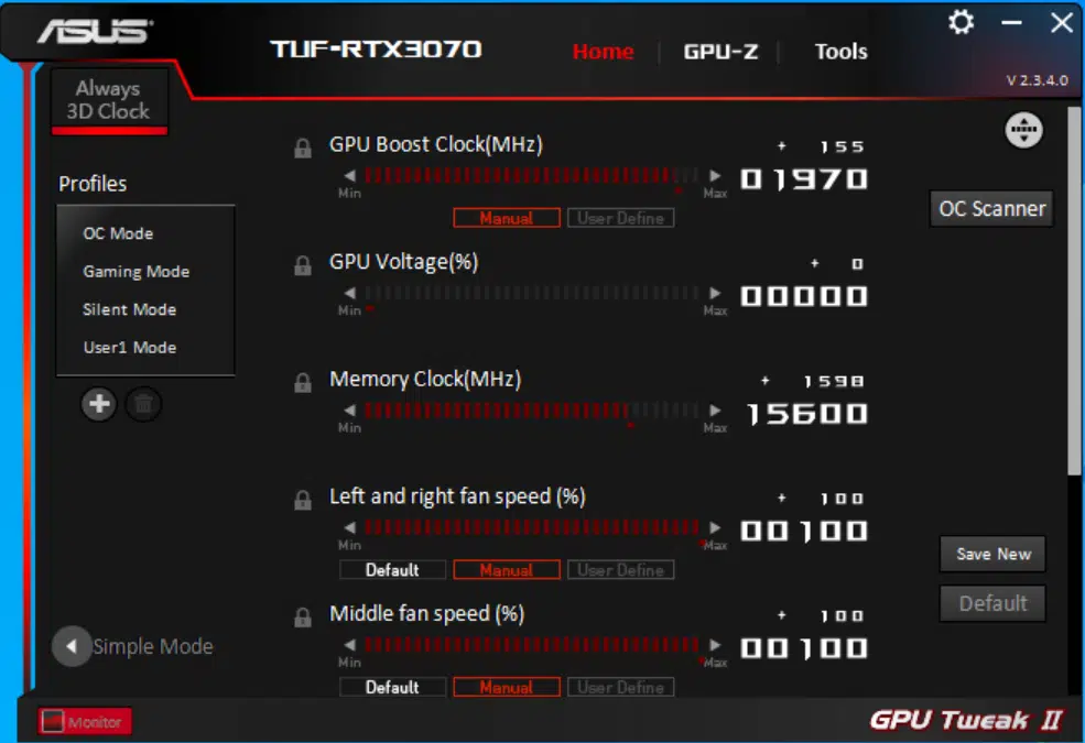

To dial in the maximum overclock for the ASUS RTX 3070 TUF GAMING OC Video card, we used ASUS’s GPU Tweak III software that makes lots of knobs to turn and levers to pull available for tuning enjoyment.

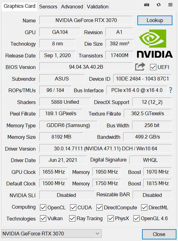

ASUS RTX 3070 TUF GAMING OC overclocked GPUz specs
We started by maxing out the Power Target and then cranked the fans up to 100%. There was not a knob present for modifying voltage, however, given the low power budgets on the RTX 30 Series that we have seen so far, adding voltage has not been necessary as it only increases power consumption and reduces how far GPU Boost will push the core clock speed up.
With the power matters settled, we started by pushing the core clock up as high as it could go without touching the memory side of the equation. We were able to pick up an extra 155MHz on the slider offset before we started crashing.
Next up, we set the core back to stock and boosted the memory to see how far we could take it. It appeared to be happiest at +800MHz (1600MHz effective). This is a boost to 15.6GHz GDDR 6 over the stock of 14GHz GDDR6.
Putting it all together, we first tried our max individual clocks together to see how it worked. This gave us a final stable overclock of 1655MHz core clock, 1970MHz boost clock, and 15.6GHz memory clock.

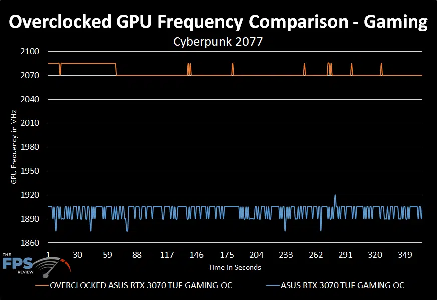

ASUS RTX 3070 TUF GAMING OC overclocked GPU frequency over time
Comparing the sustained GPU frequency to the stock frequency, we see that the observed overclocked frequency settled at 2070MHz. This is a 9.5% increase over the stock clocks and a 7% increase over stock Founders Edition performance. The memory at 15.6GHz is 11.4% faster than the stock clock as well.
