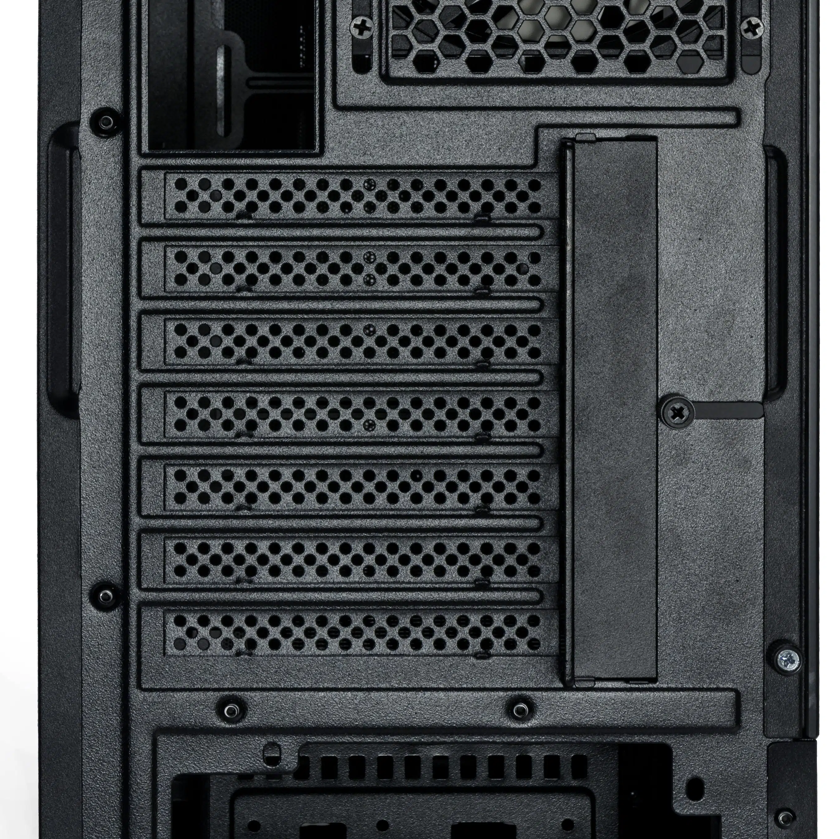

Unfortunately, the expansion slots are an exception to the otherwise solid construction. The disposable expansion slot covers are attached by spot-weld and there are no thumbscrews or spare slot covers included. Caution is advised when removing these, as they do present a hazard to users and to installed components during removal.
Expansion cards are somewhat secured from above with a sliding retention bracket that is secured with a single thumbscrew. As there are threaded holes for retaining expansion cards and holes left in the retaining bracket for screws, sourcing appropriate screws for heavier cards – or just for a measure of reassurance – is recommended.
And this leads to the first real disadvantage we found with FSPs CMT271A – the expansion slot panel at the rear of the case appears to be manufactured with the same flexible steel as the disposable expansion slot covers and lacks the rigidity of the rest of the case. The panel visibly bows when the disposable covers are removed, and along with the retention bracket supplied in place of screws for expansion cards, represents a cost-cutting decision that we feel cuts a little too much.

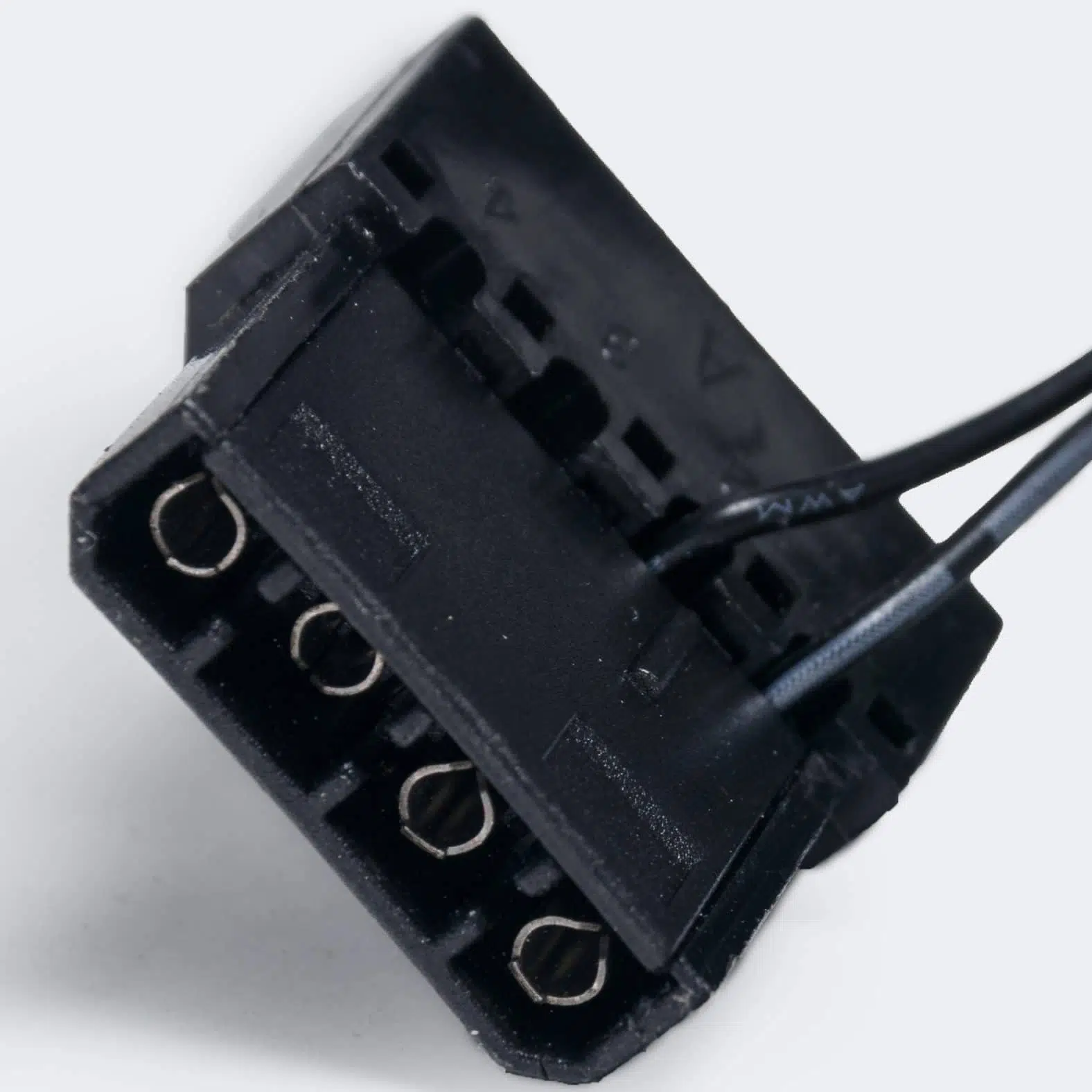

FSP has outfitted the CMT271A with one stock 120mm fan mounted in the single rear fan position. While a single stock fan is par for the course in this price class, the included fan has a large four-pin Molex connector instead of a traditional fan plug, preventing automatic fan speed control as well as fan monitoring. On the positive side, the fan will always run at full speed – and on the negative, the fan will always run at full speed. Thankfully the fan isn’t that loud.

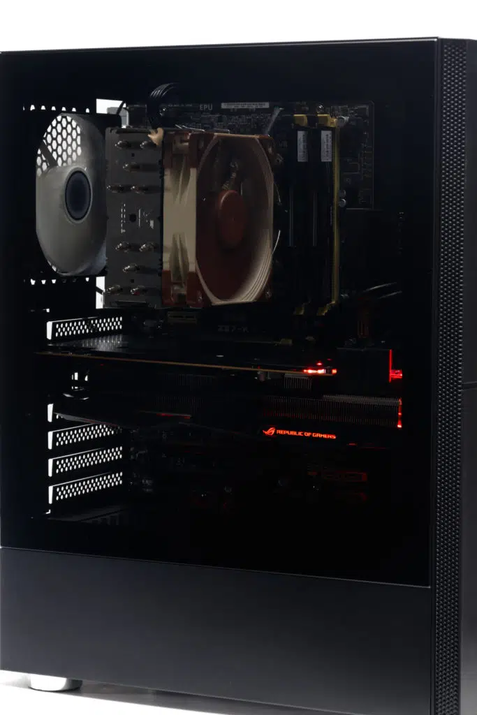

With a maximum CPU cooler height of 170mm, nearly all tower coolers on the market are covered, including the Noctua NH-U12A used for this review which Noctua lists as 158mm in height.
For liquid cooling, FSP recommends using the top fan positions if a radiator is desired. As there is very little vertical space between the top of the chassis and the top of the motherboard, builders are advised to be very careful with component choices as it is likely that a thick radiator and fan combination will interfere with motherboard DIMM slots and auxiliary power leads.

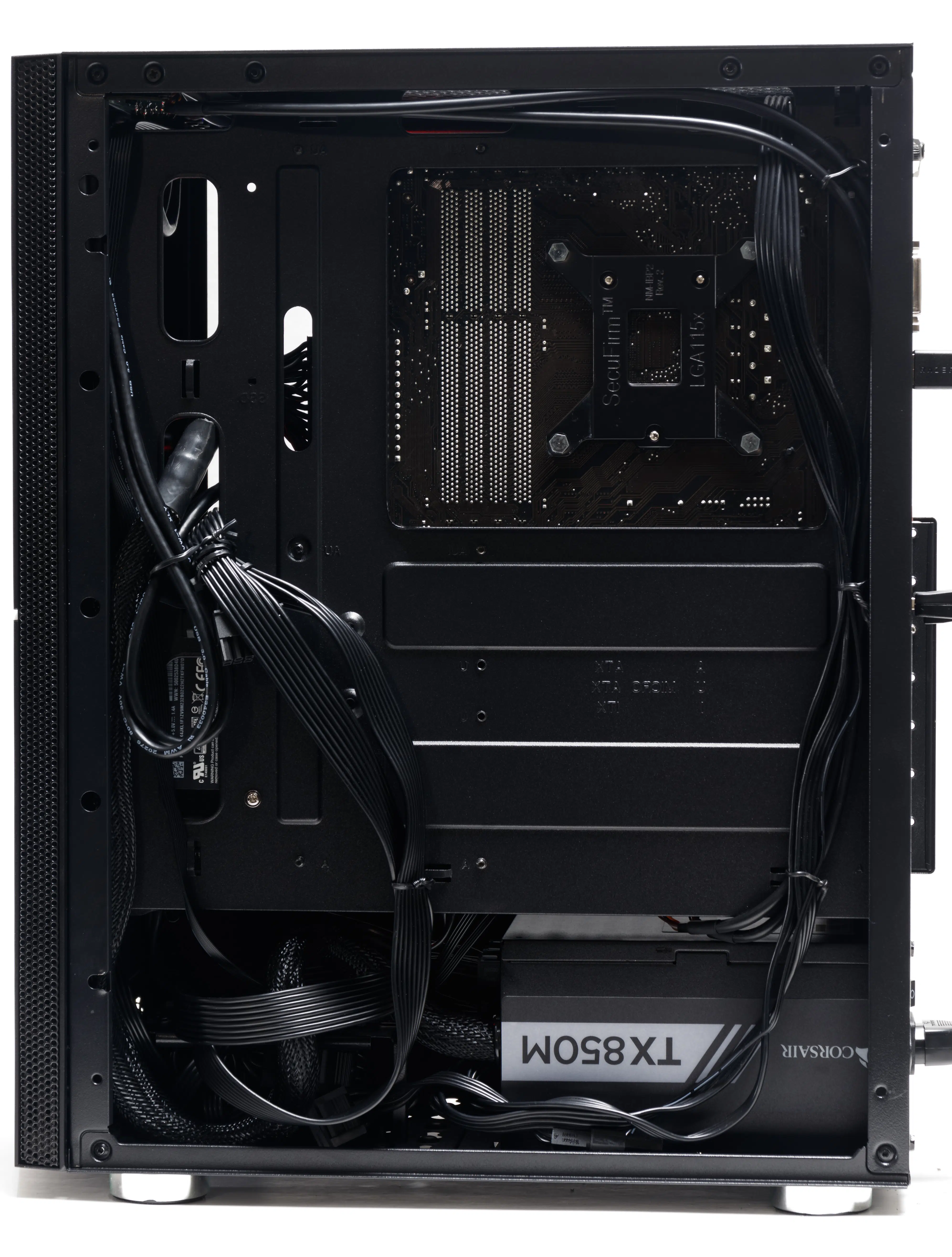

To help keep the motherboard compartment tidy, a pair of 180-degree 8-pin PCIe adapters and a 90-degree ATX adapter were used. This helped with the unruly power cables included with the entry-level Corsair TX850M, though this also results in having to unceremoniously bunch even more excess cabling in the PSU compartment.
In addition, it’s worth mentioning that the space behind the motherboard becomes cumbersome. FSP states that there is 20mm of space for cable routing behind the motherboard tray, and while that would indeed be plenty in most scenarios, for us this made the combination of the chunky 24-pin ATX cable, two 8-pin PCIe cables, and the always unruly USB3 cable a challenge to secure tight enough that the right case side panel may be closed without undue effort, let alone with a modicum of tidiness.
