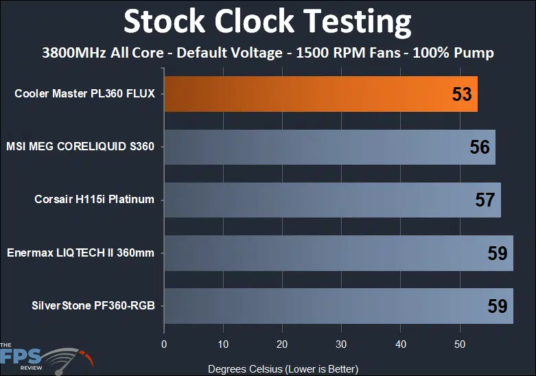

1500 RPM Fans – 100% Pump Speed
Cooler Master MASTERLIQUID PL360 FLUX - stock clock - 1500 RPM fan test results
Dropping the fans to 1500 RPM closed the gap a bit due to the fan speeds being set the same and eliminating that potential source of variance. The Cooler Master MasterLiquid PL360 FLUX remained in the coolest spot by a margin of 3 degrees Celsius. The rest of the crowd was not far behind.

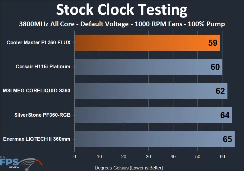

1000 RPM Fans – 100% Pump Speed
Cooler Master MASTERLIQUID PL360 FLUX - stock clock - 1000 RPM fan test results
Lowering the fans further to 1,000 RPM shook up the playing field in the rearview mirror. The Cooler Master MasterLiquid PL360 FLUX continued its winning streak at 59 degrees Celsius with the Corsair H115i Platinum nipping on its heels but still leading the other 360mm contestants by a couple of degrees. With the Corsiar pulling ahead, it’s likely that the placement change has more to do with 140mm fans being able to provide higher amounts of airflow at lower RPMs compared to 120mm fans.

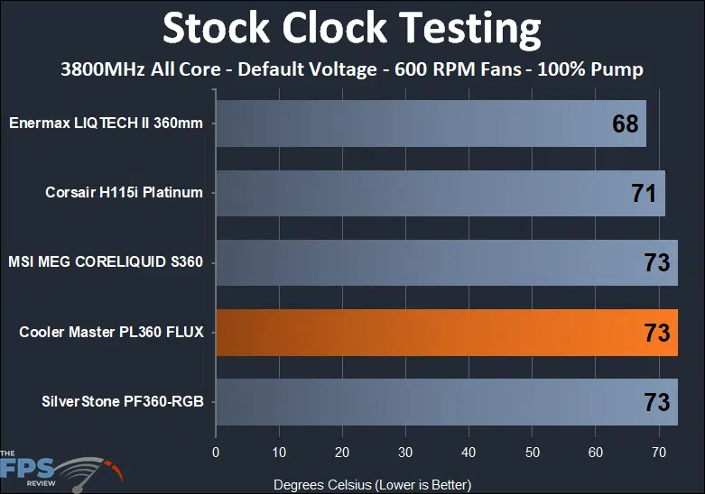

600 RPM Fans – 100% Pump Speed
Cooler Master MASTERLIQUID PL360 FLUX - stock clock - 600 RPM fan test results
Bringing the fans down to their lowest levels found the Cooler Master MasterLiquid PL360 FLUX to fall into a tie for last place with the MSI MEG CORELIQUID S360 and Enermax LIQTECH II 360 winning this match. Interestingly enough, we could not tell a difference in sound levels on the Cooler Master MasterLiquid PL360 FLUX between 600 and 1,000 RPM.
