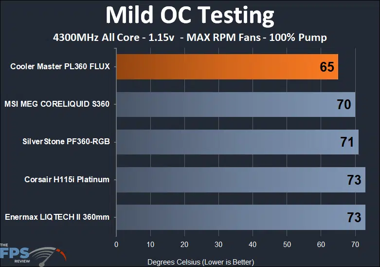

Mild OC Testing
For our Mild OC testing, we have configured our CPU to run 4300MHz on all cores, set the voltage to 1.15V, and configured memory to XMP mode. This yields an approximate power at the wall of 450w under load (a 350w differential from idle, which pulls about 100w). This results in the CPU running at 4.3GHz on all cores during the looping rounds of Cinebench R20. You can read more about this in our introduction article here.
Max Fans – 100% Pump Speed
Cooler Master MASTERLIQUID PL360 FLUX - mild OC clock - max RPM fan test results
Running our AIOs at full tilt allowed the Cooler Master MasterLiquid PL360 FLUX to chalk up a significant victory over there rest of the field, landing at 65degrees Celsius compared to the rest of the field landing in the 70-73C range.

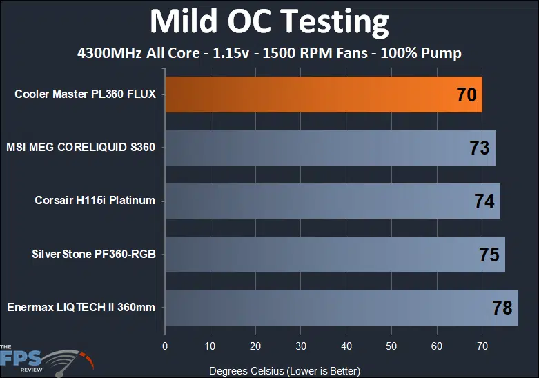

1500 RPM Fans – 100% Pump Speed
Cooler Master MASTERLIQUID PL360 FLUX - mild OC clock - 1500 RPM fan test results
Bringing the fans down to 1500 RPM had a similar effect as it did at stock clocks and the Cooler Master MasterLiquid PL360 FLUX continued to maintain its lead at 73C but at a smaller margin of victory.

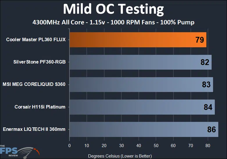

1000 RPM Fans – 100% Pump Speed
Cooler Master MASTERLIQUID PL360 FLUX - mild OC clock - 1000 RPM fan test results
With the fans set to 1000 RPM, the Cooler Master MasterLiquid PL360 FLUX maintained its cool at 79C, but still outperformed the rest of the field. Much like with the stock clock testing at this speed, we’re starting to notice that the sweet spot for performance is closer to 1500RPM.

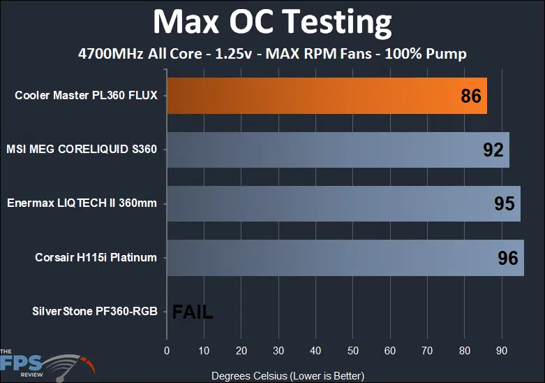

Max OC Testing
For our Max OC testing, we have configured our CPU to run 4700MHz on all cores, set the voltage to 1.25V, and configured memory to XMP mode. This yields an approximate power at the wall of 600w under load (a 500w differential from idle, which pulls about 100w). This results in the CPU running at 4.7GHz on all cores during the looping rounds of Cinebench R20. The only test that was completed without throttling was the Max Fans and 100% pump speed test. You can read more about this in our introduction article here.
Cooler Master MASTERLIQUID PL360 FLUX - max OC clock - max RPM fan test results
Setting our test bench to “large flaming blowtorch mode” showed that the Cooler Master MasterLiquid PL360 FLUX came out on top of all of the other contestants and gave us the best performance that we have ever seen here.
