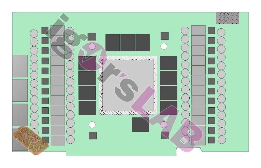

Were you expecting NVIDIA’s next flagship gaming graphics card to feature even more memory than the already impressive amount utilized in the GeForce RTX 3090? That’s unlikely, according to Igor Wassollek, which shared a drawing today of what is supposedly the reference PCB design for AD102, the GPU in charge of powering the upper echelon of the new GeForce RTX 40 Series. A dozen solder slots for GDDR6X can be seen in the image, which implies support for up to 24 GB of memory (Micron’s options are available as either 1 or 2 GB modules).

[…] what we see at first glance are a whopping 24 voltage converters for the GPU! Since NVIDIA (this has also been leaked in the meantime) will again rely on a uP9512 that can only generate 8 phases (but is readily available), a total of three voltage converters will most likely be driven together per phase. The four dark rectangles near the drill holes for the cooler should be the VRM for the memory voltage converters. This brings us to four phases for the GDDR6X.
What we also see in this context is a maximum of 12 solder slots for the GDDR6X (from Micron), which is currently available as 1 and 2 GB modules. From this, we can conclude that 12 or 24 GB (more likely) are possible when fully loaded. Smaller versions could then be equipped with 8 or 16 GB (probably) again, which should also reduce the number of voltage converters to three.
