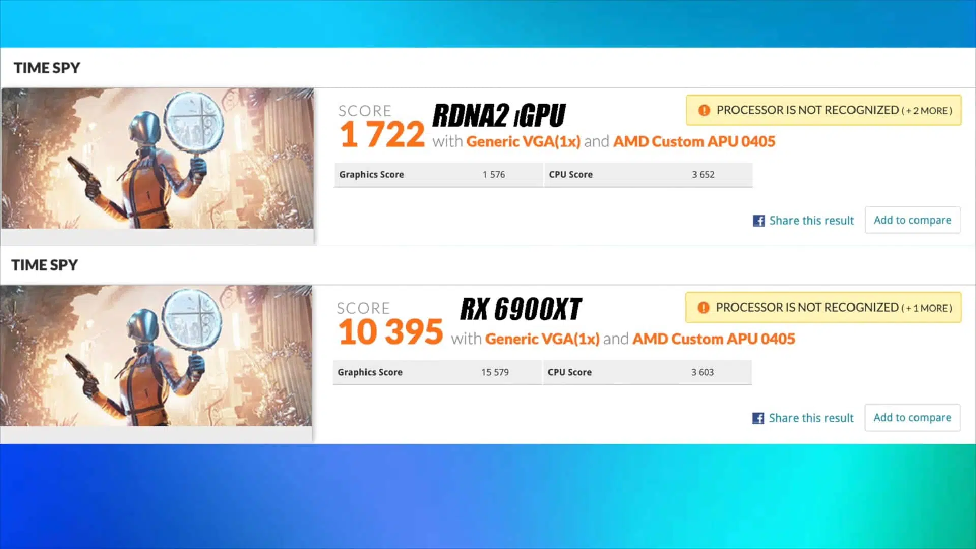

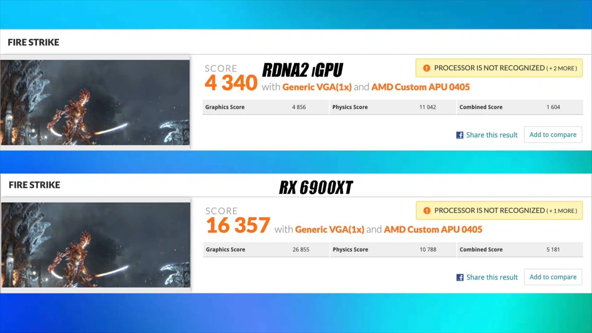

There are some bottleneck issues with the Steam’s APU, but the benchmarks are still pretty impressive. Some of the varying framerates were due to using the M.2 slot for the GPU.
