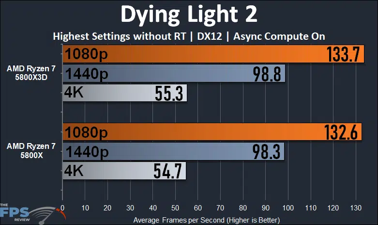

Dying Light 2
In Dying Light 2 we are running the game at the highest graphics settings but without Ray Tracing. We are running in DX12 with Async Compute, and we use a custom manual run-through.
AMD Ryzen 7 5800X3D Dying Light 2 Graph
The performance results are very close in Dying Light 2 between both CPUs. If you want to say the Ryzen 7 5800X3D is faster, you can say that it technically is, but only by the smallest of margins. There aren’t any large or noticeable performance differences here at all. At 1080p is the largest difference, where the Ryzen 7 5800X3D is just 1% faster than the Ryzen 7 5800X. The results only get smaller from there, with 1440p and 4K being nearly identical, and within the margin of error for a manual run-through. In this game, it doesn’t matter which CPU you use, the performance will be the same.

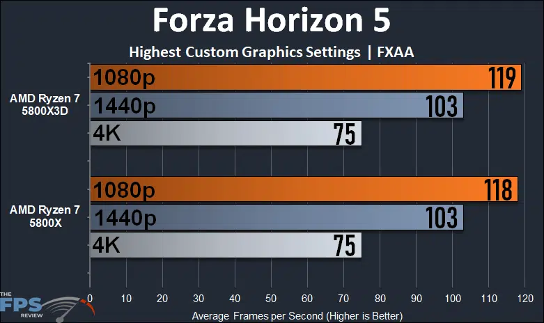

Forza Horizon 5
AMD Ryzen 7 5800X3D Forza Horizon 5 Graph
In Forza Horizon 5 we are running the game at the custom highest possible in-game settings with FXAA. We see only a 1FPS difference at 1080p between the CPUs, and no difference at all at 1440p or 4K. This game performs exactly the same between both CPUs.
