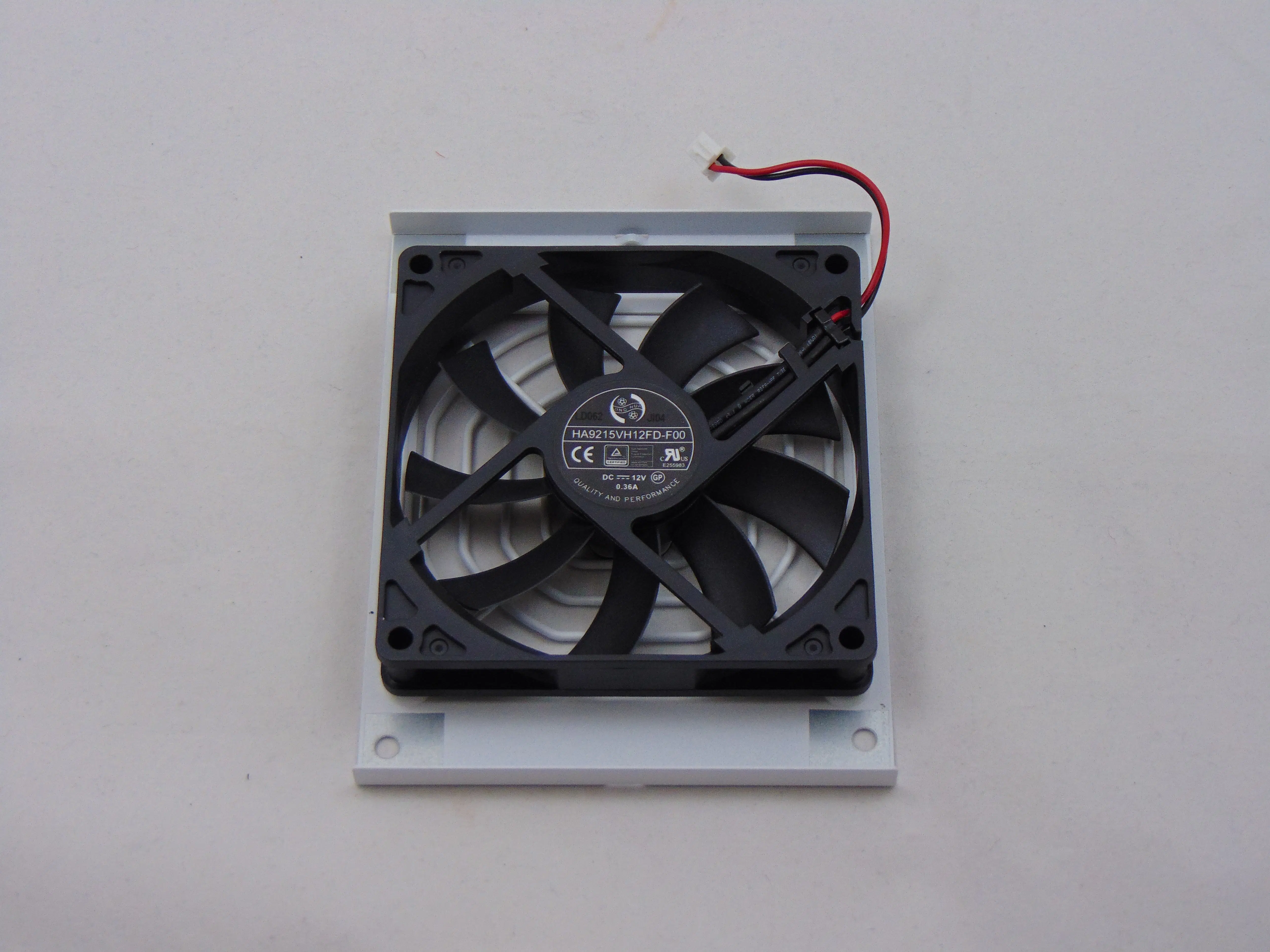

As we already know the Cooler Master V850 SFX GOLD WHITE Edition features a single 92mm fan design that is similar to the preferred 80mm cooling solution by some brands. The major downside to this fan design is that to move a sufficient volume of air to cool a high output power supply it must spin very fast resulting in elevated noise levels. While these 92mm designs are not great for quiet computing environments the key criteria in our evaluation is whether or not the cooling solution is sufficient.

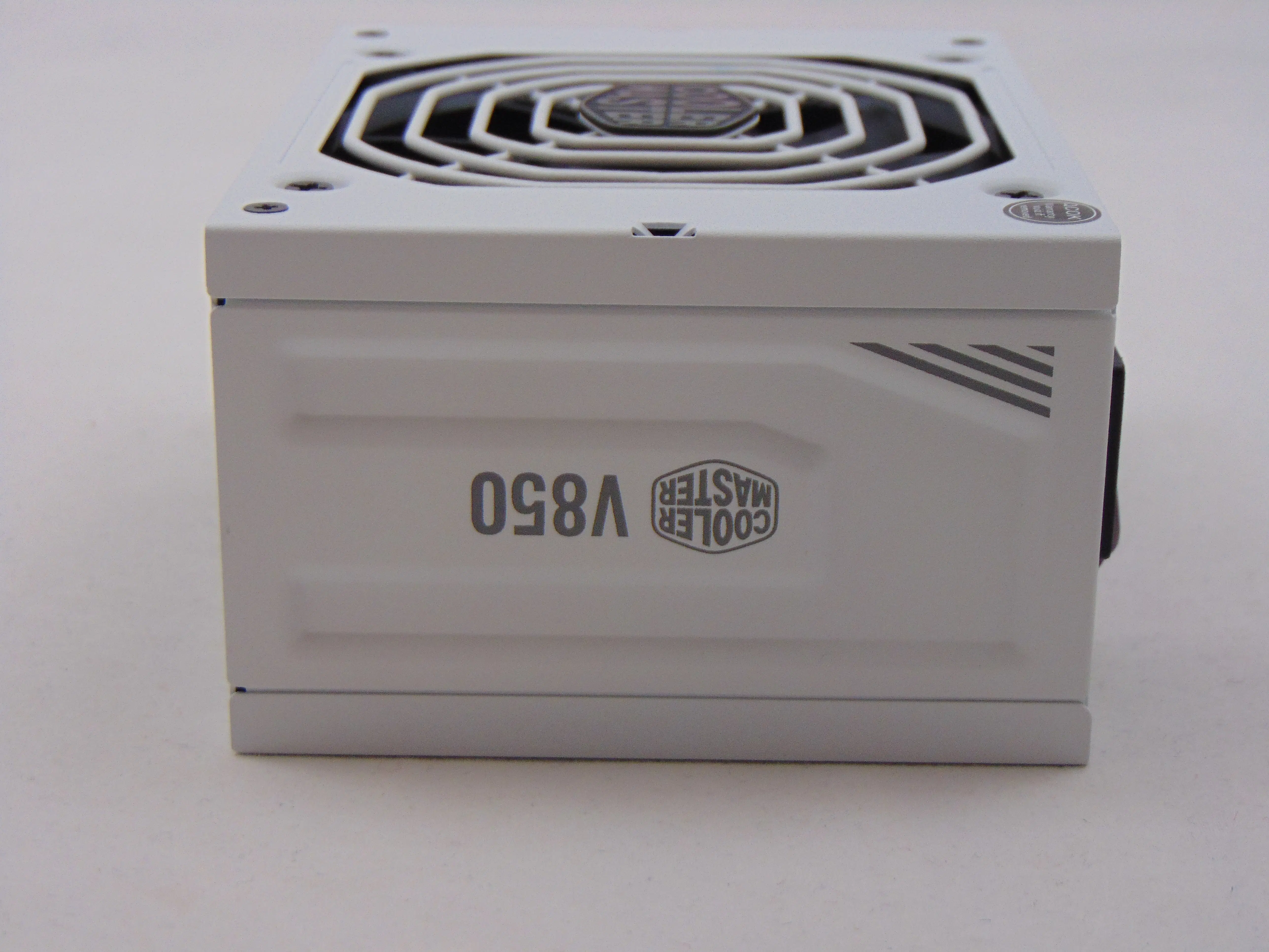

The exterior of the V850 SFX GOLD WHITE Edition is traditional for a modular unit with an overhead fan in the SFX form factor. Cosmetically, the unit carries the V850 branding in a sea of white, embossed accent designs, and the Cooler Master fan guard. The branding is nice and a bit more eye-catching than we see with some other units. The modular interface is well labeled. Rounding things out, the unit has a durable white finish that is not only slightly textured but striking in a landscape of black finishes. Indeed, black has become the 2000, 2010, and 2020’s version of the 1990’s power supply grey so it is nice to see something buck that trend.

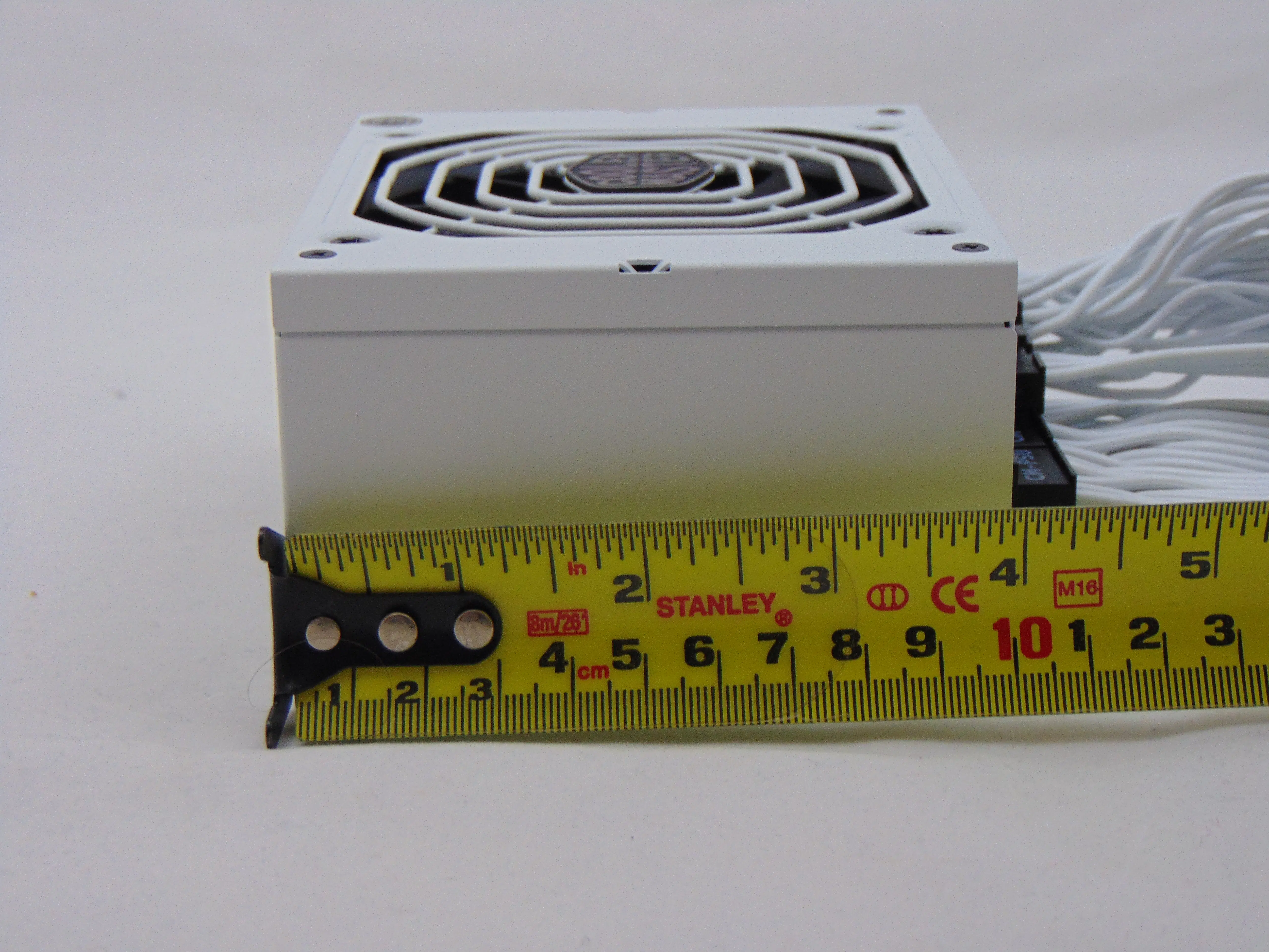

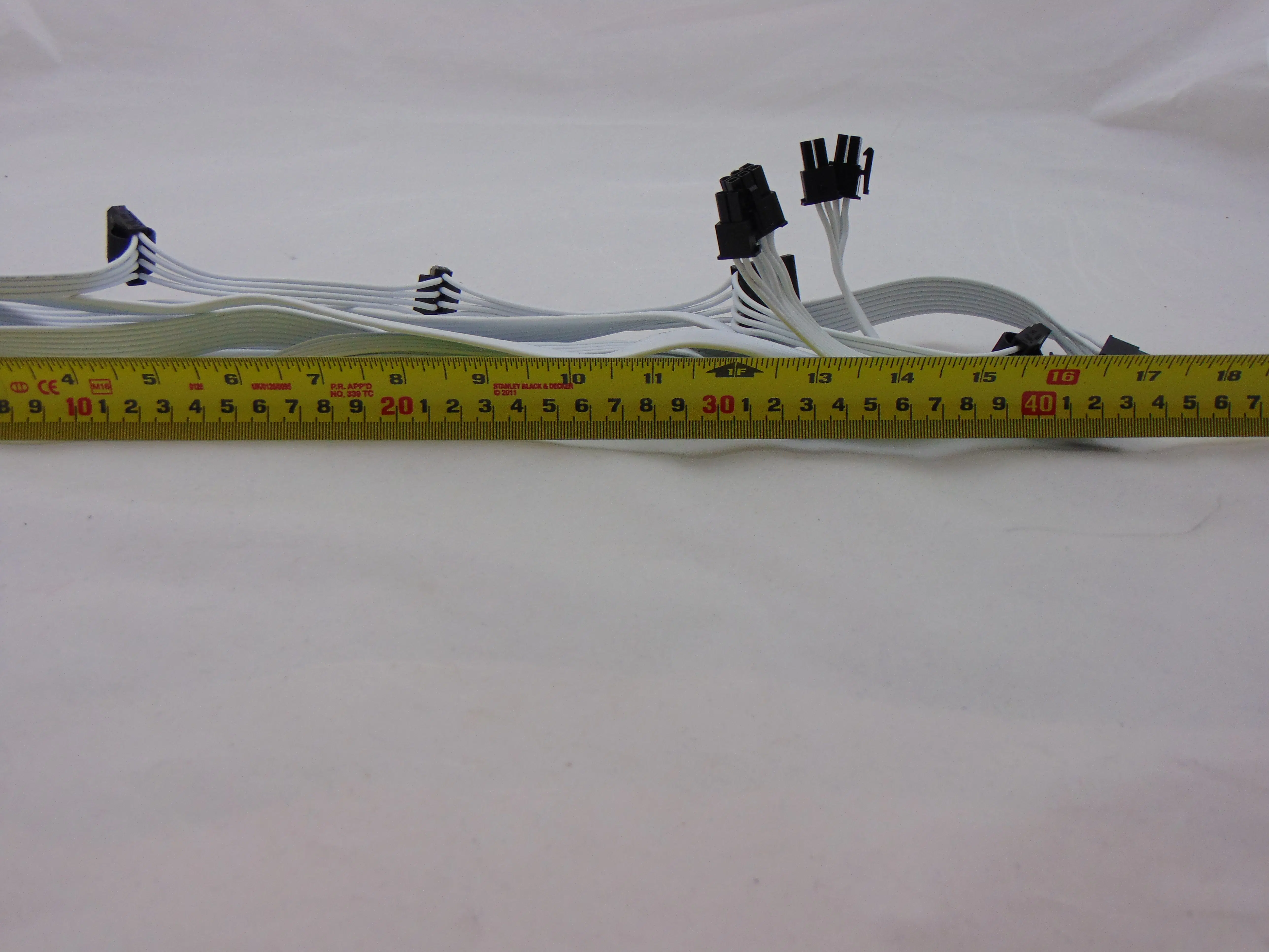

The V850 SFX GOLD WHITE Edition comes in at a total length of ~4 inches while the cables come in at a length of ~6″ to 18″ to the first, or only, connector. Additionally, the cables are all FlexForce style cables which is excellent. Also excellent, the cables are done up in white with the connectors being black for that modern chic look.

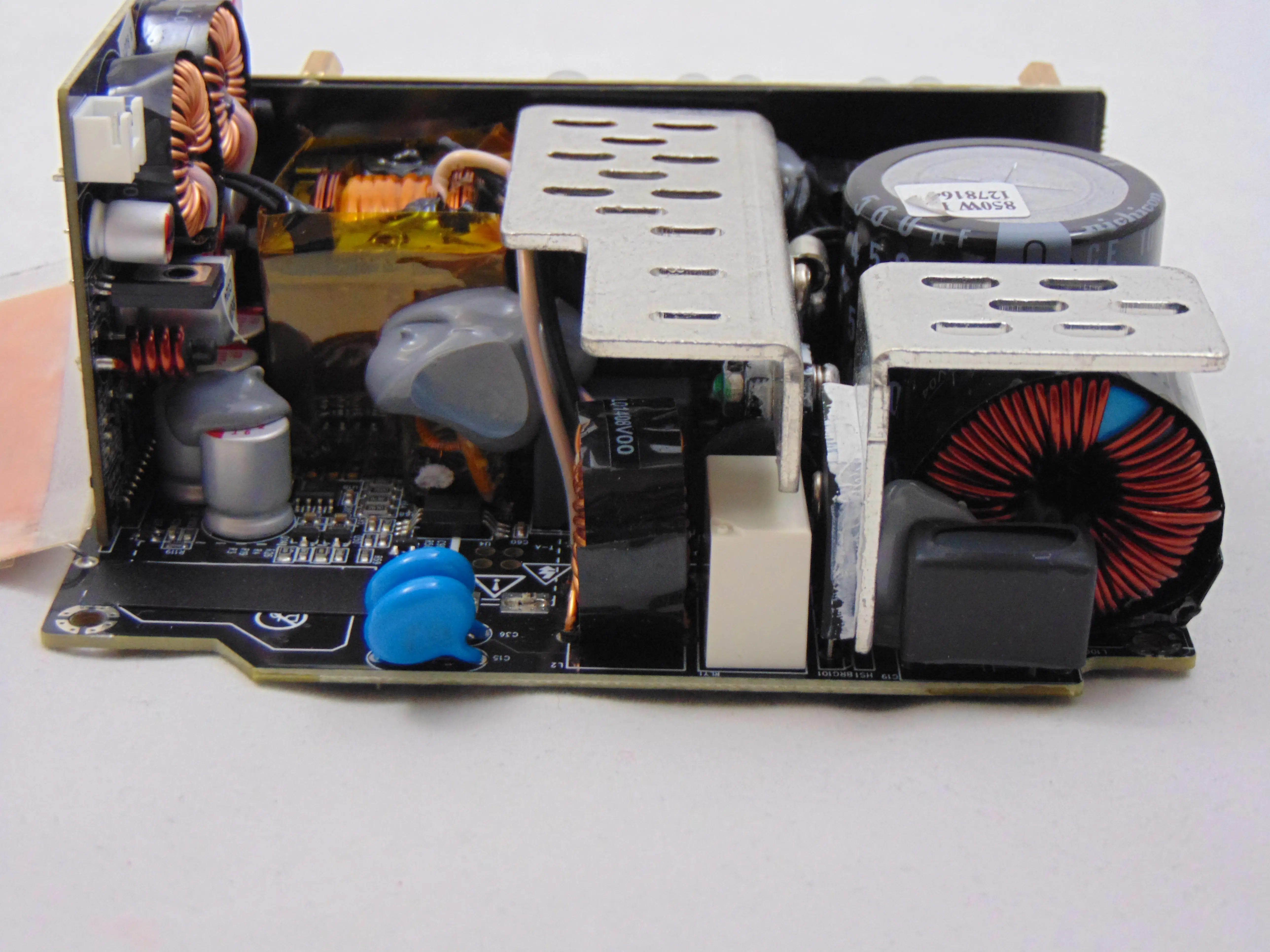

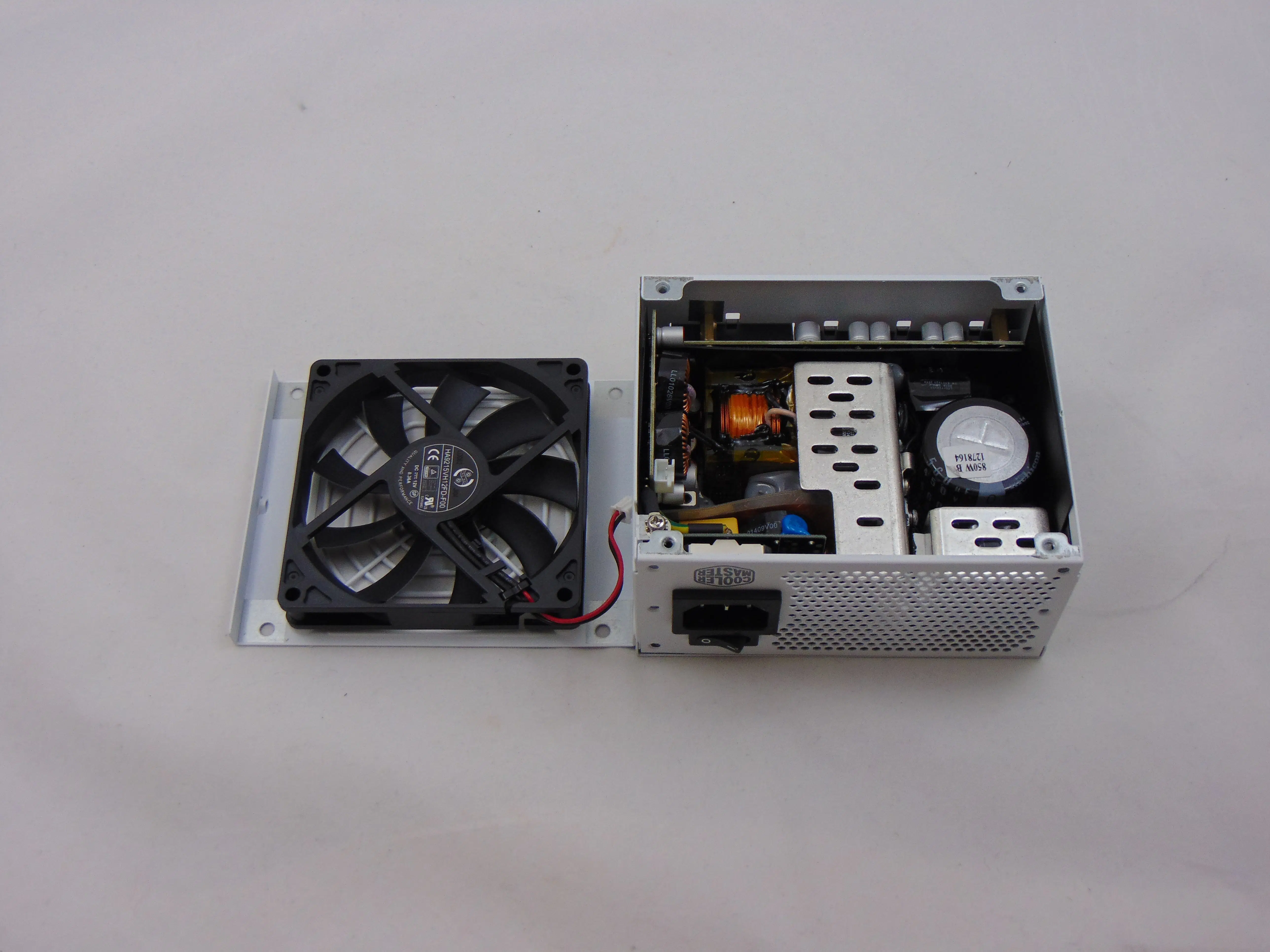

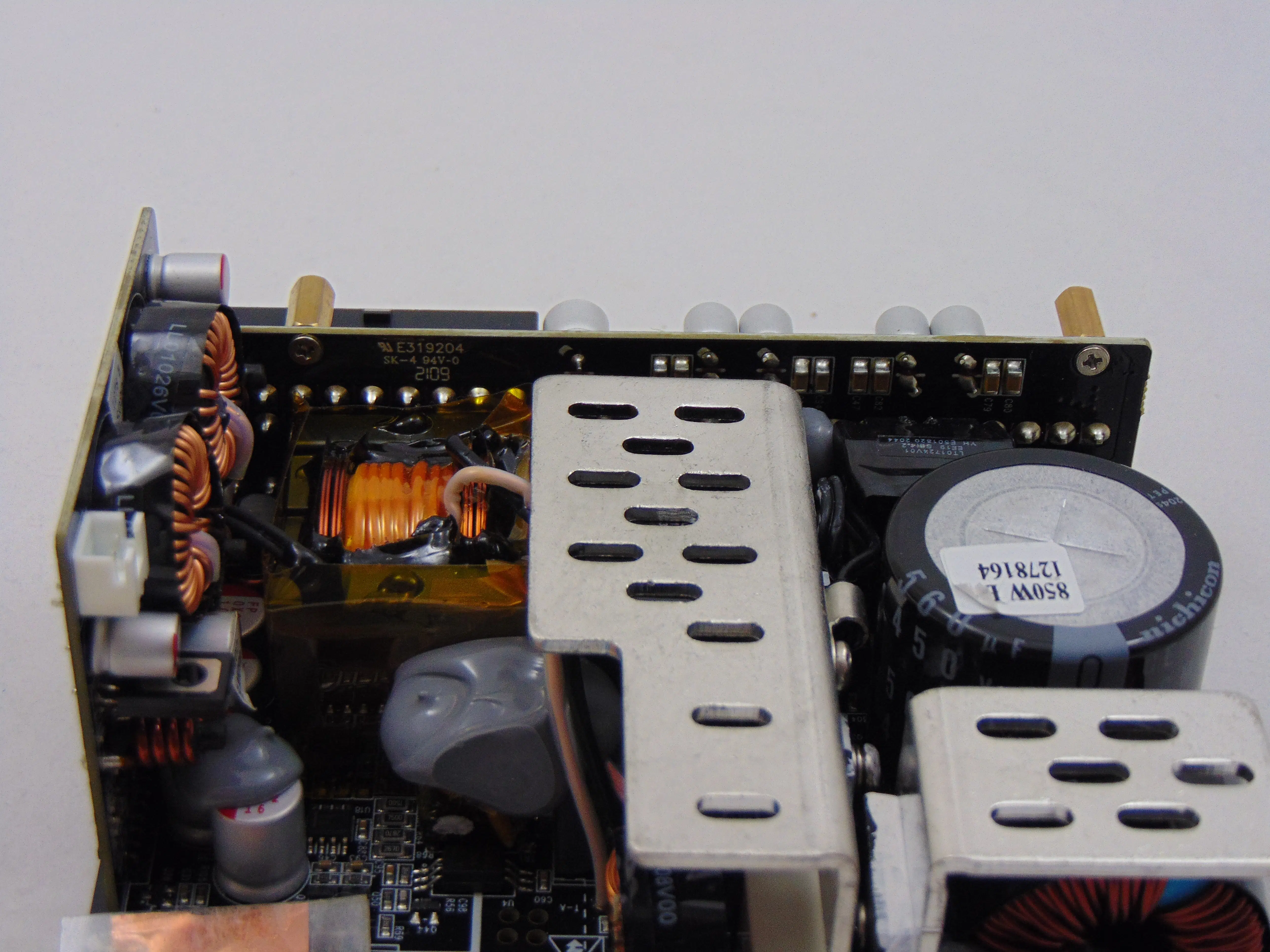

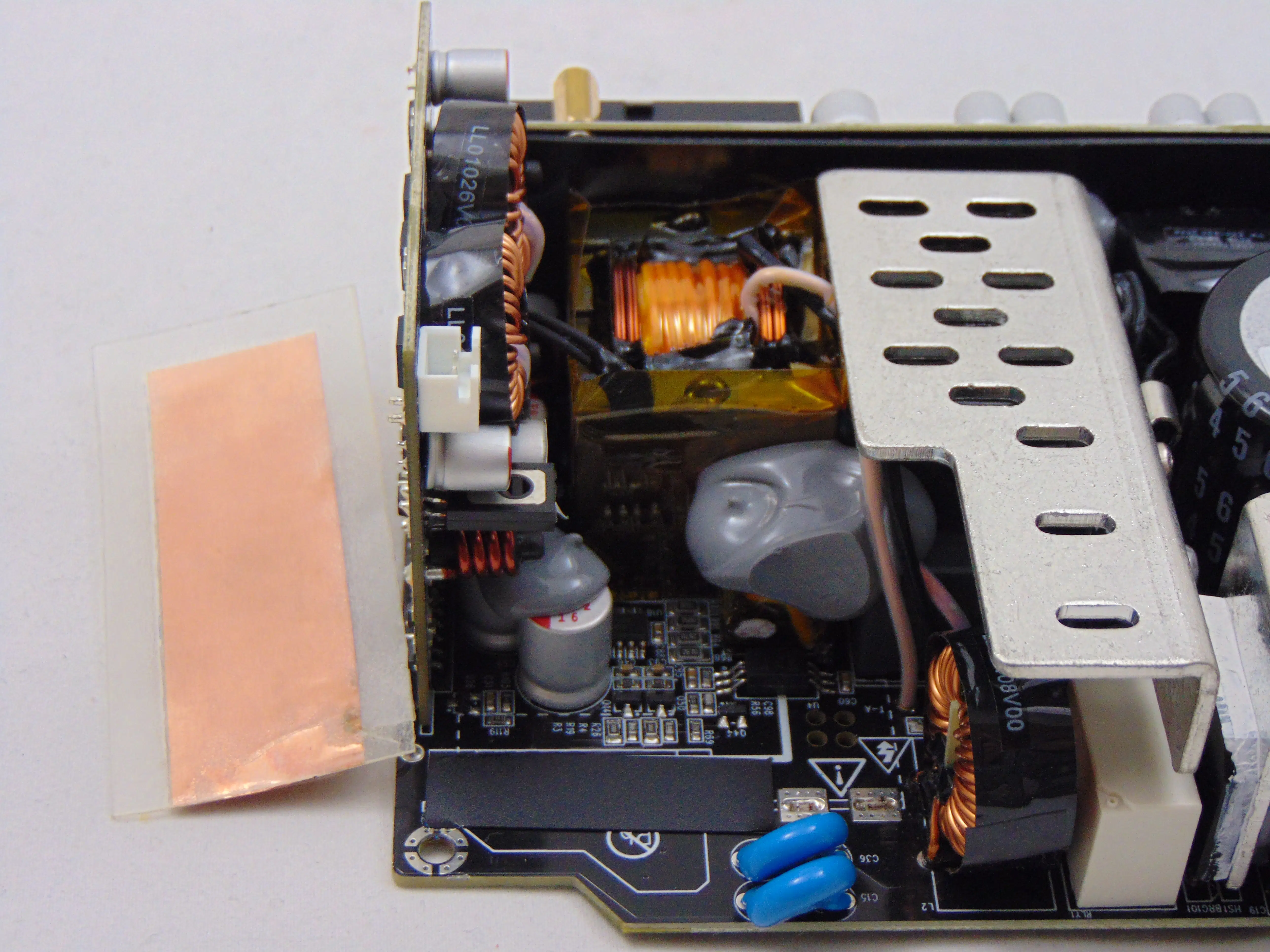

Once we open the top of the V850 SFX GOLD WHITE Edition we see the same platform from Gospower that we saw with the V650 SFX Gold previously. So, once more, the topology has a resonant LLC primary with a synchronous rectification secondary and DC-DC VRMs for the minor rails. The fan cooling this unit today is an FDB fan. The fan is manufactured by Hong Hua and rated at 0.36A at 12v (the same as the V650 SFX GOLD). It is paired with two different heatsinks. Interestingly, that means there is one large and one small(ish) heatsink on the primary side proper that are rather crude-looking affairs. On the secondary side, the heatsink duties are handled by the MOSFETs being attached to thermal pads on the case housing. Lastly, the soldering is excellent on the main PCB once more.

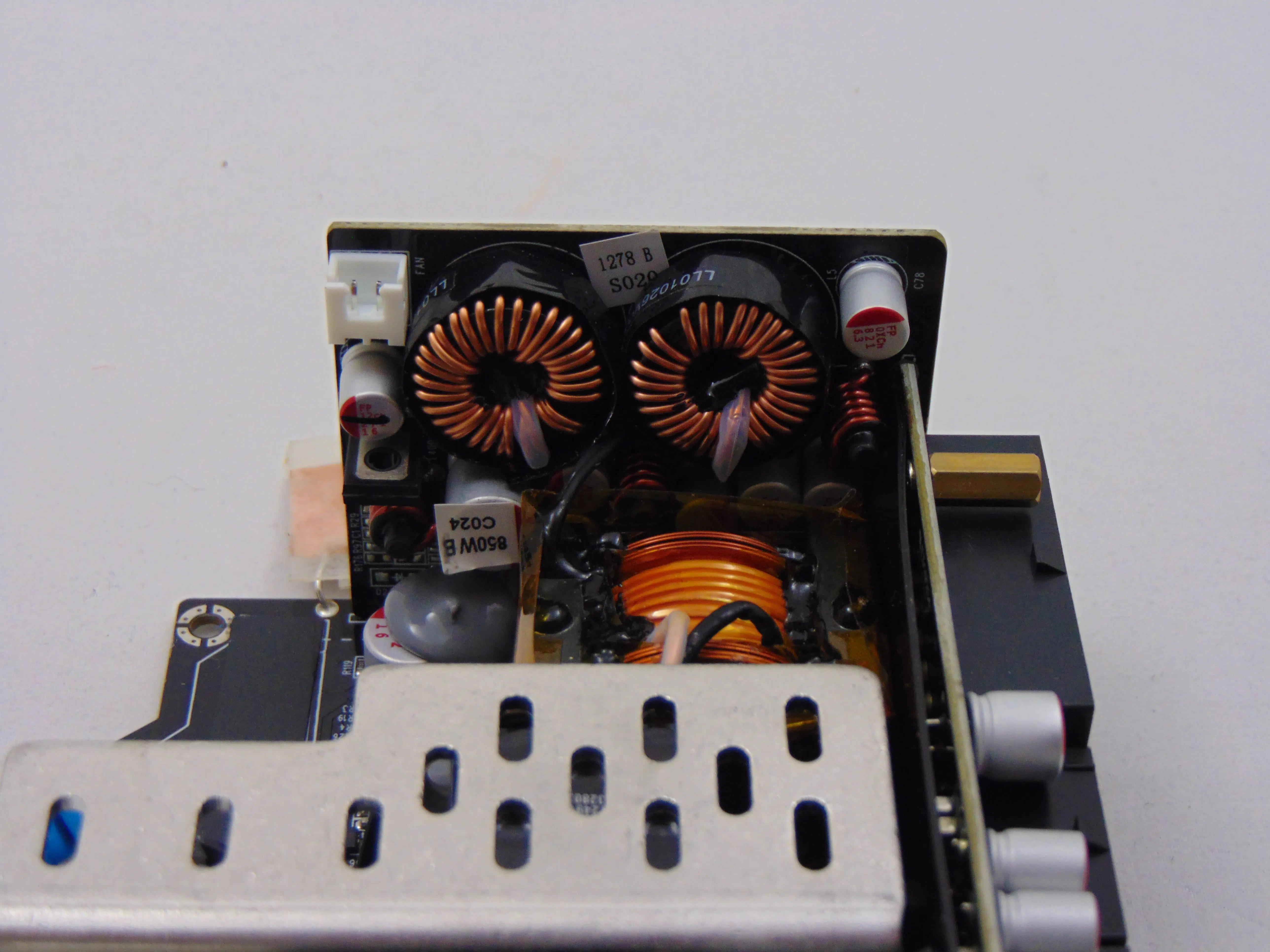

The V850 SFX GOLD WHITE input filtering begins up on the housing itself where we find a PCB with some X capacitors, Y capacitors, and a coil. The balance of the input filtering is found on the back edge of the main PCB. There is then a bridge rectifier attached to its own heatsink. Generally behind this, we find the main input capacitor (which is a Nichicon part rated at 450v 560uF 105C) and then the APFC coil. The heatsink next to all of this houses the APFC components and the remainder of the primary side power components. The overall setup here is fairly standard but very tight as you would expect in such a small unit.

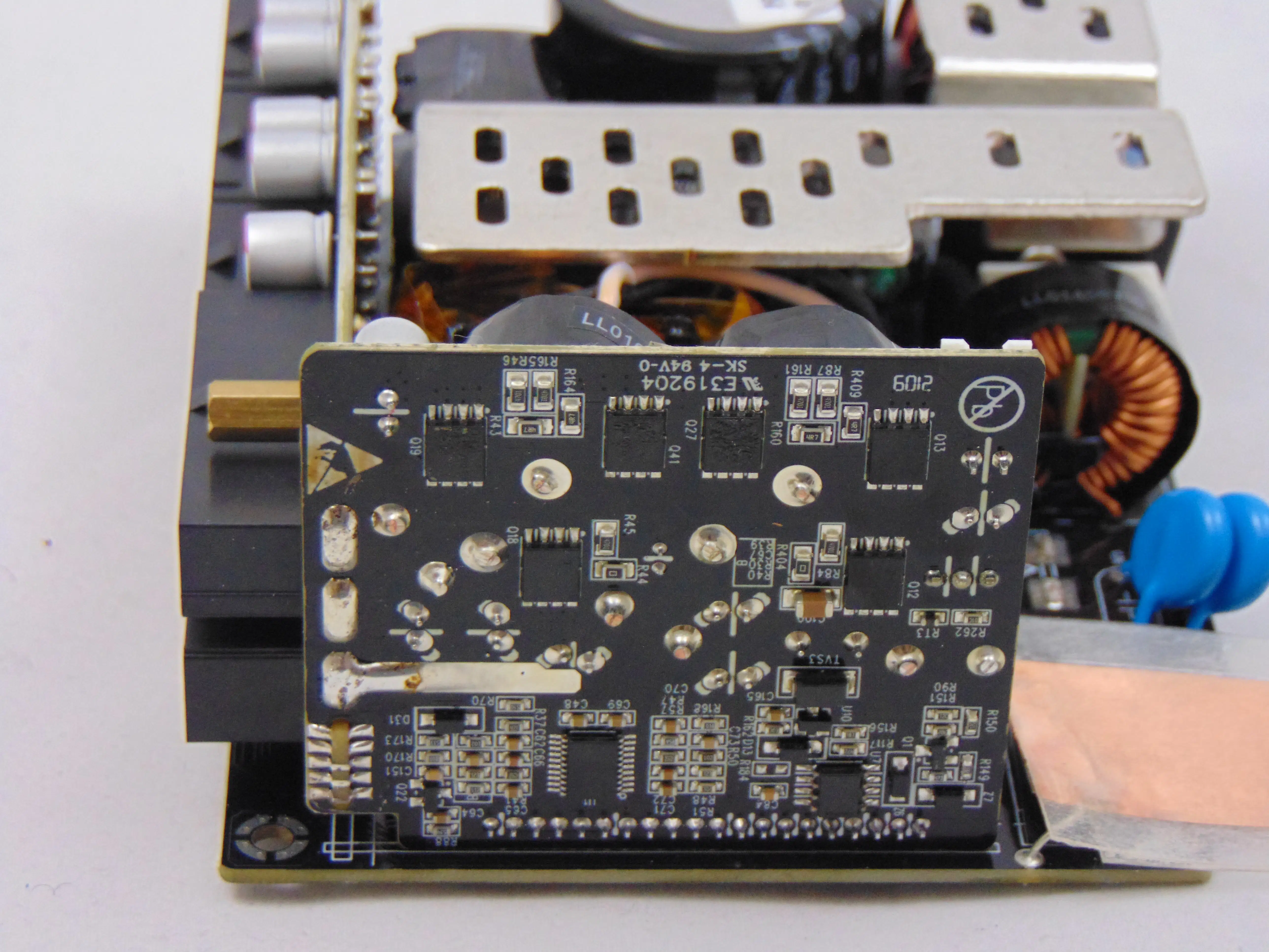

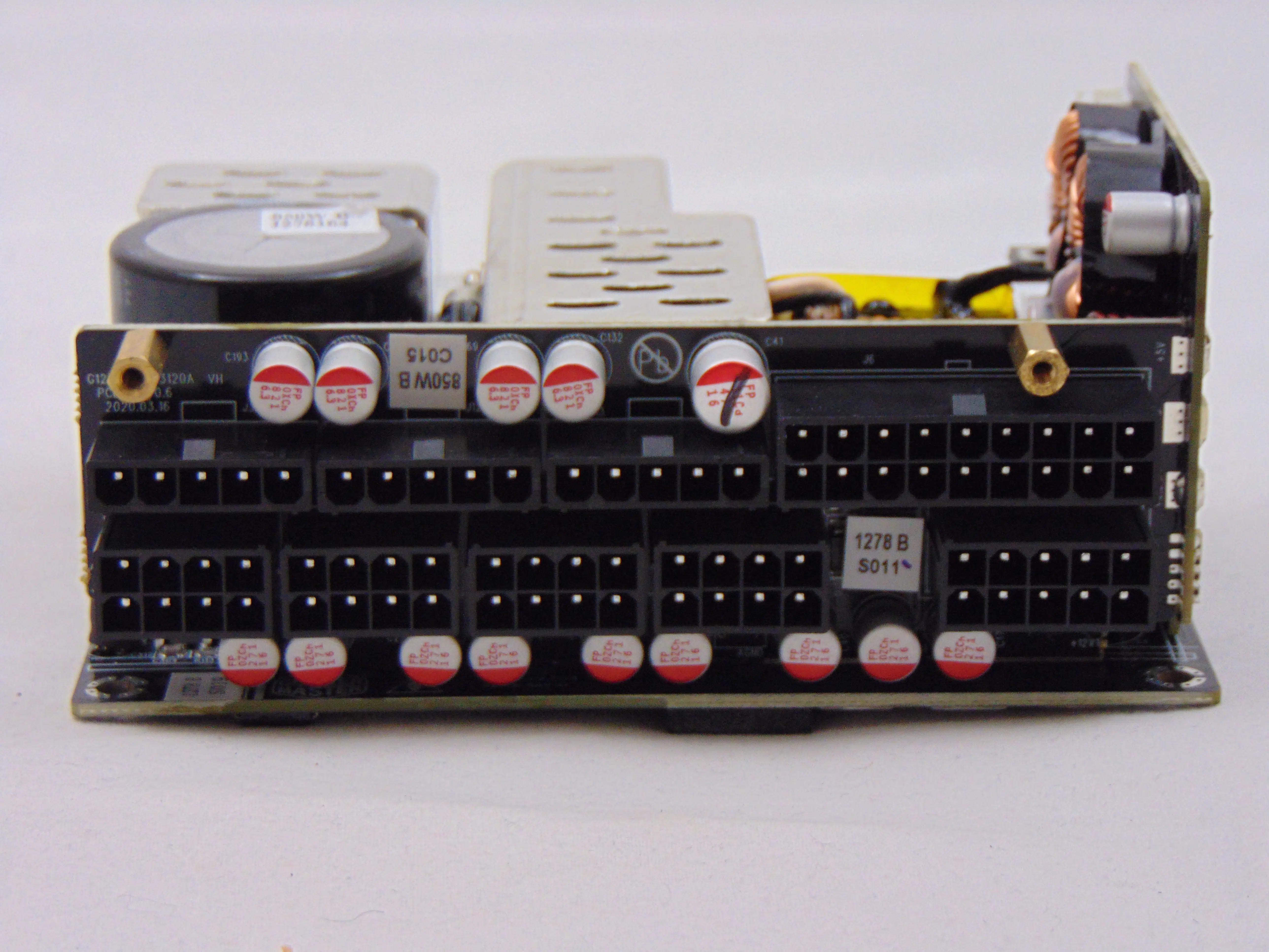

The secondary side of this unit looks a bit crowded, much as was the case with the 650W model, but that is again down to the form factor. Behind where the main input filtering PCB is attached to the main PCB is the main transformers for this unit. Then, next to this, we find an add-in PCB that houses the DC-DC VRMs. This PCB is populated with a number of FPCAP solid capacitors and there are some more around the base of the PCB. The MOSFETs for the secondary side are found on the backside of the main PCB as seen earlier. Lastly, we come to the modular PCB which is cleanly done and populated by more FPCAP capacitors.
