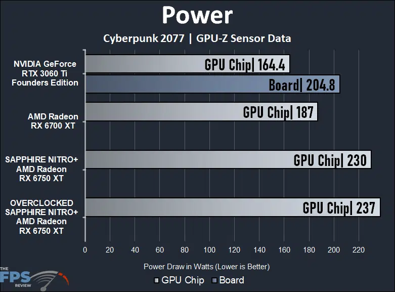

SAPPHIRE NITRO+ AMD Radeon RX 6700 XT GAMING OC Video Card Power Graph
The SAPPHIRE NITRO+ AMD Radeon RX 6750 XT had a GPU Chip power draw of 230W. When we overclocked it, that increased by 7W. Compared to the Radeon RX 6700 XT, at 230W GPU Chip Power, the 6750 XT consumes 23% more GPU Chip Power. Considering we only saw 5-10%, or 15% in one instance, performance improvement, that difference is not very power efficient. The power has increased more than the performance increase, so to get 10% more performance, requires 20%+ more power. This is also more power-hungry than the RTX 3060 Ti.

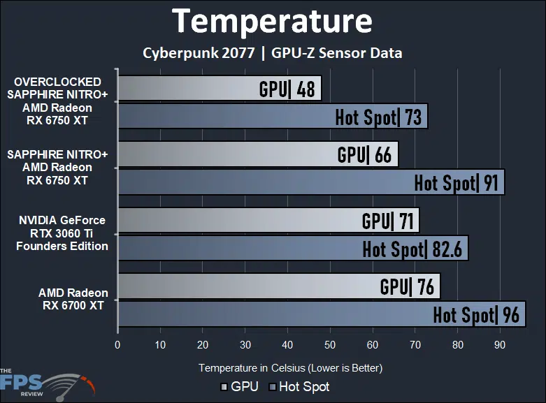

SAPPHIRE NITRO+ AMD Radeon RX 6700 XT GAMING OC Video Card Temperature Graph
The SAPPHIRE NITRO+ AMD Radeon RX 6750 XT really shines in its cooler performance. The SAPPHIRE NITRO+ has a GPU temp of only 66c and Hot Spot at 91c. This is running cooler than even the Radeon RX 6700 XT, which has lower clock speeds, it’s at 76c GPU temp and 96c Hot Spot. The SAPPHIRE NITRO+ also runs cooler than the GeForce RTX 3060 Ti. It is in fact, the coolest running video card here in our lineup today. When we overclocked it we pushed the fans to 100% and overclocked it’s at a very cool 48c, can you believe that only 48c for that much power it is drawing. The SAPPHIRE TRI-X cooling configuration is very robust, and does the job greatly, providing phenomenal cooling.

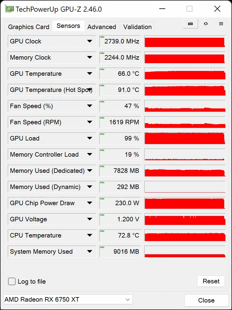

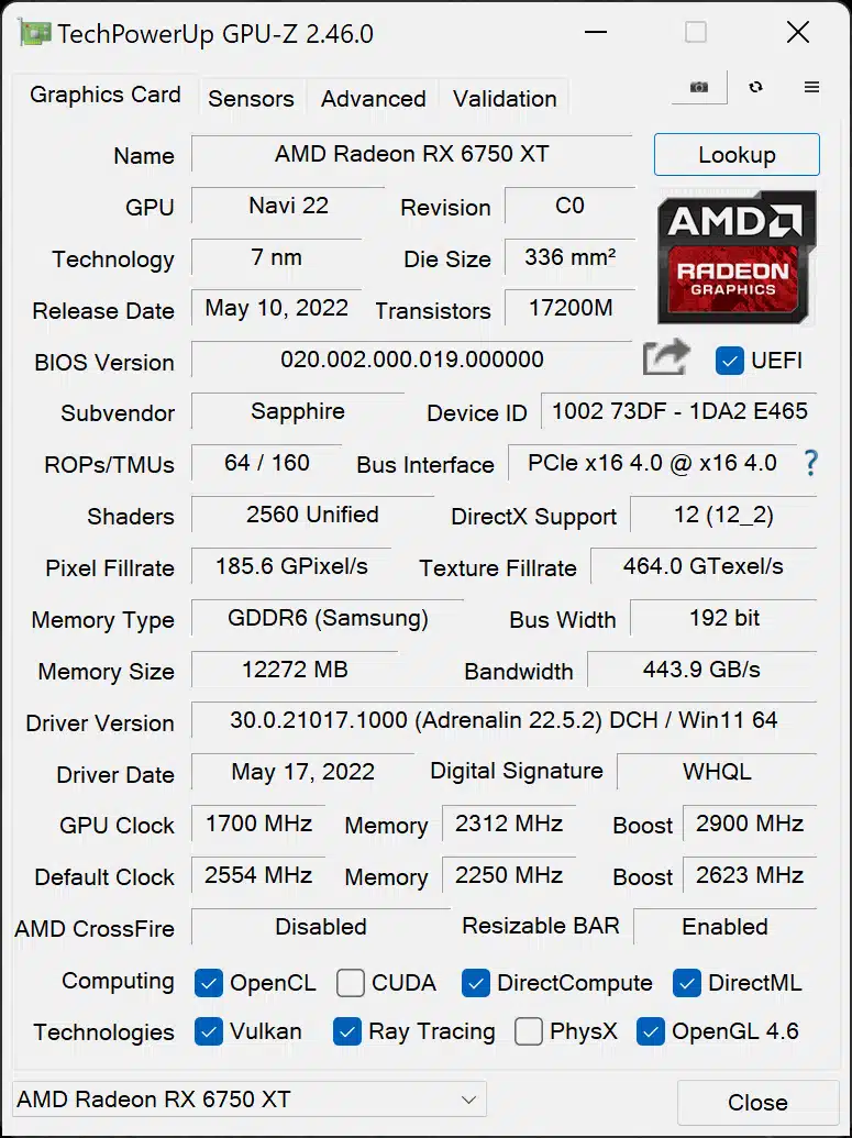

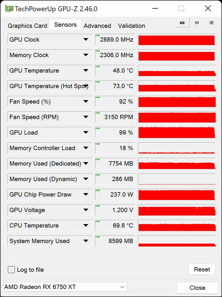

GPU-Z Sensor Data
The first two screenshots of GPU-Z above are at Default, and the second two screenshots of GPU-Z are at Overclocked.
