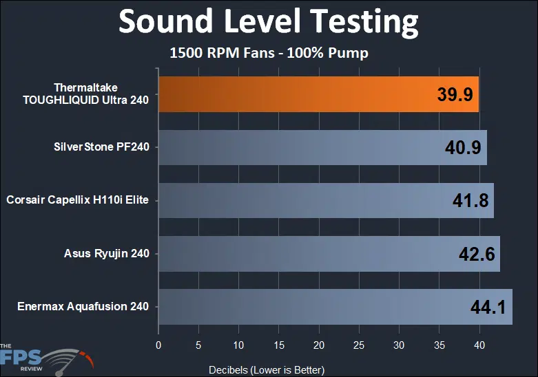

1500 RPM Fans – 100% Pump Speed
Thermaltake TOUGHLIQUID Ultra 240 Mild Overclock 1500 RPM sound testing
Bringing all fans down to 1500 RPM keeps the Thermaltake TOUGHLIQUID Ultra 240 in the lead as the quietest (even though it fell to last place for thermals). At this point, we could not differentiate it above the ambient noise in the room.

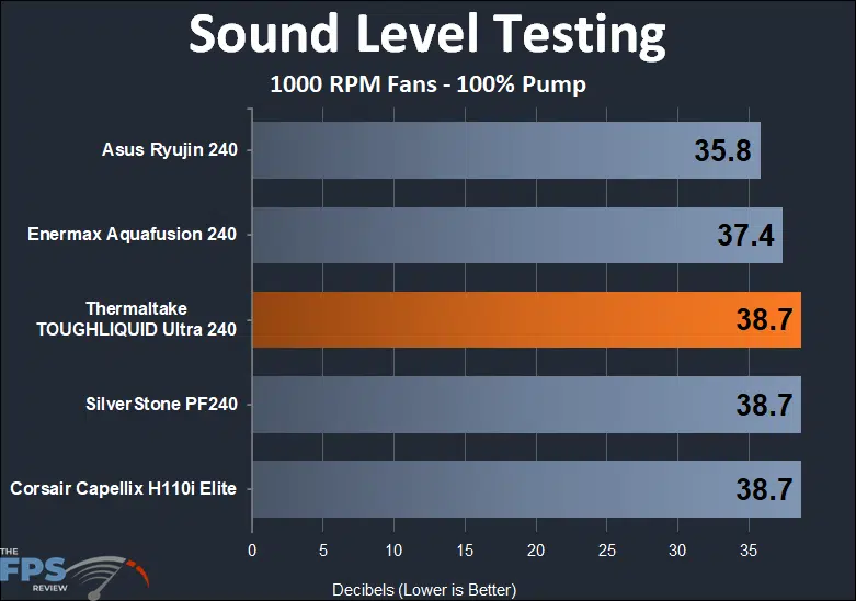

1000 RPM Fans – 100% Pump Speed
Thermaltake TOUGHLIQUID Ultra 240 Mild Overclock 1000 RPM sound testing
Getting down to 1000 RPM, the competition starts to catch up with the Thermaltake TOUGHLIQUID Ultra 240, causing a three way tie for last place at 38.7 dB(A).

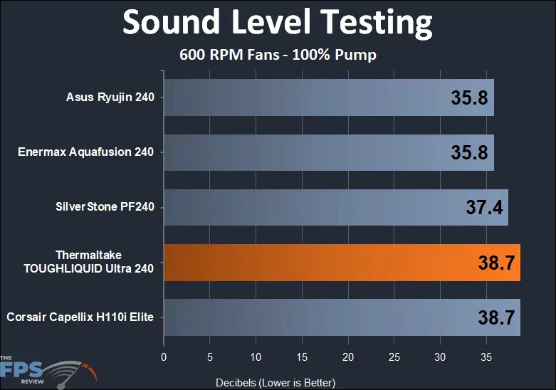

600 RPM Fans – 100% Pump Speed
Thermaltake TOUGHLIQUID Ultra 240 Mild Overclock 600 RPM sound testing
Finally, at 600 RPM, the Thermaltake TOUGHLIQUID Ultra 240 didn’t change its sound profile while the thermals got worse. Given such the 1.2 dB(A) difference between 600 RPM and 1500 RPM, it doesn’t make a lot of sense to run the fans this low unless you don’t have the system under load.
