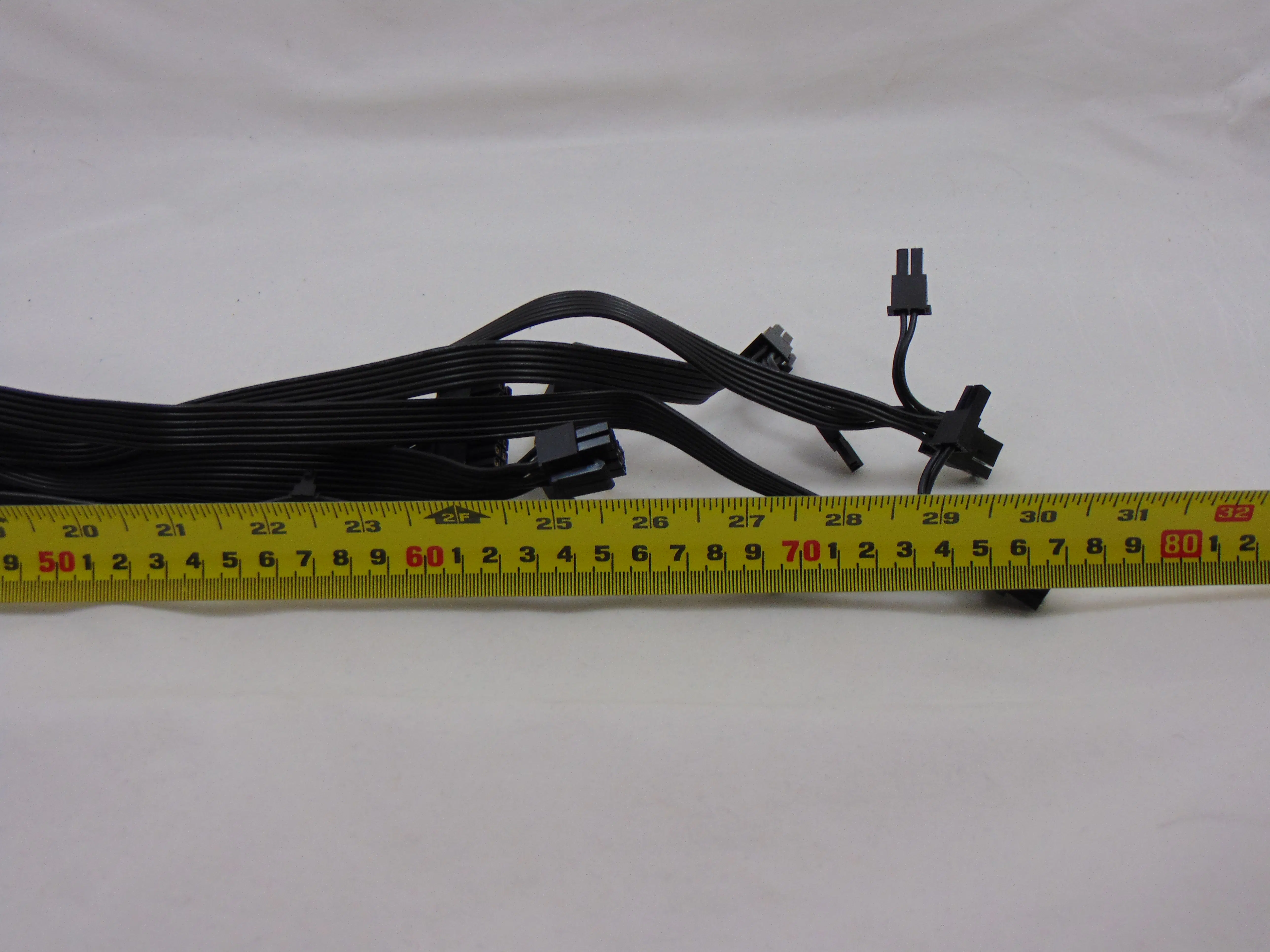

The DeepCool PQ850M comes in at a total length of ~5 1/2 inches while the cables come in at a length of ~23″ to 30″ to the first or only connector. Additionally, the cables are all FlexForce style cables which is excellent and this unit is fully modular.

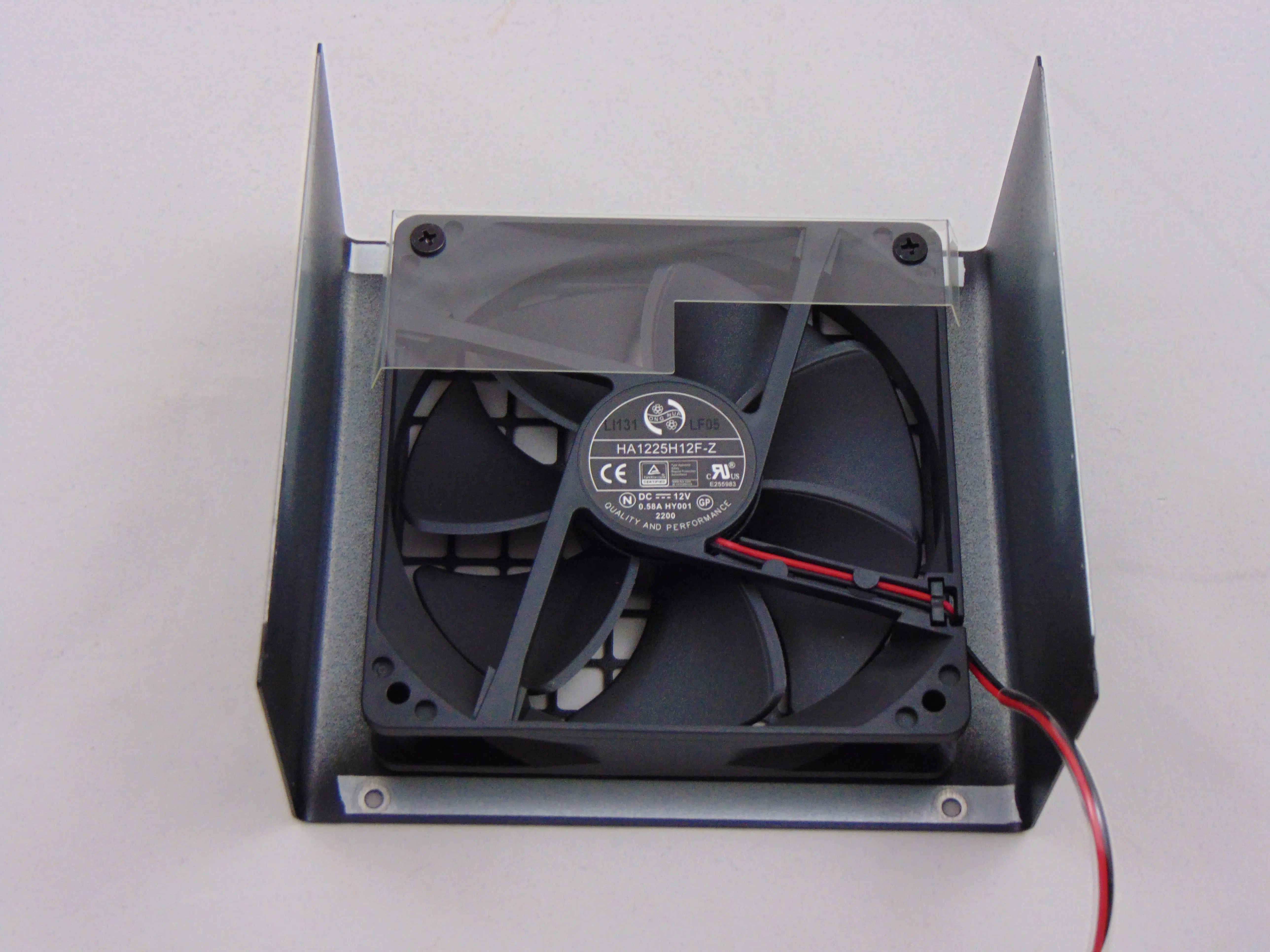

Once we open the top of the DeepCool PQ850M, we see a rather open layout that is based on Seasonic’s Focus Plus Gold design. The topology features a full bridge resonant LLC primary with a synchronous rectification secondary and DC-DC VRMs for the minor rails. The fan cooling this unit today is a Hong Hua FDB fan rated at 0.58A at 12v and it is paired with six heatsinks of varying size and design. Lastly, the soldering is very neatly done.

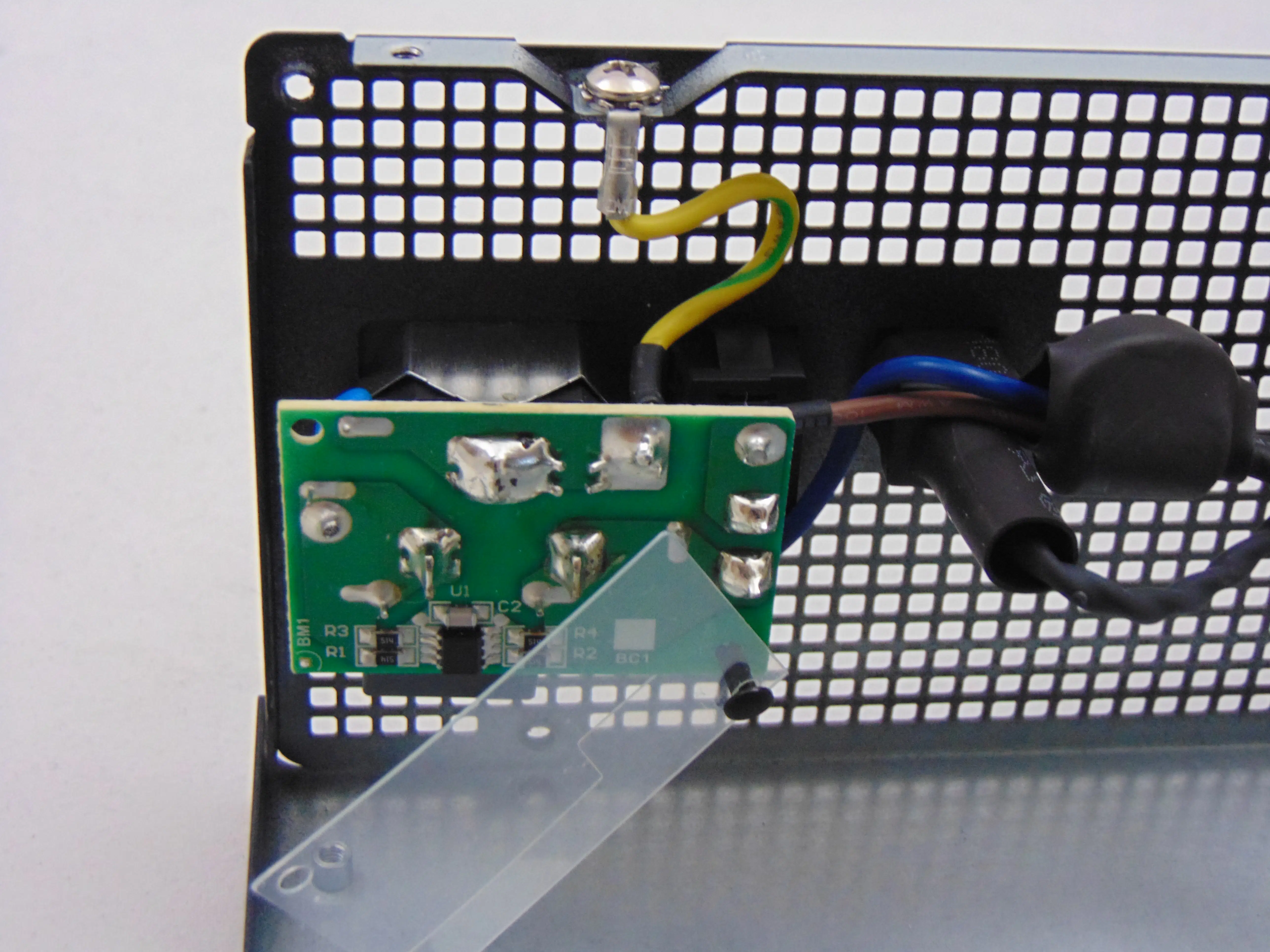

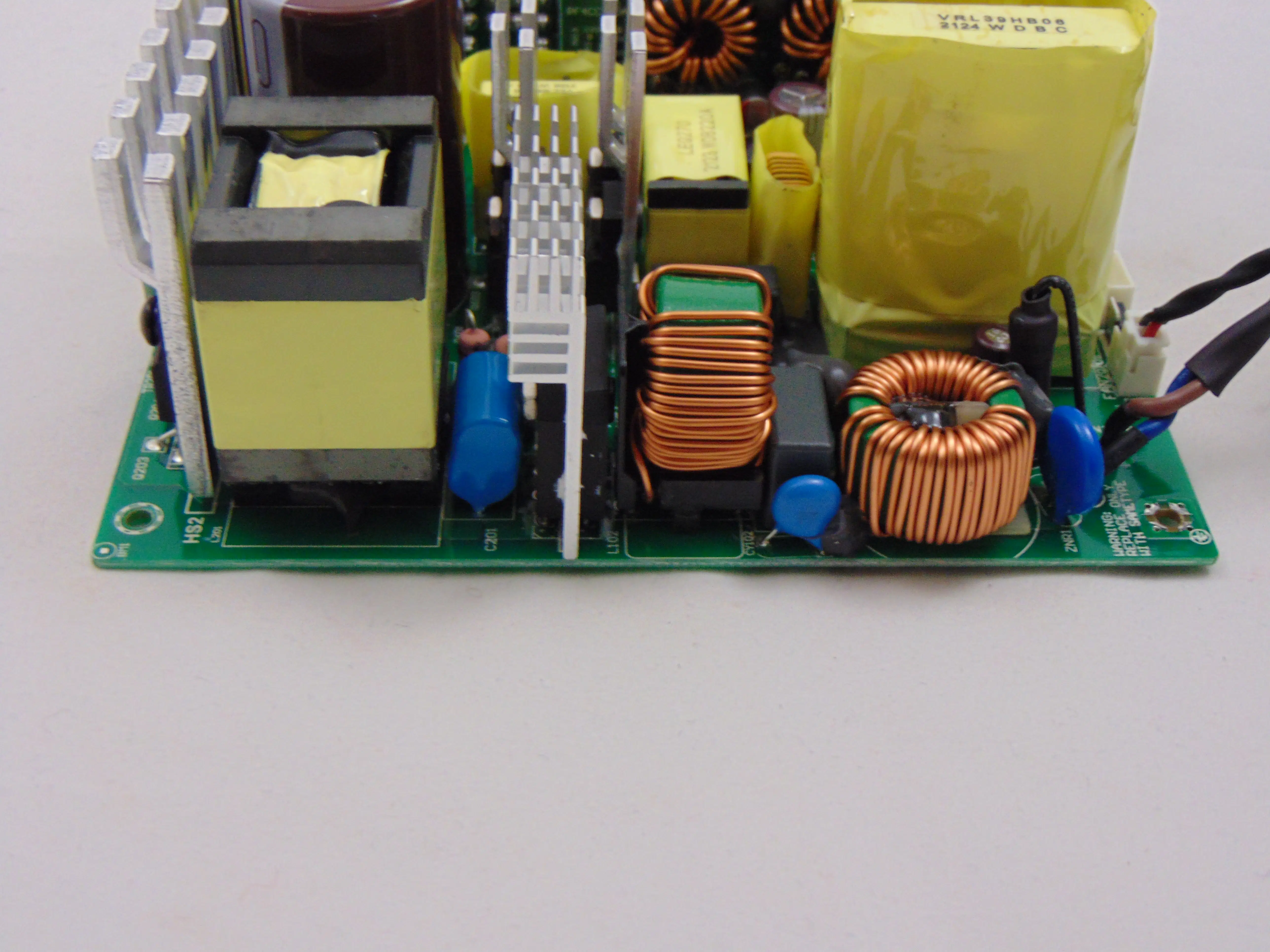

The DeepCool PQ850M input filtering begins upon the housing itself where we find some X and Y capacitors. The balance of the input filtering is found on the back edge of the main PCB. There is then a pair of bridge rectifiers next in the line sandwiching the finned heatsink. The APFC coil is next followed by another heatsink. On this heatsink we find the APFC power components. Next to these, behind the APFC coil, we find the main input capacitor. This capacitors is provided Nippon Chemi-Com and it is rated at 400v 680uF 105F! Impressive! Next to this capacitors we find the main switchers attached to a pair of heatsinks that are fingered.

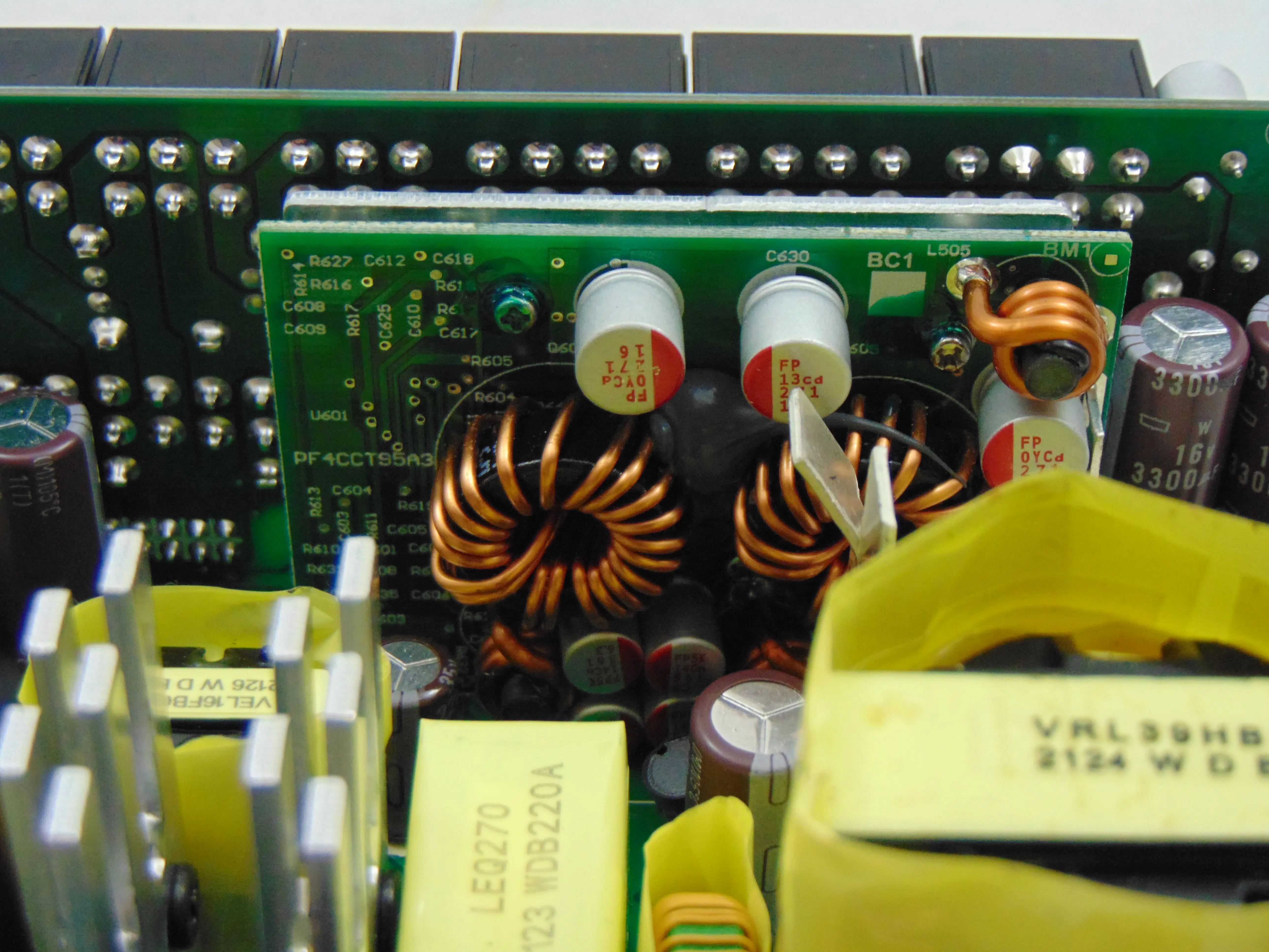

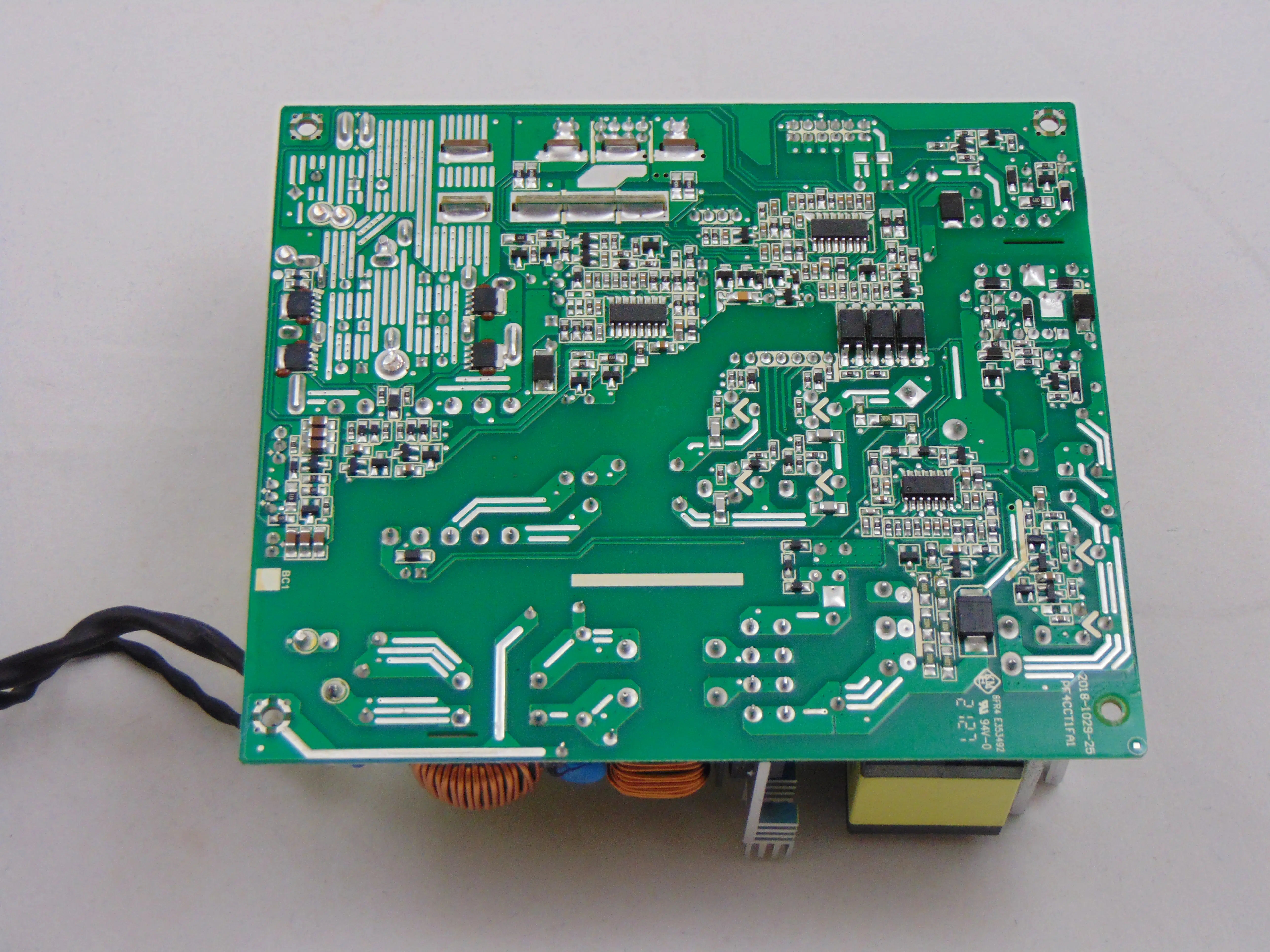

The secondary side of this unit looks rather open. In the middle of this area, we find all of the transformers. Moving on, the MOSFETs are on the back of the main PCB but we see the two small silver heatsinks here which are used for cooling them. Next to this, we find the DC-DC VRMs housed on their own PCB (populated by FPCAP solid capacitors) up against the modular PCB and edge of the main PCB. In front of these PCBs, we find a few standard electrolytics courtesy of Nippon Chemi-Con. The modular PCB construction looks very nice and there are FPCAP and Chemi-Con solid capacitors as well as Nippon Chemi-Con standard capacitors found here.
