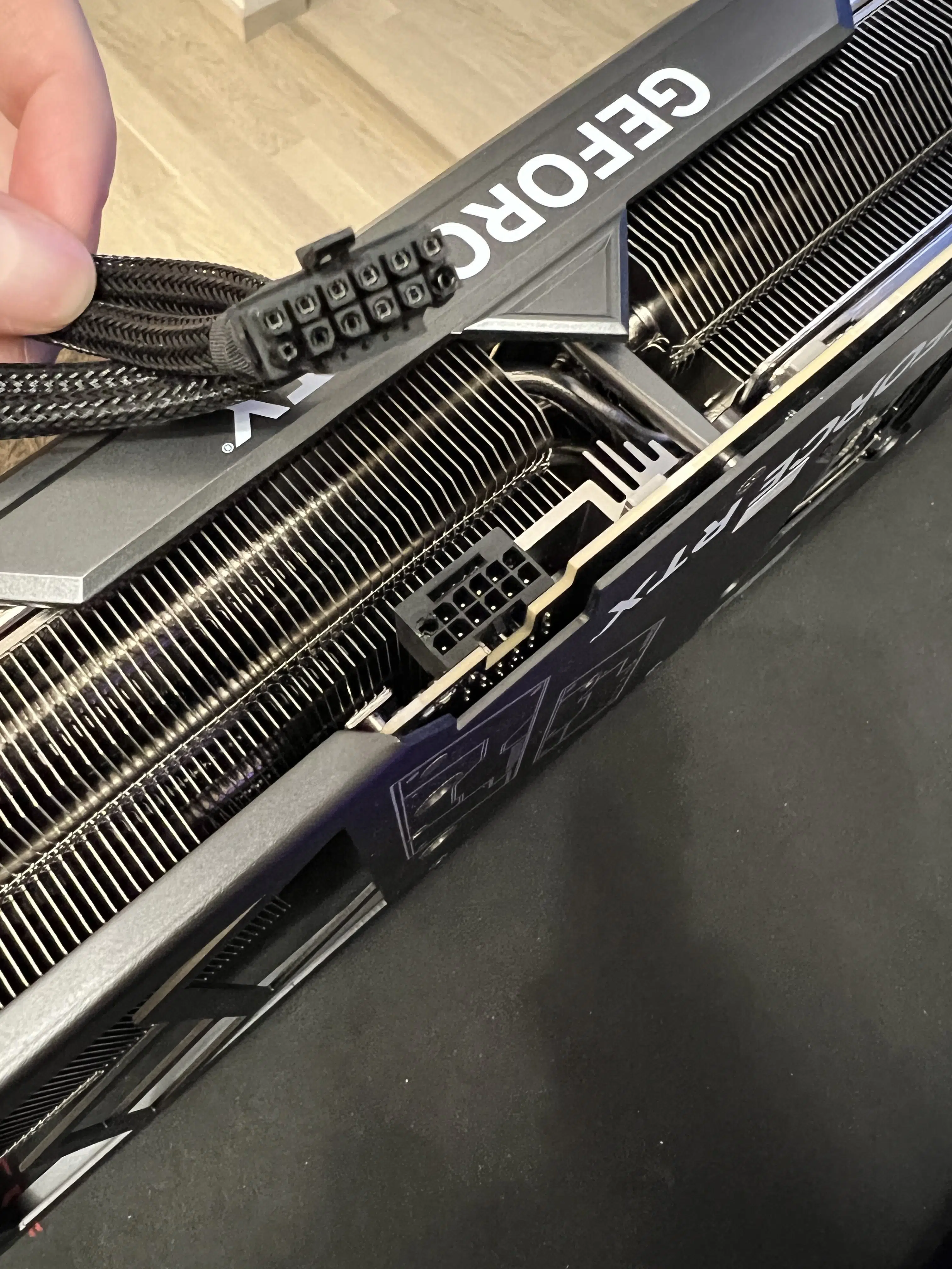

NVIDIA is following up on reports from multiple RTX 4090 owners who claim their 16-pin power adapters melted while gaming. The first was reported on by Tom’s Hardware yesterday who then later updated that another had come forward. This claim was made by Redditor user NoDuelsPolicy who said they had a similar experience while playing Black Desert with their ASUS TUF Gaming RTX 4090. They said the screen went black, fans spun up, and they quickly powered down the system to investigate. Upon closer examination, it could be seen that the card and adapter were both damaged.
Image: NoDuelsPolicy on Reddit
This image does share a similarity with those from the previous user in that the two corner connectors/pins in the row next to the 4-pin power-sense connectors are the most damaged while the row furthest away is largely unscathed. Tom’s Hardware reached out to NVIDIA who said they are now investigating these reports.

J2C made some good comments about it. And I think he right. It's such a small connector, small pins, with a rather stiff cable coming out it. With these cards being so massive you can't avoid having to bend that cable to fit it in a case. The bend is putting pressure on the connector which is causing some of the pins to lose full contact. When that happens a lot of current is being drawn through a minimal contact and it heats up, melts.
This whole 12+4 design is poor. 35mm of standoff before being able to bend the cable is ridiculous. You'd need a seriously wide case to make that work, or vertical mount the GPU. But then you'd still have this ugly cable sticking up out of the card like a fountain.

Just saw this on Reddit this morning. Another one, another TUF 4090. Notice how it's the same pins as well.
U
I have doubts bending is the issue. That would make more sense in like a multi pin, where the pins are looser, and each is naked and not in their own plastic little channel, drastically reducing movement. More likely is just plainly too much power for the pins, such as they are bending or not.
MadMummy76
MadMummy76 👍 1
The pin contact area should be enough assuming there is good contact. The problem here is bad contact caused by the small connector not providing enough stiffness. And when the contact gets loose things heat up. I've had molex connectors burn in the early days when GPUs used those for power.
Overall bad design, and a cutting of corners. I'd not be comfortable buying a 4xxx card until they completely replace the connector, preferably with 3x8pin PCIE connectors. I mean a pcie 8 pin connector is only rated at 150W, but I bet anyone they can handle more power before melting than this supposedly 600W connector.
I have a feeling it's poor design on that cable putting WAY too much power through that one pin.
