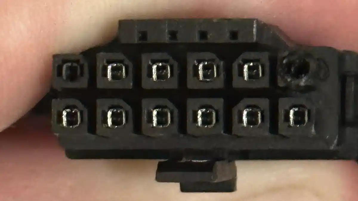

Common melting points?
Multiple posted images have shown a similarity in that the two corner connectors/pins in the row next to the 4-pin power-sense connectors are almost always the first to be damaged. Other pins can be seen damaged in other photos but these 2 seem to be consistently seen in all. The three images below are from three different Redditor users. The first two images were said to be ASUS RTX 4090 TUF OC cards while the third, which has been widely publicized at this point, hasn’t identified which model it is.

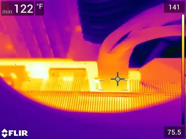

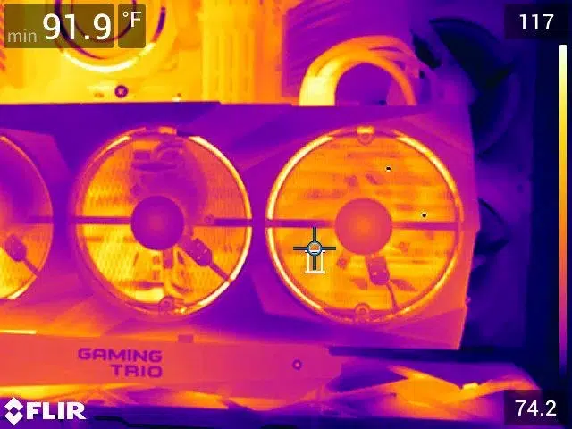

Another user has posted images using a FLIR camera of their MSI Gaming X Trio RTX 4090 using a 3x 8-pin connector. They said they benched the card using Superpostion for 20 minutes and saw an average temperature of 120F. They do not know what the spec threshold for the adapter/plug is but the images do show it as a hot spot.
