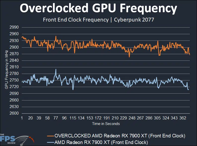

Radeon RX 7900 XT Overclocked GPU Frequency Front End Clock Graph
In the graph above, we are first looking at the Front End Clock Frequency. By default, this should be running around 2400MHz, as per the spec. In reality, while gaming, it starts off pretty high, and then falls to between 2720MHz-2780MHz. This is the default behavior of the Front End Clock, which averages out to exactly 2755MHz without overclocking. Now, when we enabled the 3350MHz Max Frequency slider above, you can see how the overclock compares to this. It starts high and then settles between 2870MHz-2930MHz. The exact average of the overclock turns out to be 2907MHz for the Front End Clock. Therefore, on the Front End Clock, we got a 152MHz or a 5.5% increase for the Front End Clock. This is slightly more than we achieved with the Radeon RX 7900 XTX.

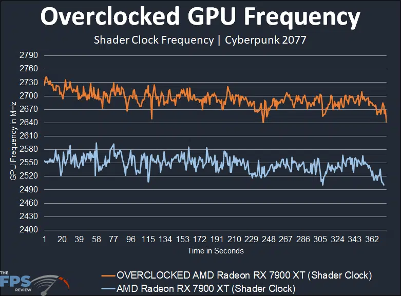

Radeon RX 7900 XT Overclocked GPU Frequency Shader Clock Frequency Graph
In this graph above we are now looking at the Shader Clock Frequency, which should run at around 2000MHz according to the spec. We can see, however, that while playing games it actually boosts to between 2520-2580MHz at default. The exact average of this clock speed turned out to be 2548MHz. When we overclocked the Max Frequency slider to 3350MHz we can see with the orange line how the overclock compares to the default performance. We now see the overclock for the Shaders around 2640MHz-2730MHz. The exact average of the overclock on the Shaders is 2693MHz. Therefore, the overclock has increased the Shader Clock by 145MHz or 5.3%. This shader clock is also higher than what we achieved with the Radeon RX 7900 XTX.

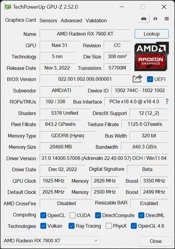

Radeon RX 7900 XT GPU-Z Overclock Screenshot
