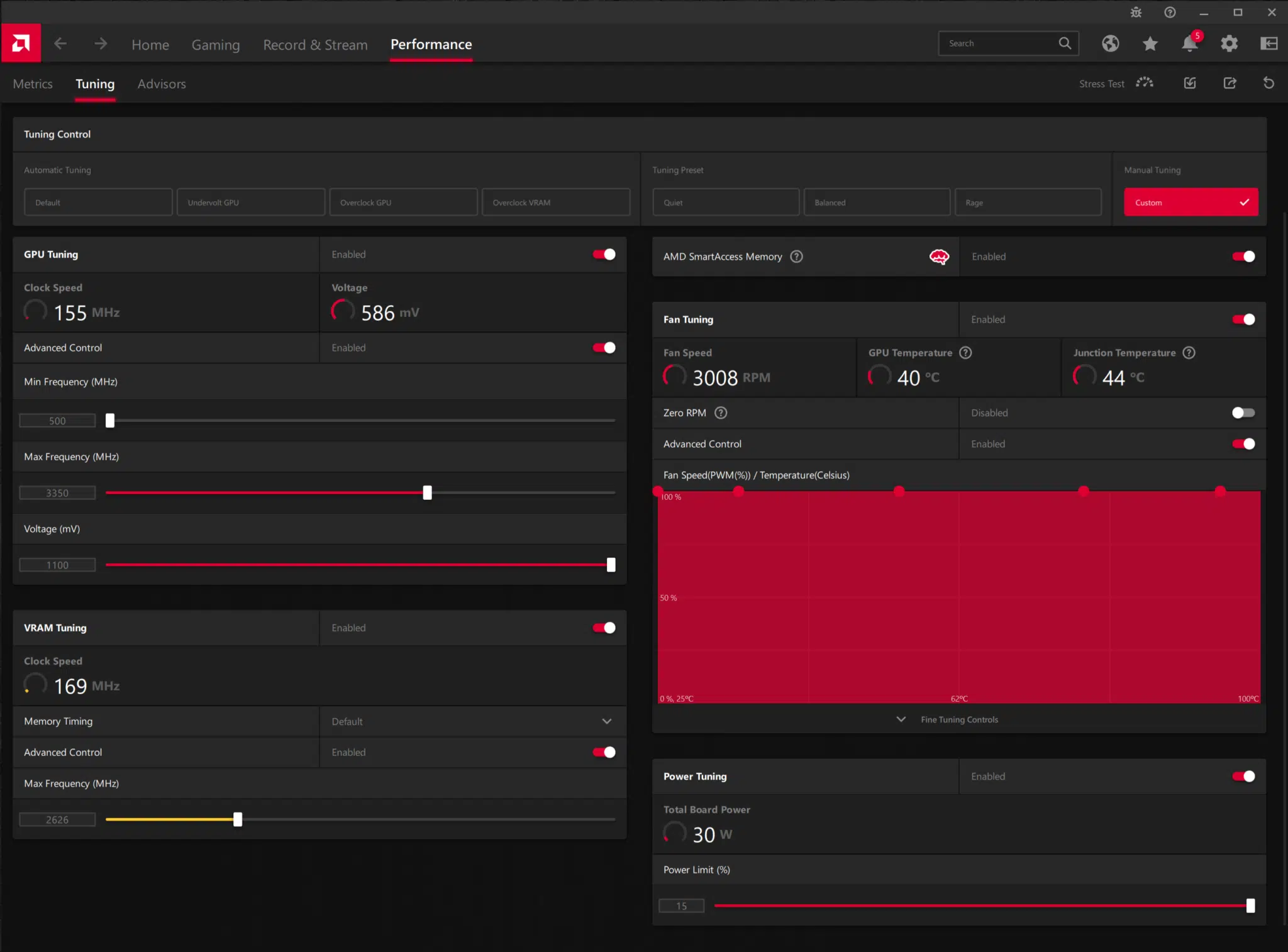

The first thing to do is to launch the AMD Radeon Software and navigate to Performance, and then Tuning, and select Custom to enable Manual Tuning in the software. From here we can enable all the advanced options, and set ourselves up for the win. We can increase the Power Tuning on this video card by +15%, and we can enable 100% fan speeds to ensure the highest stable overclock. We are also able to dial in the Max Frequency slider, and Memory Frequency slider with plenty of headroom on the sliders, they do not hold us back for potential. We cannot, however, raise the Voltage, the default Voltage was at 1100mV.
Keep these numbers in mind in regards to overclocking the Radeon RX 7900 XT, it has two separate clock domains, a “Front End” frequency clock, and a “Shader” frequency clock. The Shader Clock should be around 2000MHz at default, and the Front End Clock should be around 2400MHz. Because the GPU changes frequency dynamically and can boost both above the rated speeds, the actual frequency will be dynamic and vary as you play games. We get our results here by playing real games, in this case, the frequencies shown below are in Cyberpunk 2077 manually playing the game. On our graphs below we are going to show two graphs for overclocking, a Front End Frequency graph and a Shader Frequency graph so that we can show both clock speeds at default and overclocking on both graphs. We are using HWiNFO64 to log the clock speeds.
AMD Radeon Software Performance Tuning Screenshot of Radeon RX 7900 XT Overclock
Above you can see our highest stable settings on this video card. We managed to push the Max Frequency slider up to 3350MHz, now this is not what you will actually get in-game, it is rather a maximum allowance for the GPU to boost higher. You are basically raising the bar at which the GPU can boost, but do not think that you are going to see the exact frequency the slider shows. The only way to know the real frequency is to run a game, and see what HWiNFO64 tells you the Shader Clock and Front End Clock are while gaming.
We also managed to overclock the memory up to 21GHz from the default 20GHz. Now, this comes with a major note here. We were actually able to overclock the memory much higher, up to 22GHz at least. However, we noticed that the more we raised the memory overclock, the lower the GPU frequencies were when we played games, even with the Max Frequency raised. The reason for this is simple, the video card was hitting the board power limits, and thus power throttling down the GPU frequencies when the memory frequencies were raised too high. So while we could get the memory to overclock higher, it overall resulted in a detriment to the GPU frequency overclock. This was the same behavior as overclocking the Radeon RX 7900 XTX as well.
Therefore we opted to keep the memory overclock lower, and find a better balance so that the GPU frequencies would remain higher. We found that the GPU frequencies being higher resulted in a greater performance uplift, rather than the memory being higher. The video card did not seem to be memory starved, but rather engine-starved. Therefore prioritizing the GPU clock frequency was preferred. With the memory at 21GHz, the memory bandwidth has increased to 840GB/s versus 800GB/s at 20GHz.
