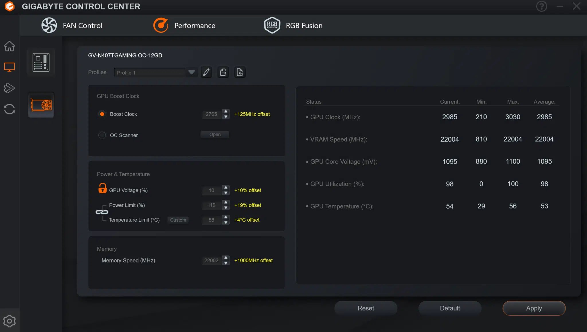

In overclocking our GIGABYTE RTX 4070 Ti GAMING OC we enlisted the GIGABYTE Control Center software.  The software is a somewhat bulky download that allows a number of functions directed by a home page.  The Control Center allows manipulation of RGB Fusion, motherboard overclocking, fan speeds, as well as graphics card fans and performance.  There is also an update function for all the GIGABYTE branded hardware you might have.  This was fairly simple to use but a fairly large download.  If you have a number of GIGABYTE items, this is handy.  If all you have is a video card, not so much, but you can’t control your RGBs without it.  This seems to be a common practice with manufacturers at this point.
GIGABYTE GeForce RTX 4070 TI GAMING OC: Gigabyte Control Center screenshot
The only part of the GPU “Performance” interface we didn’t like was there is no manual GPU clock frequency adjustment.  To up the clock one must adjust the “Boost” clock tab.  A small number shows up beside the tab which took me a while to figure out represented the GPU clock frequency increase.  Well then, today I learned something. The overclock allowed an increase of 125MHz GPU clock and 1000MHz on the memory side.  This was accomplished by increasing the voltage slightly, the power slider to 119%, and the temperature slider to 88C.  We were able to run the video card at +150MHz and obtain a consistent 3030MHz overclock on the Boost, but the card was not stable in F1 2022.  So we traded down to +125MHz and everyone was happy.  Screen capture is shown above.
