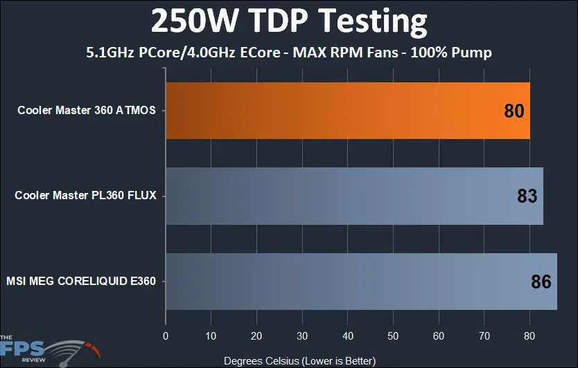

Max Fans – 100% Pump Speed
Cooler Master MASTERLIQUID 360 ATMOS 250w load thermal results at max rpm fans
Bumping up to a higher level of heat at 250W and fans blasting finds the Cooler Master MASTERLIQUID 360 ATMOS at 80 degrees Celsius which is 3 and 6 degrees cooler than the PL360 FLUX and CORELIQUID E360 respectively.
Note that at this speed, the Cooler Master MASTERLIQUID 360 ATMOS is running its fans at 2500 RPM, the PL360 FLUX at around 2300 RPM, and the CORELIQUID E360 at around 1800 RPM.

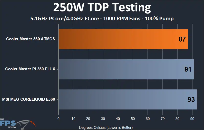

1000 RPM Fans – 100% Pump Speed
Cooler Master MASTERLIQUID 360 ATMOS 250w load thermal results at 1000 rpm fans
At the 1000 RPM level, the Cooler Master MASTERLIQUID 360 ATMOS toasted itself up to 87 degrees Celsius while the CORELIQUID E360 and PL360 FLUX went to 93 and 91 degrees Celsius respectively.
