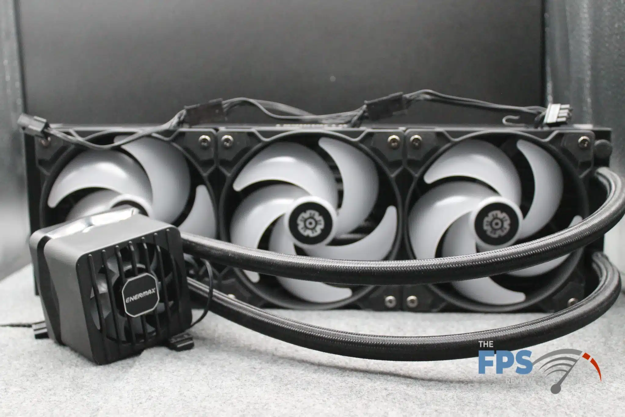

Enermax LIQMAXFLO 360mm fully assembled

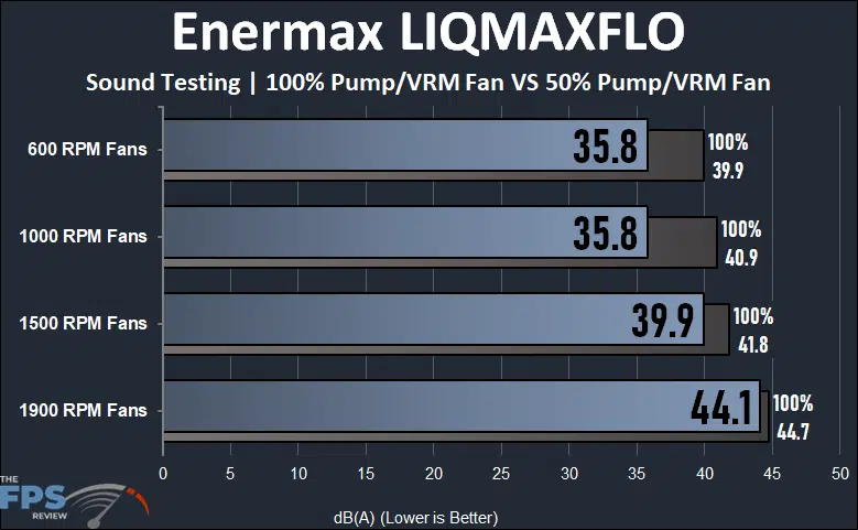

Enermax LIQMAXFLO 360mm sound testing for 100% vs 50% pump/vrm fan speed
Taking a look at the sound front, at the highest RPM speeds, we saw little to no difference in the dB(A) readings. At the 1900 RPM fan speed level, there was no subjective difference between the pump speeds, however, when dropping to 1500 RPM and below, the Enermax LIQMAXFLO 360mm became virtually inaudible.

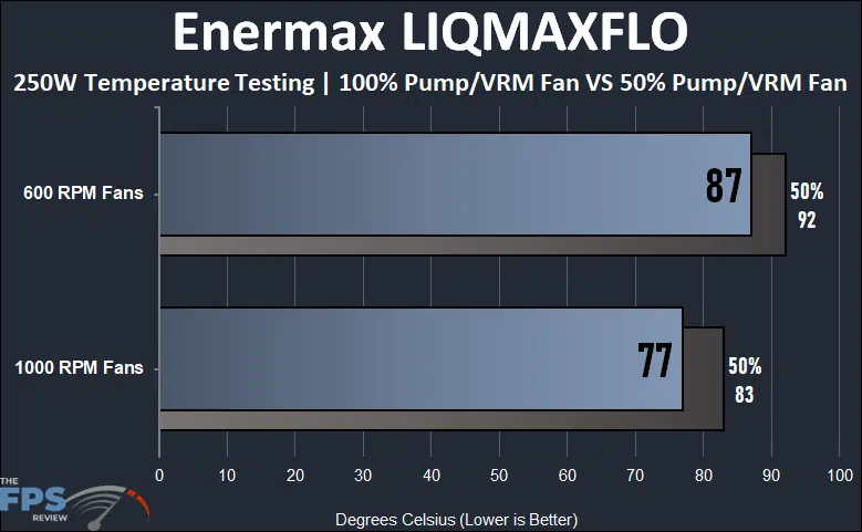

Enermax LIQMAXFLO 360mm thermal testing for 100% vs 50% pump/vrm fan speed
As the higher fan speeds don’t make much of a sound difference, we decided to focus on the cooling performance difference at the quietest end at the 600 and 1000 RPM levels to see the trade-off for backing off on the vrm/pump speeds. Overall, we saw a 5-6 degree Celsius increase in CPU temperature in exchange for the loss of fan noise.
